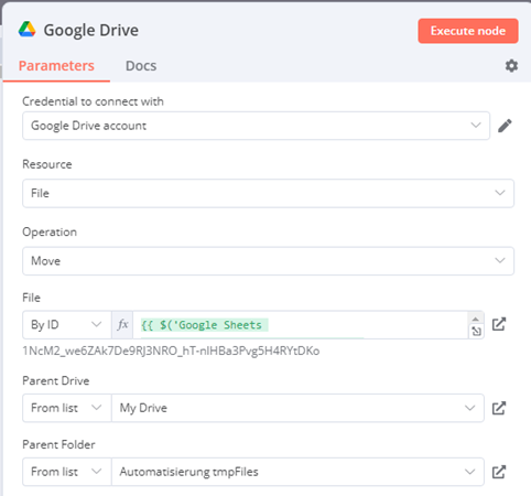

In the workflow node everything looks fine but the node produces an error:

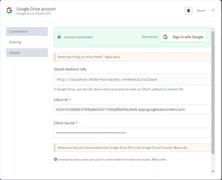

The credentials look good, status “Account connected”:

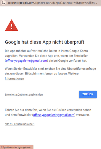

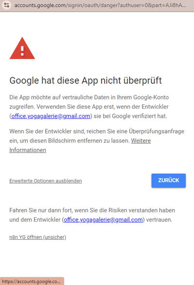

But the account is not connected and I need to reconnect. Doing so I receive a message that the app is not verified (probably this is the problem):
When I reconnect then everything is working fine. But my workflow that shall run automatically on a monthly basis does only work with manual intervention.

Hey @pghahrem
How did you configure your Google OAuth Consent Screen?
If you haven’t published your App, Google terminates the Authorization after 7 days.
Hi ria,
I made a verification request for the OAuth Consent Screen at Google. They asked me for:
• The justification you provided in your Cloud Console submission does not sufficiently explain why the requested OAuth scopes are necessary.
→ when I told them I am using the app only within my company they said I don’t need verification
• We are unable to log in and test your application.
→ they have not access to n8n. How shall they test the app?
So I am not coming forward with this.
br,
Patrick
Any ideas how this can be solved? Guess I am not the only one using Google nodes in n8n.
Hey @pghahrem,
I have mine set to the below and it works for me, Are you able to do to the same thing or does Google prompt you for more info?
Hi Jon, I made now the same settings. Let’s see whether for the next scheduled run it will work. Thanks for the information provided.
