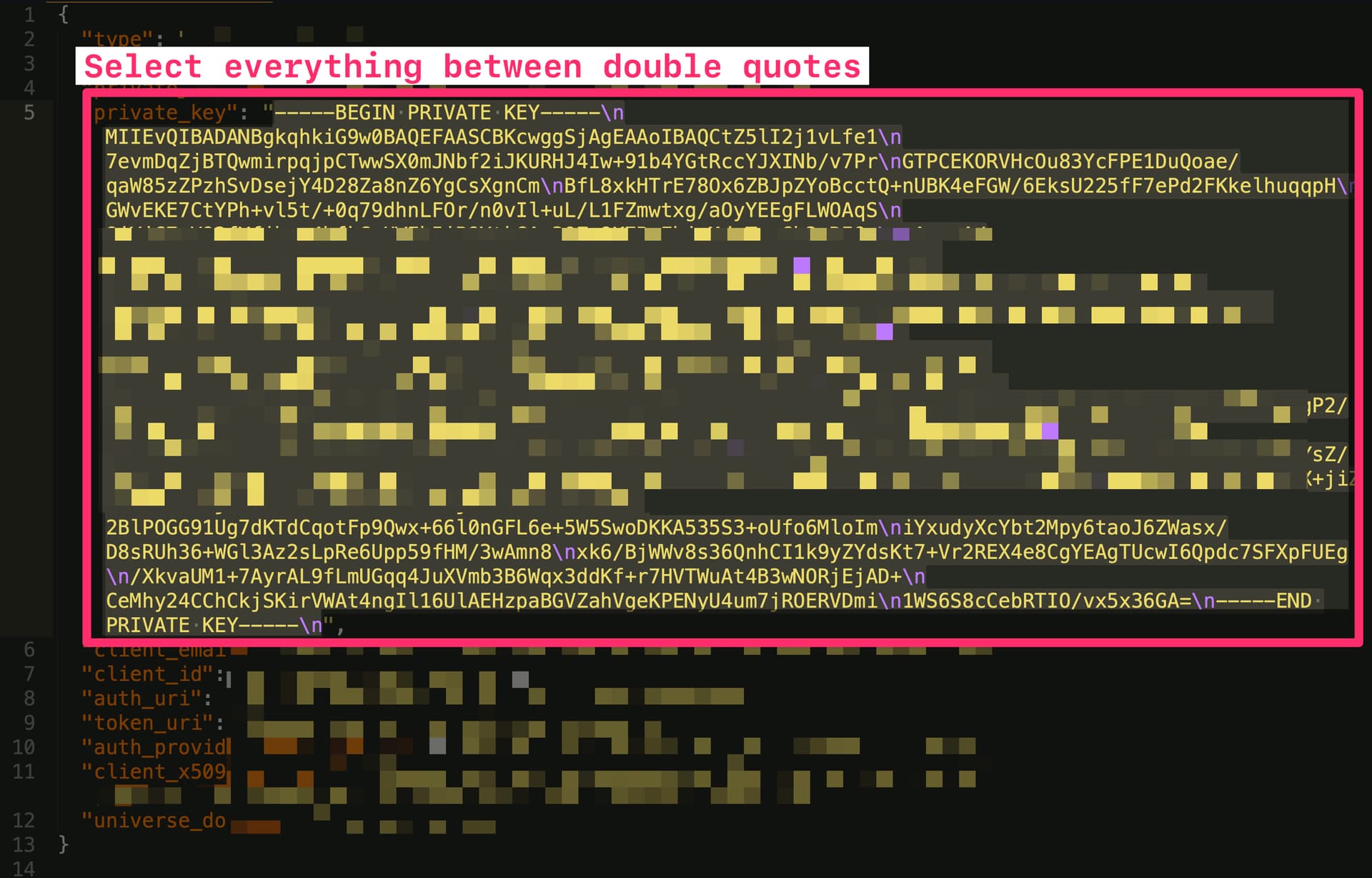

- The private key needs to have all the
\n characters including the one at the end. Copy everything within the quotes.

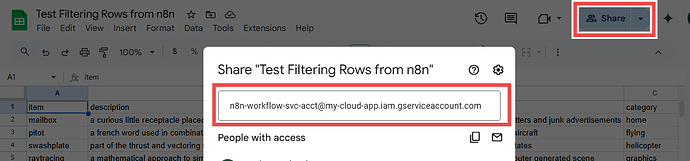

- The email should be the IAM generated email on the service account.
- You will then need to share access to resources (like Google Sheets) with the service account email before you can use the corresponding node in n8n to access those resources.

The error you get is paste the wrong key
Hope this image explains well on what you need to copy as key.
