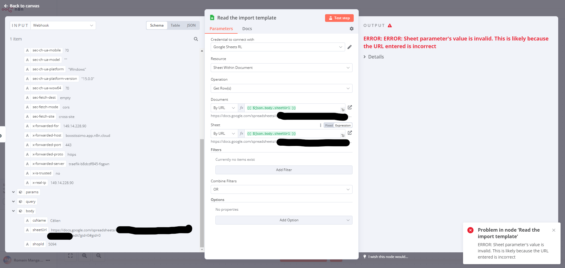

I use the sheet URL to identify which google sheet I want to get. However, each time I try to get the sheet, i have the following message : “ERROR: ERROR: Sheet parameter’s value is invalid. This is likely because the URL entered is incorrect”
Strange part is, when I click on the open the sheet button on the right side of the field, I get to the desired sheet without any problem

I sadly cannot share the workflow as I have a lot of sensible information in it. However, here is the problematic node :

So here again is my problem. I am trying to fetch a particular sheet on a google sheet.
I have the URL as my main key. However, each time I try to input the Sheet URL, N8N tells me that it is not a valid Sheet URL.

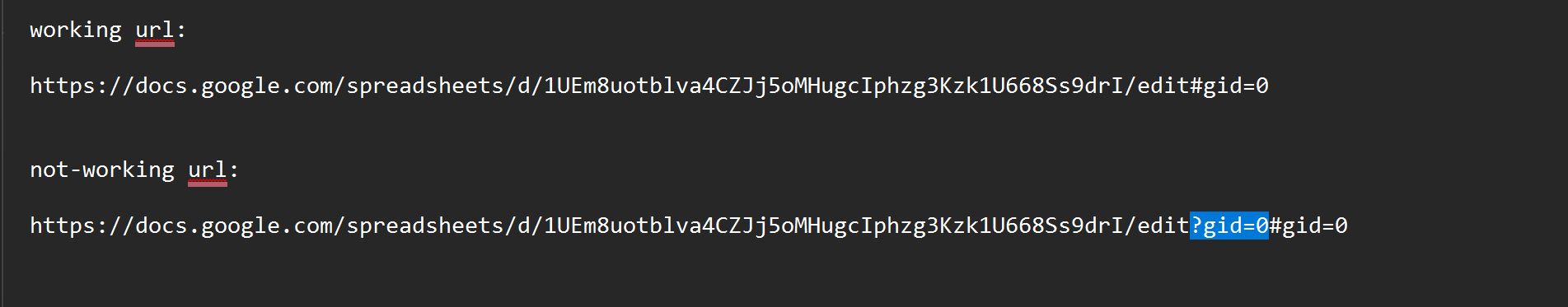

Here is an example of a google sheet (this a random sheet) : Example URL - Google Sheets
Here is the error node

The error you’re seeing can be overcome by editing the url slightly, as in this example:
If you remove the search query n8n is once again able to find the requested sheet.
Another workaround is to first select the sheet From List and after changing the selection to By URL. The node will automatically pick up on the sheet’s url and do the editing for you.
