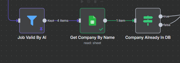

When using a Google Sheet get row node, I am giving it 4 items at input, and it’s only spitting out a single output.
I don’t understand why it wouldn’t just work on all 4 and output 4 results.
PARTIAL workflow:
See how 4 items in and 1 item out

it is NOT running once per item. The toggle is set correctly.
Also notice that toggle means to stop at the first ROW FROM THE SHEET that is found.
What I want is for it to run FOR EACH N8N ITEM. these are different concepts.

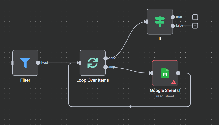

My idea was to put a Loop node inside the flow immediately after the Google Sheet node.
In this way you should have the possibility to take all the rows you want from the google sheet and, once collected, proceed.
The image is just an example because not knowing the whole workflow could be wrong. Give it a try.
Here n8n document about loop
Let me know :v:
