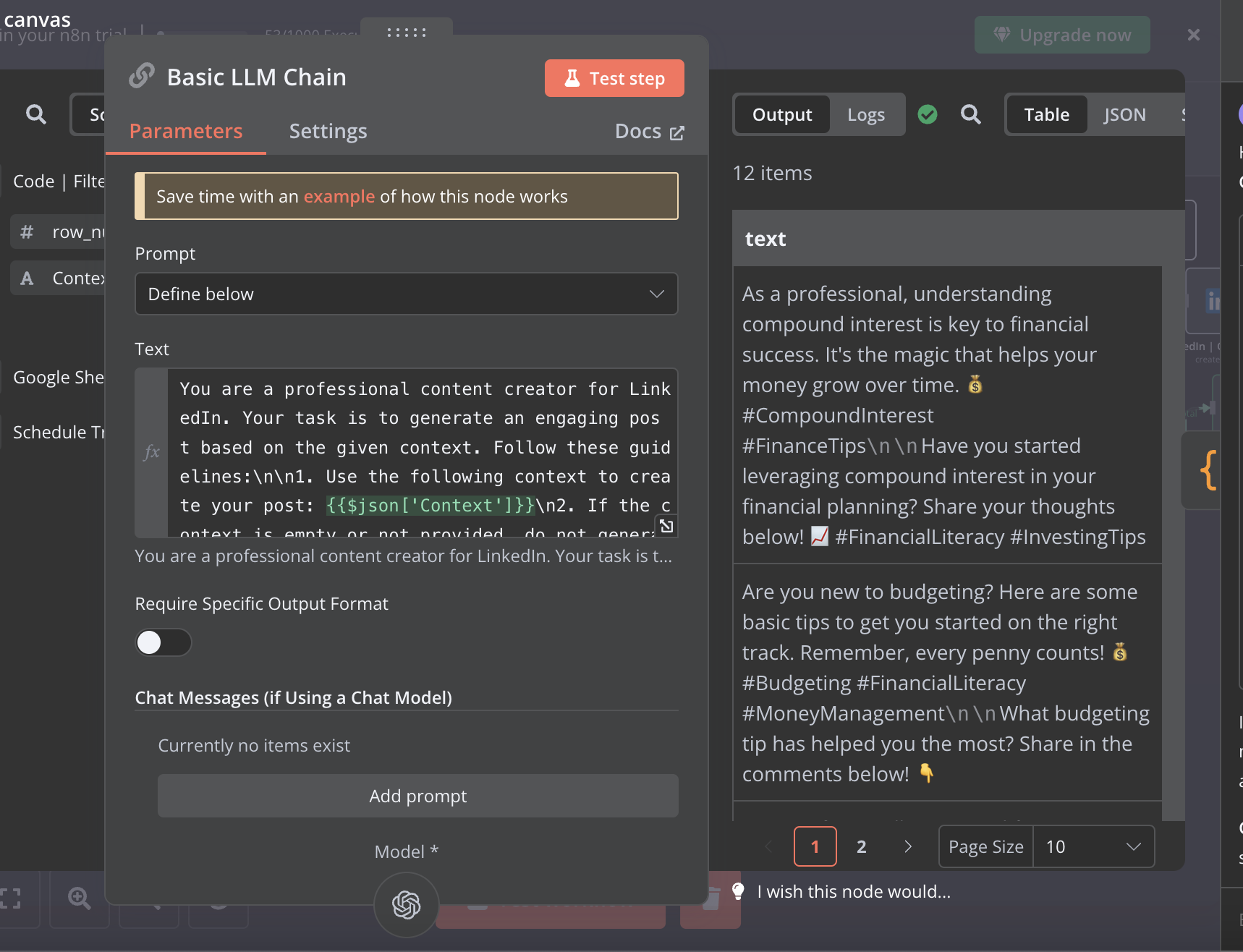

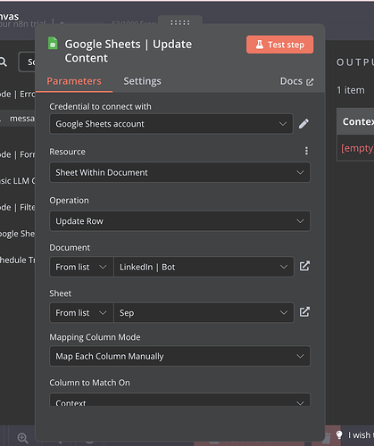

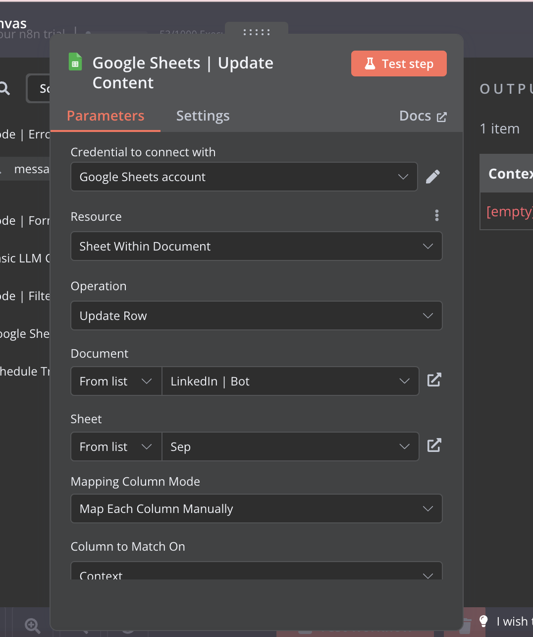

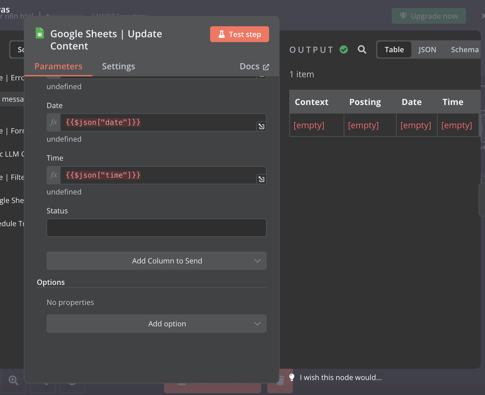

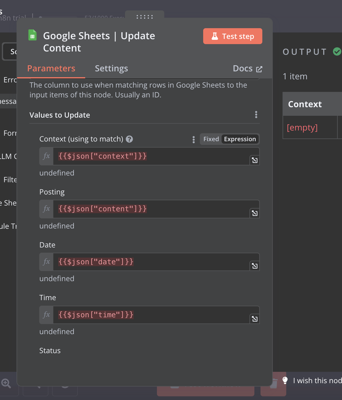

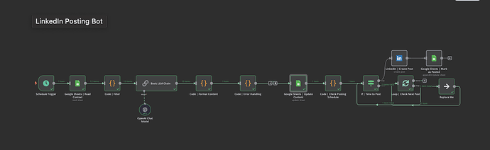

ive been trying to update the “Posting” column in your Google Sheet with the AI-generated content based on the “Context” column. The workflow is functioning, but the sheet isn’t being updated.
see attached screenshots for reference. sigh pie

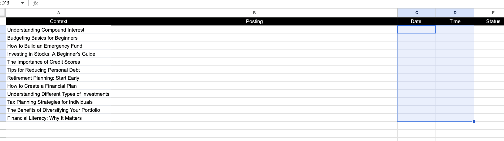

this is the google sheet
@rebbitkar , your screenhot demonstrates that the referenced properties are likely not correct as the actual values are shown as “undefined”.
Since you are using {{ $json... }} you are trying to pick the values from the immediately preceding node “Code | Error Handling”. Is that the correct node as a source of the data? If so, what is its output?
