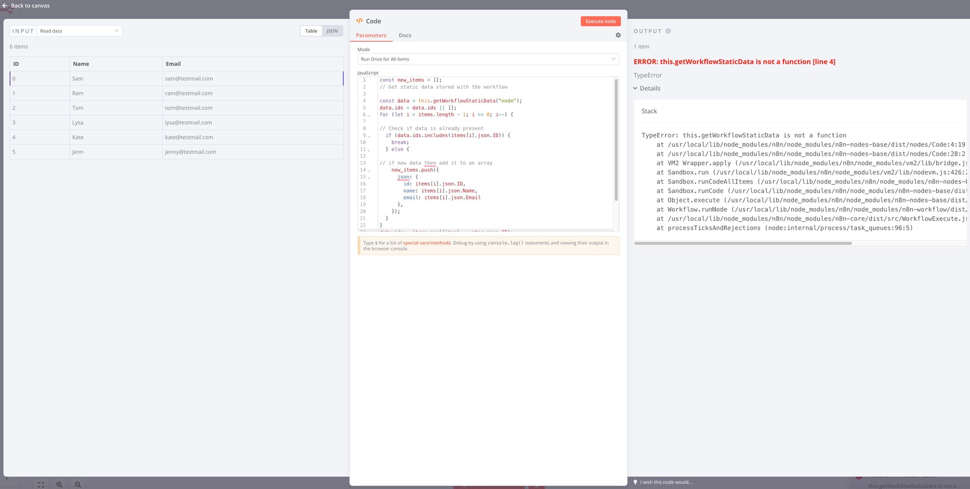

I have created same way the Excel Sheet and filter that with JS Code according to the blog post. But it showing error.
One thing i need to add. This is only happening when i paste the code in new code block.if i use the old function block its working.
