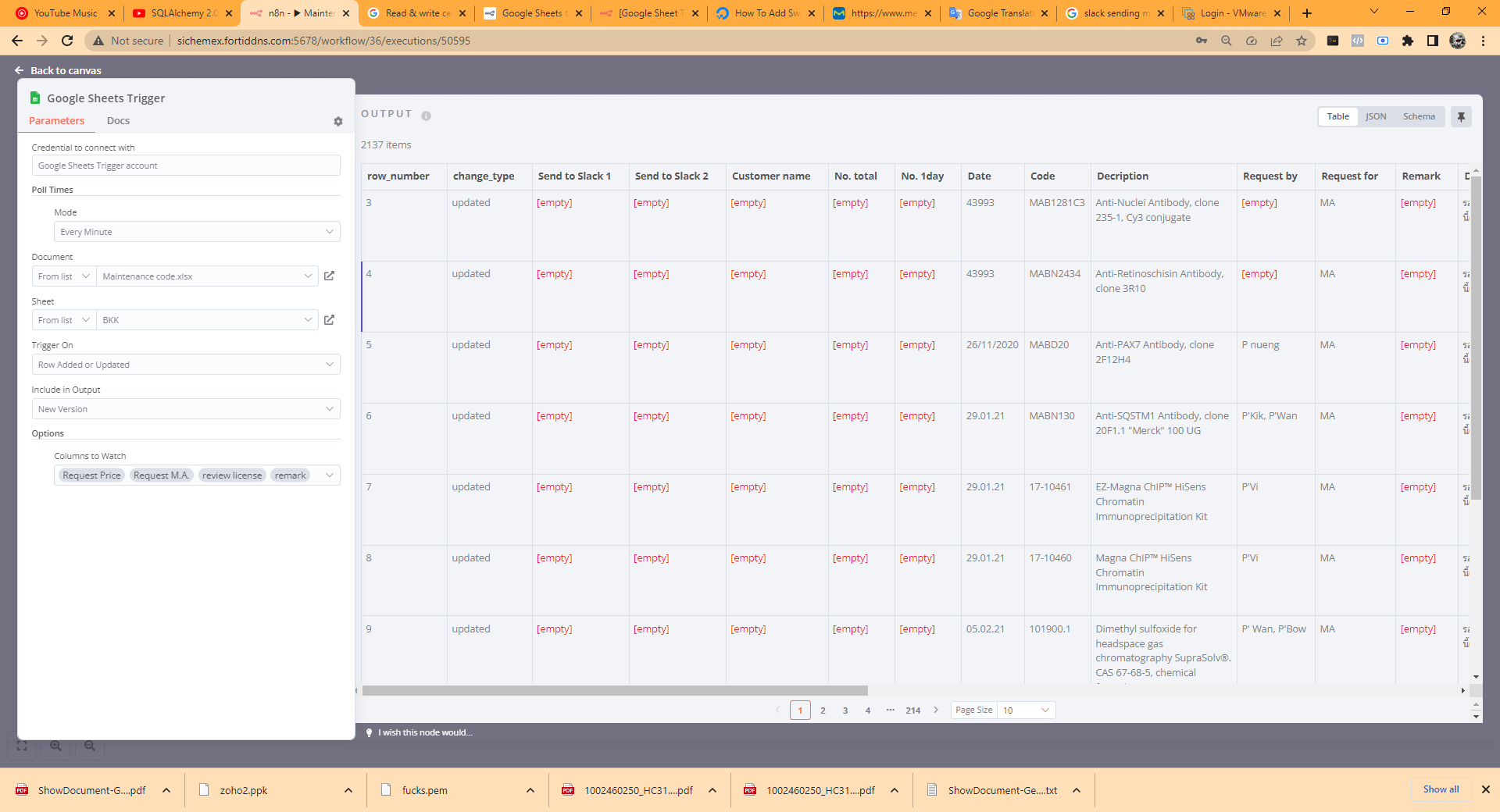

[Google Sheet Trigger] Gets 400+ data rows when theres only one new or updated row
Firstly I am super glad that the Google sheets trigger node came out! now I dont need zapier anymore and can save about $1000 every year!
Problem is that I am having trouble with both checking for updates and new rows, everytime the workflow runs its pulls like 400+ rows that are not new? also there are some running numbers and formulas that are pre populated and it seems that its pulling those too?

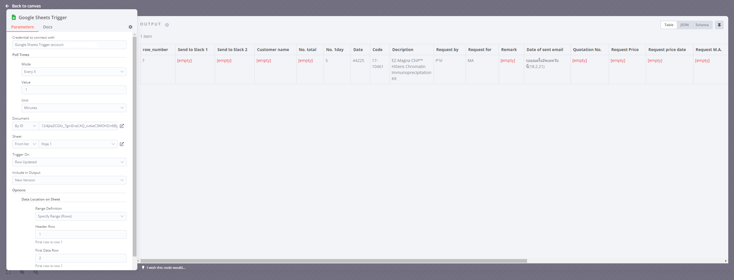

Also the select data range is pretty handy but it would be nice if we could specify the columns manually or specify which row is the header row and which are the data row. - Im a DUMBASS just found that u can do this as manual range!

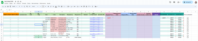

Heres an link to an example sheet
Gets like 400+ data rows when theres only one new or updated row

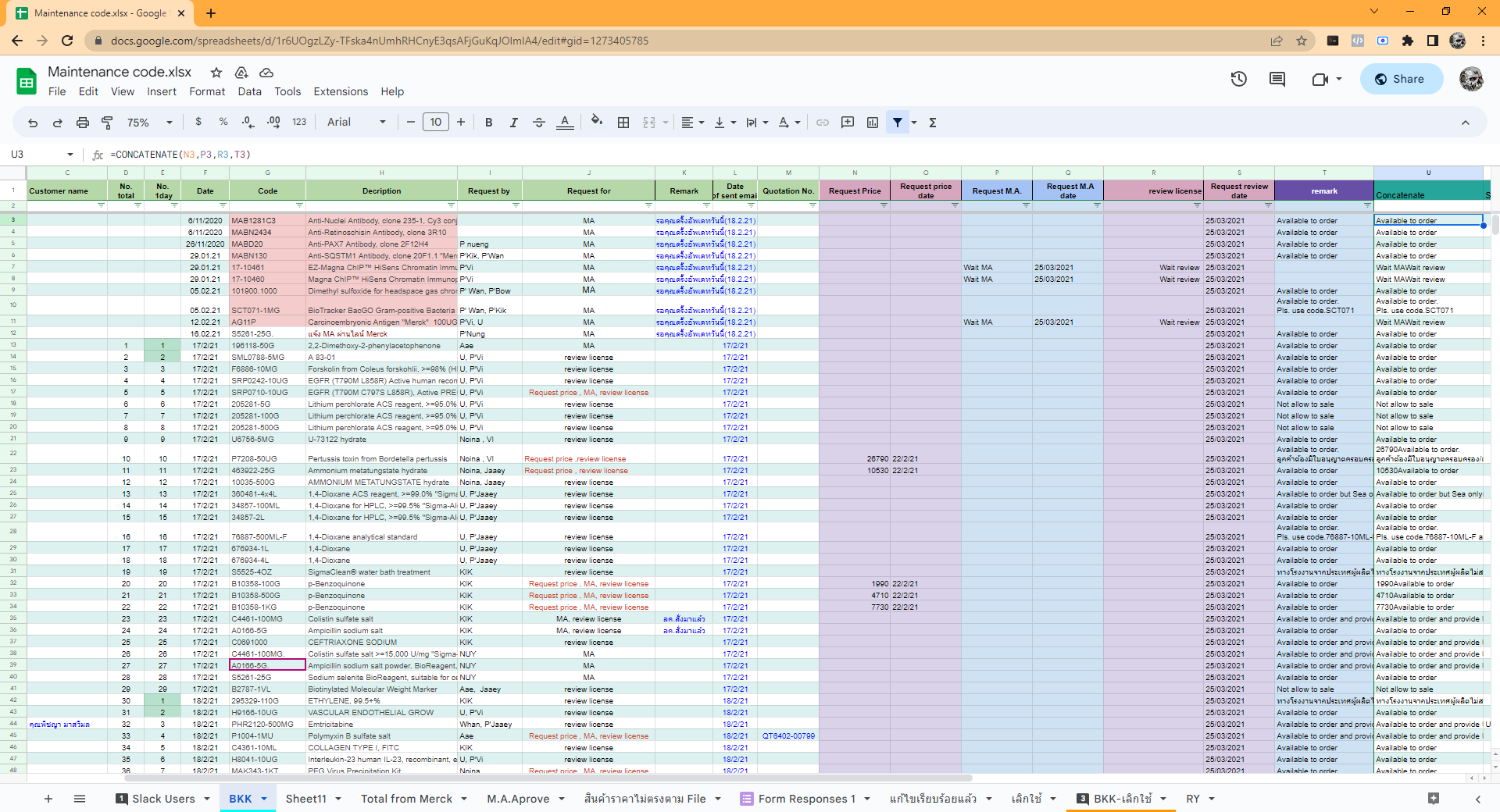

The Column being watched is concatenating important columns that when updated need to trigger the workflow.
the columns being watched are being imported from another spreadsheet using import range function.
The other spreadsheet is updated and the changes are brought to the working spread sheet, when something is changed the entire sheet or 332 items are being pulled into the trigger.
WHY?
I have a theory that when the import range function is used it refreshes the entire dataset and then concatenate has to do it again and therefore n8n picks up the whole column or 300+ rows as UPDATED

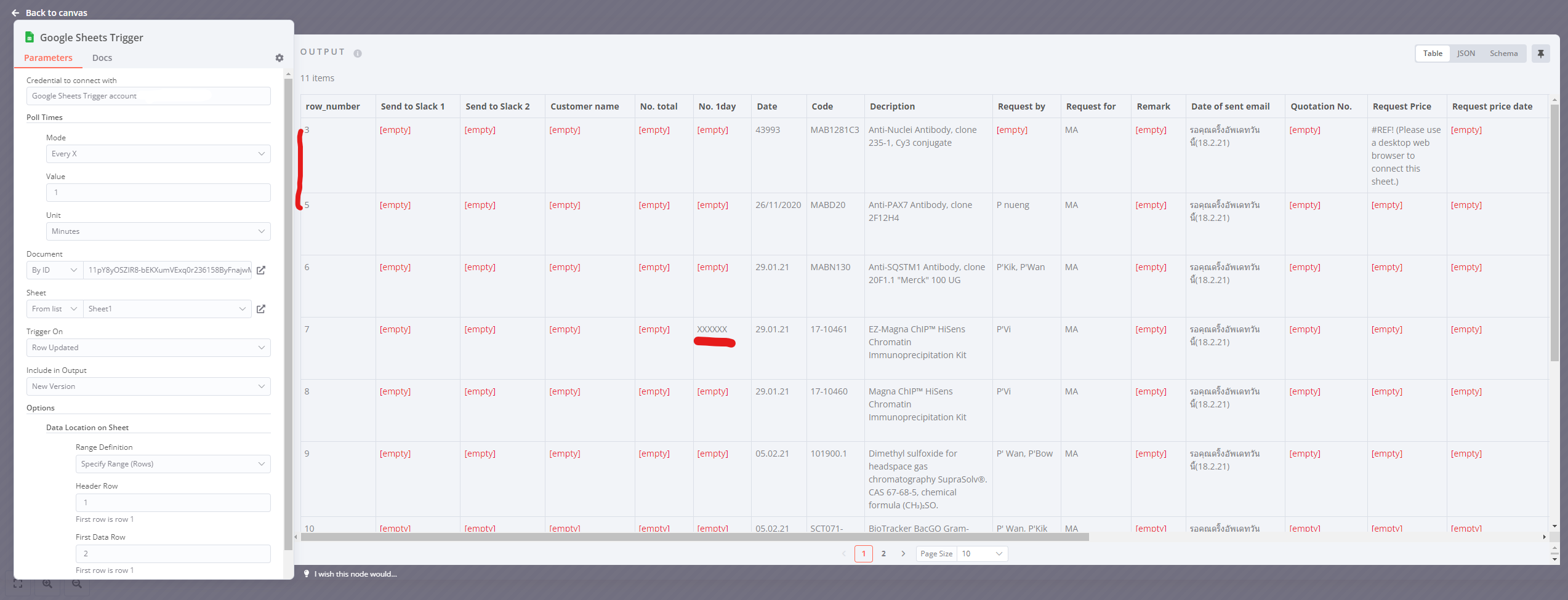

Hi thans martin, This is the output when triggered by updating a single row, do u mind to send me ur email address and i can share the real sheets with u??

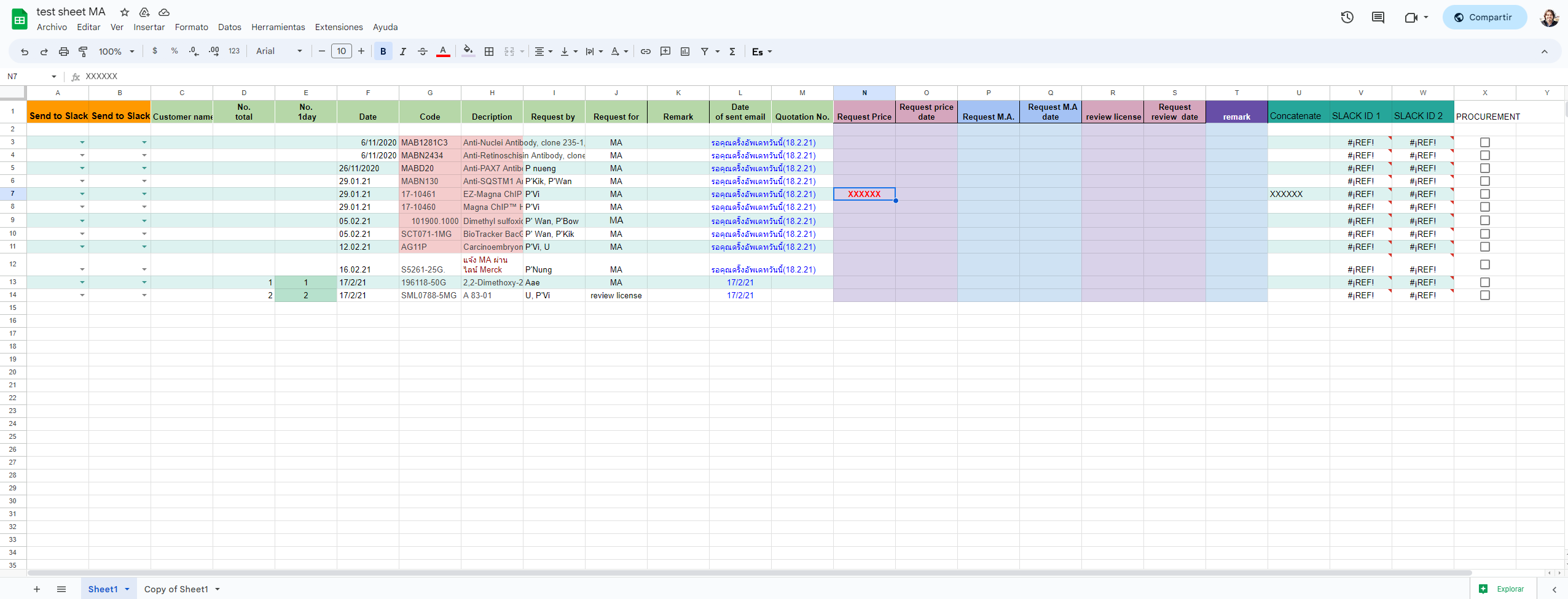

@Josh-Ghazi I just tested on the sheet you shared, and indeed, even if only cell E7 (for example) is modified, the node returns all rows.
Looking at the rest of the columns, I have seen that columns U, V and W have formulas to concatenate values. By removing them from row 4, and changing cell E7 again, the node returns all rows except row 4.
So yes, by changing a single cell, the formulas in columns U, V and W are updated in background for all rows, hence they all appear.

Yes @Josh-Ghazi , a quick and easy alternative is to create a second sheet in the document (Copy of Sheet1 in the example) and do an IMPORTRANGE of the first one inserting only the range of columns A:T, and add in this second sheet of the document the columns U:X containing the concatenate formulas.
In this way, the Workflow will only receive the modified rows, and when constructing the slack messages, you only have to take the data from the columns U:W of the second sheet.
You have the construction in the example sheet that you have shared.

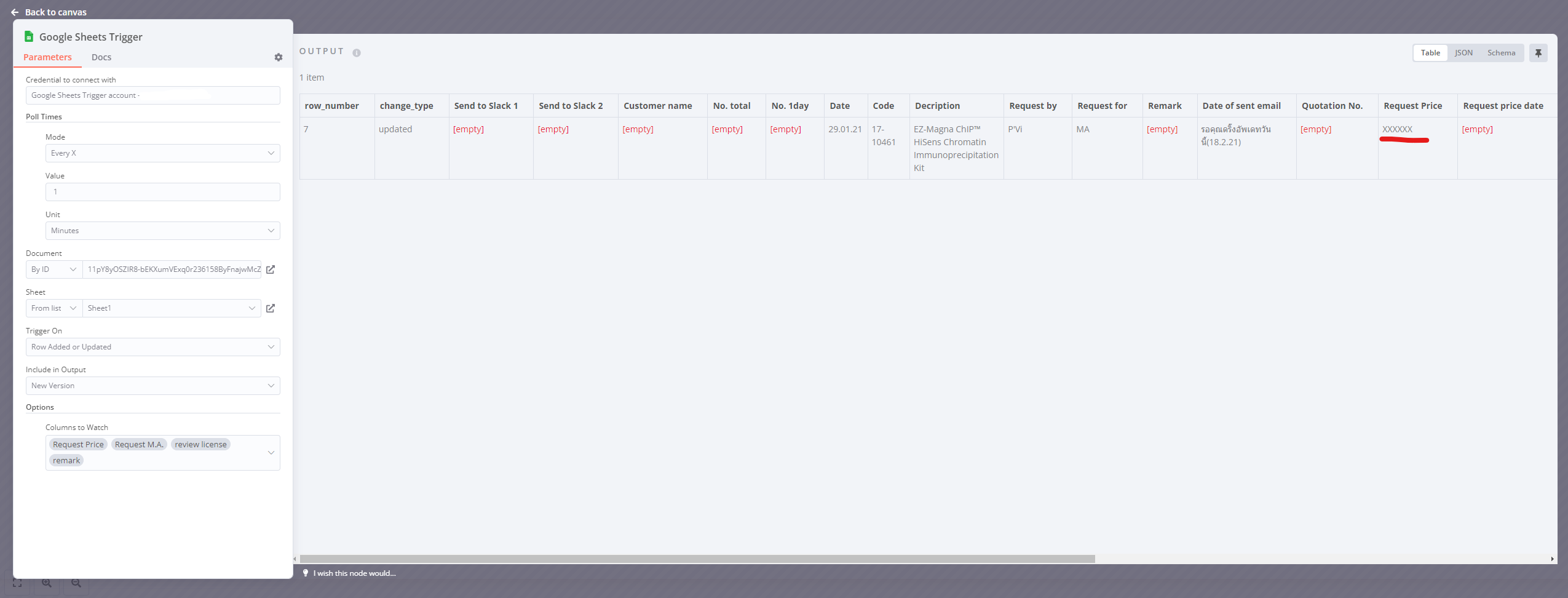

I just ran the check with the same node configuration you show and the result is correct.
The node only returns the modified row (row 7 in the example), when cell N7 is modified, which is inside one of the four columns that the node has to check if it has changed.
Therefore, if in the spreadsheet you have shared the workflow works correctly, you are probably not taking into account any difference in the original spreadsheet.
I see the problem must stem from the spreadsheet using importrange() from another spreadsheet to populate that data and it will update all in that range causing all updated rows, So my solution at the moment is probably to have another column to copy the concatenate column and run another workflow to read this spreadsheet and check the differences between the two columns and update the row that has a difference.
That way this workflow doesnt need to depend on the importrange or concatenate columns and the column to watch has no formula and doesn’t change unless the other workflow changes it.
