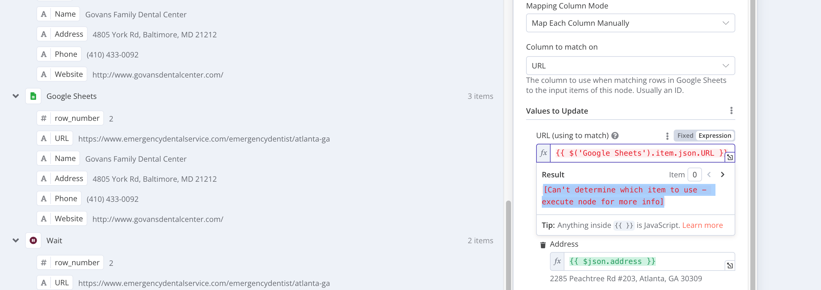

I’m new to n8n and have just created my first workflow. I’m in the final node where I need to add the scraped data to the spreadsheet but I’m getting an error with update a row node. Error is [Can’t determine which item to use - execute node for more info]
Is this a bug? I only dragged it from Google sheets URL
If I try replacing the JSON with actual URL then it’s working.

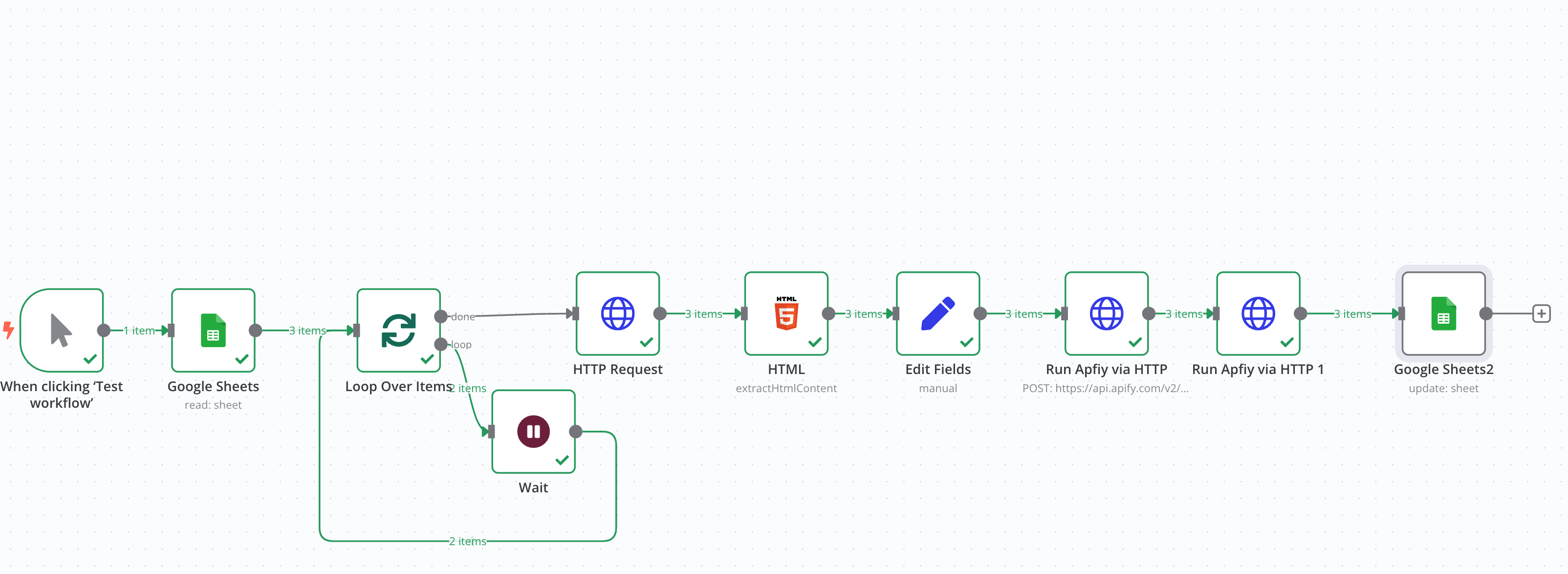

Here is screenshot of my entire workflow:

You loop node is doing nothing the way it’s set up now. Try removing it and connecting Google Sheets directly to HTTP Request node. See if that works.
Another issue could be the Edit Fields node. If you don’t pass the previous data to the next node, you could loose reference to the items.
