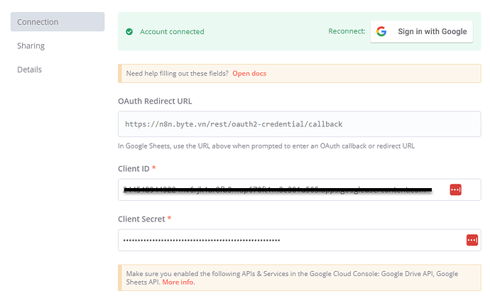

Google sheets, list of documents does not appear
From n8n, I have established a connection with Google Sheets successful. However, when choosing the sheet to work with from ‘From List,’ an error message appeared: ‘Could not load list. Please add your credentials.’
Also when I create a sheet using the same credential with the node Google Sheets/Create a sheet, it works perfectly.
Do you see the problem? Thank you for your help.

Hey @Minh,
Welcome to the community :raised_hands:
Normally if nothing shows in the list it means that the Google API project doesn’t have Google Drive enabled as well, can you double check the enabled APIs on the Google side?
Hey Jon,
Magic, it works! Thank you very much.
I am new with n8n. Very happy with your fast reply.
