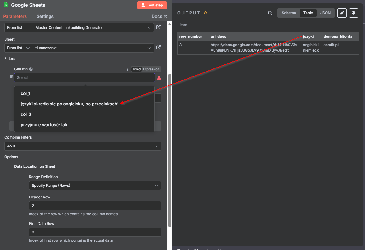

Google Sheets node doesn't use Data Location on Sheets in Filters
Google Sheets node reads first row as a headers in filters without using option Data Location on Sheet.
That’s creating a problem that i don’t know which column I need to use and workflow will stop working when I’ll change text in first row.
I need first row to set an instructions to how to use sheets (people doesn’t read comments..)
Sheets →
Node →
As you can see filter doesn’t using data location on sheets to update it’s propostions.
  • n8n version: 1.91.3
  • n8n EXECUTIONS_PROCESS setting: default
  • Running n8n via: docker
Hey @rafuru hope all is good.
The filter indeed does not account for the set data location, feel free to file a bug.
