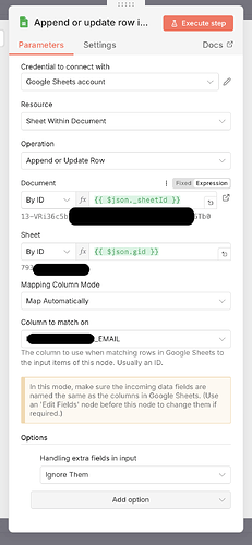

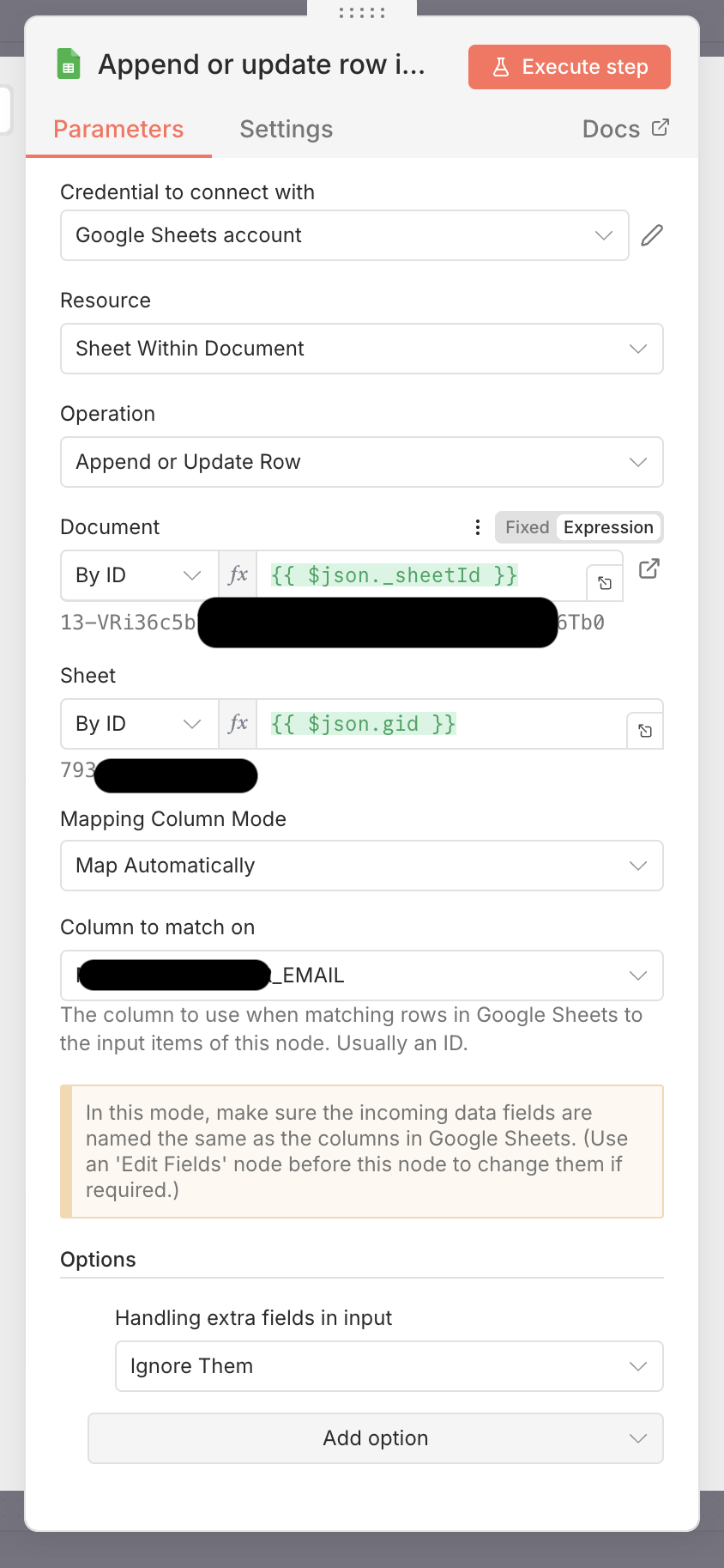

When I set the parameters in the Google sheet node, the data maps automatically to the columns and fills the data on the Google Sheet successfully. BUT after that step is executed the node removes the sheet name and mapping. I then need to enter the sheet name and configuration again. See below for screen shots before and after I execute the step:
Before (all mapping set up and working):

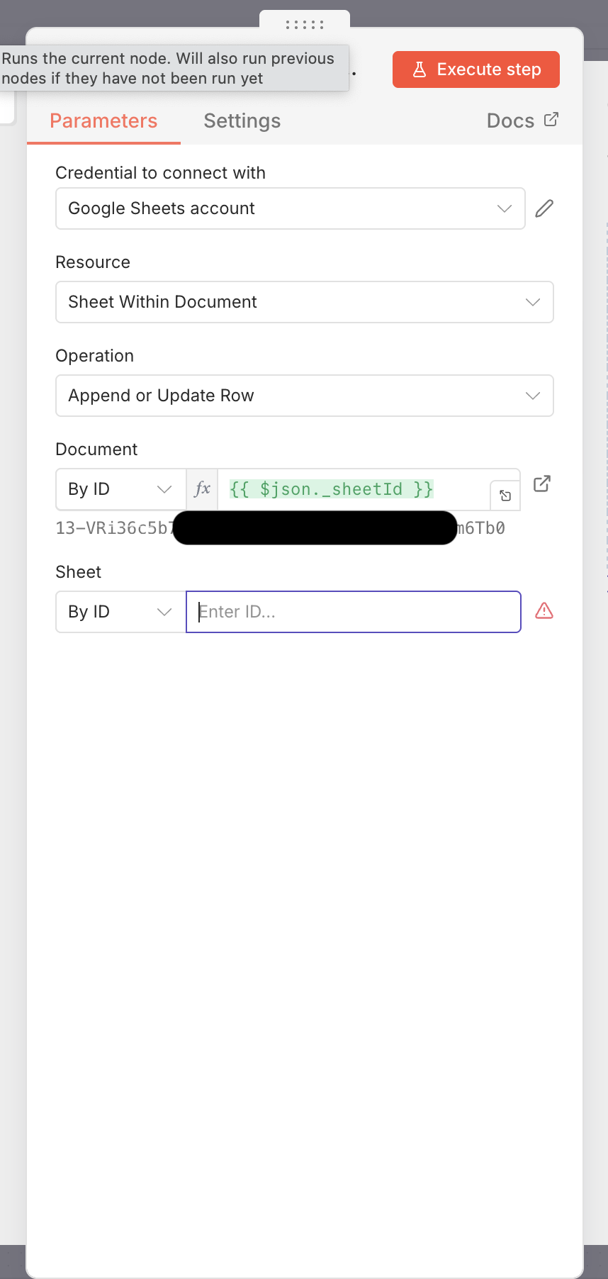

After (Sheet ID deleted, prior sheet mapping no longer saved)
This obviously makes ‘looping’ a challenge, as the parameters in the node need to be reset each time. Is there a setting in this node that keeps a static value for the Sheet ID, knowing that the template values will never be different?
See screen shots above.

The _sheetId and gid are coming from the workflow further upstream, and I can validate that those are correct and working. The issue is what happens after I execute this specific node. Below is the node json for the first time I run it. Note that gid and sheetId are able to locate the file schema and data is loaded to the sheet.
{“parameters”: {“operation”: “append”,“documentId”: {“__rl”: true,“mode”: “id”,“value”: “={{ $json._sheetId }}”},“sheetName”: {“__rl”: true,“value”: “={{ $json.gid }}”,“mode”: “id”},“columns”: {“mappingMode”: “autoMapInputData”,“value”: {},“matchingColumns”: ,“schema”: [{“id”: “MARKET_MANAGER_EMAIL”,“displayName”: “MARKET_MANAGER_EMAIL”,“required”: false,“defaultMatch”: false,“display”: true,“type”: “string”,“canBeUsedToMatch”: true},{“id”: “NAME”,“displayName”: “NAME”,“required”: false,“defaultMatch”: false,“display”: true,“type”: “string”,“canBeUsedToMatch”: true},{“id”: “MANAGER_EMAIL”,“displayName”: “MANAGER_EMAIL”,“required”: false,“defaultMatch”: false,“display”: true,“type”: “string”,“canBeUsedToMatch”: true},{“id”: “MANAGER_NAME”,“displayName”: “MANAGER_NAME”,“required”: false,“defaultMatch”: false,“display”: true,“type”: “string”,“canBeUsedToMatch”: true},{“id”: “JOB_TITLE”,“displayName”: “JOB_TITLE”,“required”: false,“defaultMatch”: false,“display”: true,“type”: “string”,“canBeUsedToMatch”: true},{“id”: “START_DATE”,“displayName”: “START_DATE”,“required”: false,“defaultMatch”: false,“display”: true,“type”: “string”,“canBeUsedToMatch”: true},{“id”: “COMP_RATE”,“displayName”: “COMP_RATE”,“required”: false,“defaultMatch”: false,“display”: true,“type”: “string”,“canBeUsedToMatch”: true},{“id”: “STATUS”,“displayName”: “STATUS”,“required”: false,“defaultMatch”: false,“display”: true,“type”: “string”,“canBeUsedToMatch”: true}],“attemptToConvertTypes”: false,“convertFieldsToString”: false},“options”: {“handlingExtraData”: “ignoreIt”}},“id”: “c7a469c7-b615-4a1c-87d0-5f51b5001db2”,“name”: “Write Config Data”,“type”: “n8n-nodes-base.googleSheets”,“typeVersion”: 4.7,“position”: [15104,5136],“alwaysOutputData”: true,“executeOnce”: false,“credentials”: {REMOVED}},“onError”: “continueRegularOutput”},
After the execute step is completed, the node reverts back to “null” for the sheetName value. Here is the json directly after the step is executed:
“parameters”: {
“documentId”: {
“__rl”: true,
“mode”: “id”,
“sheetName”: {
“__rl”: true,
“value”: “”,
“mode”: “id”,
“cachedResultName”: “”,
“cachedResultUrl”: “”
“typeVersion”: 4.7,
“position”: [
15104,
5136
“credentials”: {
REMOVED
