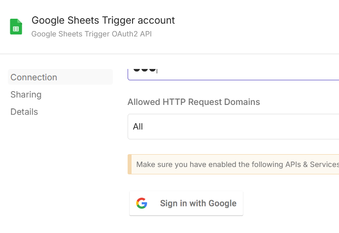

Google Sheets OAuth2 API credential got “Something went wrong"
I’m trying to setup a new credentials with Google OAuth2, each time I tryh to login I got a message “Google Sheets OAuth2 API credential “Something went wrong”

I did… I created a new project and recreated everything from scratch ; same error

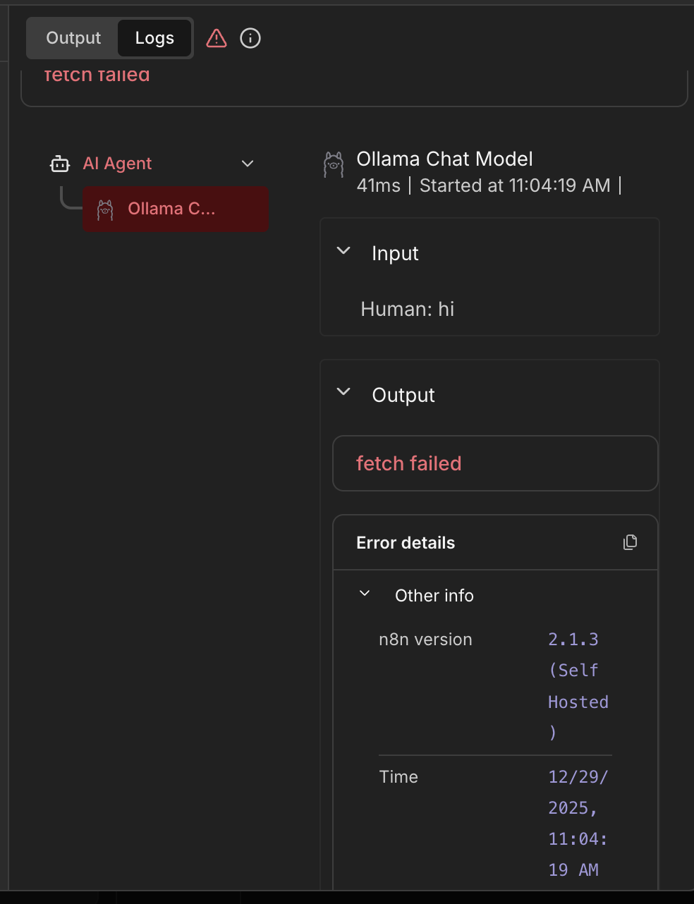

I would try authenticating one more time, and if that still fails maybe switch to a service account. When it errors, there is also a screen in the n8n node called more details, can you paste that in your reply
I got it from another persons post so I removed it.

After many tries I finally find out the root cause. The faulty element is “ClearURLs” add-on with firefox ( ClearURLs ) which basically clean the URL from trackings elements present in the URL
