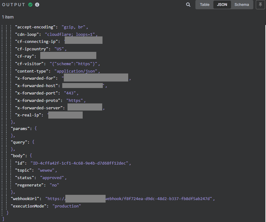

I was unable to recreate the problem and have a couple ideas but given how thorough you seem to be, you’ve probably covered them.
  1. Did you refresh the Sheet in the Google Sheets node after recreating the deleted sheet?
  2. Is it possible that there is hidden text in the ID column? I’ve seen others encountering this which can result in updating the wrong row (like row 1500!).
  3. My results are in the “body” param, not the 'query" param
  4. Create a minimal workflow that only tries to update a row
Are you self-hosting?

Hi @andrii_blonskyi ,
I wanna add something to your “What We’ve Tried” list.
Since you say that everything was working until:
Are you sure your Google Apps Script is linked to the new Google Sheet you rebuilt?!

When the script runs inside onEditTrigger() (installed trigger), the UrlFetchApp.fetch() returns a 404
BUT:
The exact same webhook works fine via Postman
It even works from within the script editor (manually run)
Data is logged correctly, and everything looks clean

Even though data is definitely flowing, and all values (ID, topic, caption, status) are clearly visible in the input before the Sheets node…
:right_arrow: the Google Sheets node still outputs {}
…no row is updated.

Everything executes without error, but the id is consistently undefined across multiple steps, starting from Combine All.
As a result:
:white_check_mark: Flow completes
:prohibited: Google Sheet does not update, even though:
  • Column to match on is set to ID
  • JSON payload seems correct
  • status and caption are passed and logged correctly
  • All debug nodes show working chain — except id
We’ve triple-checked:
  • Incoming query param parsing
  • Webhook setup (production & test modes)
  • Data propagation through Set, Combine, and Prepare Row
  • Variable references like payload.id, item.json.id, $json.id
Yet the id stays "undefined" throughout.
