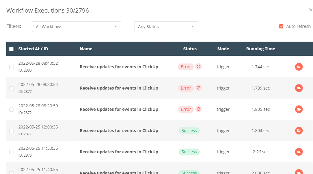

Something is really wrong with the spreadsheet creds. It worked fine before, but now i got the same error again.
And the current error is
{“message”:“400 - {“error”:“invalid_grant”,“error_description”:“Invalid JWT: Token must be a short-lived token (60 minutes) and in a reasonable timeframe. Check your iat and exp values in the JWT claim.”}”,“name”:“Error”,“stack”:"Error: Request failed with status code 400\n at createError
And the time result is:
Kinda weird - should be 8:46 (US time), but it shows EU time instead (GMT, i guess?).
