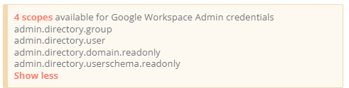

When I create an HTTP REQUEST using the predefined authentication of Google Workspace Admin OAuth2 API, shortly after, a box appears informing me about 4 available scopes.
It turns out that none of the listed scopes is what I need for my action. Even after enabling the scope in my application on Google Cloud, the list doesn’t change, and I can’t complete my request.

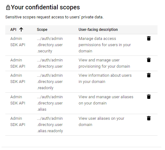

@barn4k thanks for you reply,
If I go to my Google Cloud application, on the OAuth permissions screen, in the scope section, I already have the scope enabled, shouldn’t that be enough for the workflow to work?

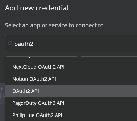

Seems the n8n uses default scopes when connects to the workspace resources.
I’ve found the scope list and there are no user.security scope there - n8n/packages/nodes-base/credentials/GSuiteAdminOAuth2Api.credentials.ts at d9e74949c4db7282c3ab42bd6825aa5acc042400 · n8n-io/n8n · GitHub
So you can use the generic OAuth 2.0 credentials to specify the correct scope there.

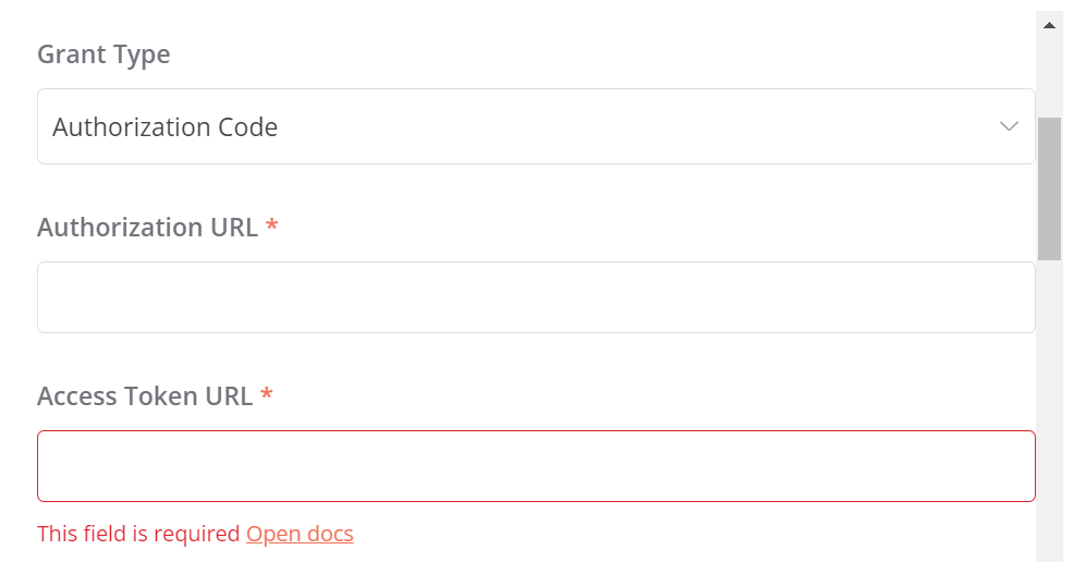

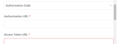

I thought about it, but I couldn’t set it up correctly, so I didn’t test it earlier.

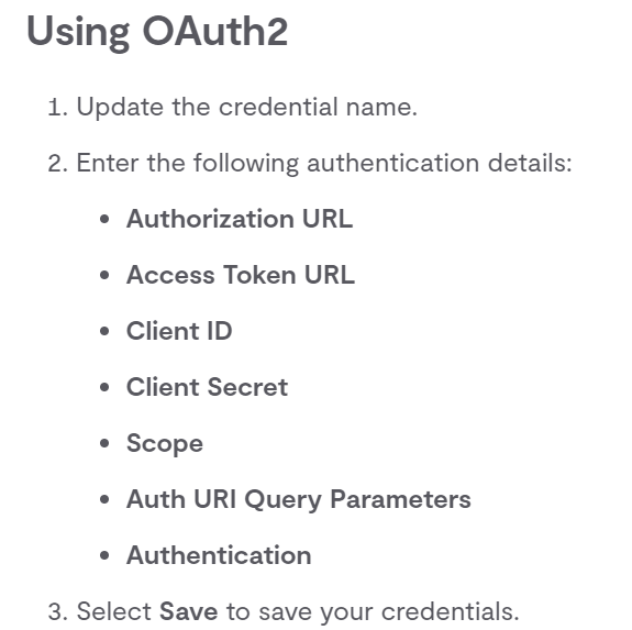

The documentation is not clear, and I would like to ask a silly question, where do I find the authorization URL and access token URL information?
Is the Grant Type correctly?
What the doc says:
Thank you for your time.
barn4k
April 25, 2024, 7:21pm
7
Authorization url should be that one:
https://accounts.google.com/o/oauth2/v2/auth
Access token url:
https://oauth2.googleapis.com/token
Scope:
https://www.googleapis.com/auth/admin.directory.user.security
I’ve found it in the docs
