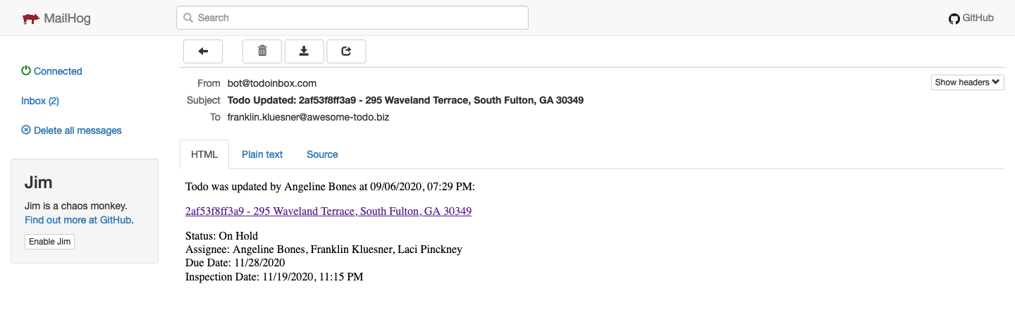

@jan, I think I nearly have this working. But as it iterates through items returned by “Map Assignees” Function node, only values of the first item from the Function node are making it to the email. All items which make it past the IF node do trigger an email to be sent for each item. But only the first email contains values (the others have blank/nil values). Hope that makes sense.
Here’s a gist of the config: https://gist.github.com/cpursley/34c2b678e3726666defb114112de336b
Any suggestions? Thank you.
