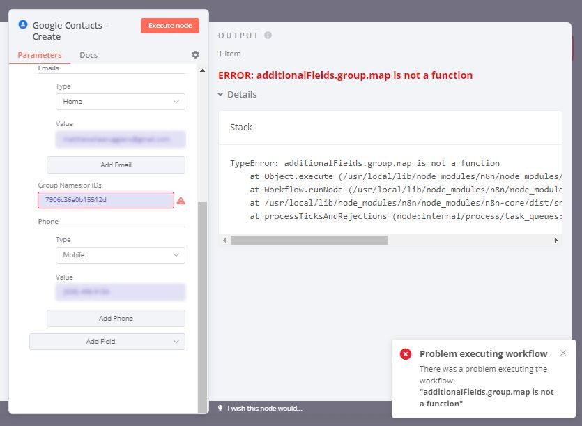

Group ID as Expression Not Working When Creating Google Contact
Google Contacts node doesn’t appear to support the Group ID field as an expression when creating a contact.
Please share the workflow
TypeError: additionalFields.group.map is not a function
    at Object.execute (/usr/local/lib/node_modules/n8n/node_modules/n8n-nodes-base/dist/nodes/Google/Contacts/GoogleContacts.node.js:161:72)
    at Workflow.runNode (/usr/local/lib/node_modules/n8n/node_modules/n8n-workflow/dist/src/Workflow.js:598:51)
    at /usr/local/lib/node_modules/n8n/node_modules/n8n-core/dist/src/WorkflowExecute.js:557:68
    at processTicksAndRejections (node:internal/process/task_queues:96:5)
  • n8n version: 0.190.0
  • Database you’re using (default: SQLite): SQLite
  • Running n8n via [Docker, npm, n8n.cloud, desktop app]: Docker

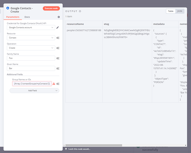

Hi @MortgageRockstar, can you try using an expression such as {{ ["contactGroups/myContacts"] }} like shown below? It seems the node expects an array (and Google Contacts requires the contactGroups/ prefix).
n8n will complain about an unsupported value but the contact was still created as expected for me:
Thank you, @MutedJam .
I formatted an expression per your example and it worked. It does not appear to support the Group name as a string though, only the Group ID as a number.
Is that correct?

Here’s a screenshot of the error when I use a Group Name instead of a Group ID. I would prefer to use a Group Name if possible.

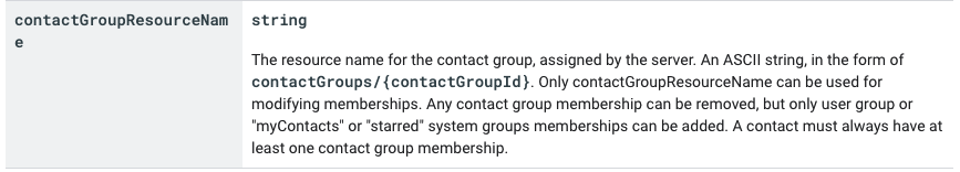

Well that is odd, Let me set up Google Contacts and I will take a look. If it is failing I am not sure how it was previously working unless myContacts is a special group.
Yeah that is it… So myContacts has an ID of myContacts so it looks like it is only the ID you can use rather than the group name.
Thanks for confirming, @Jon.
Is this an issue with the Google Contacts node or does Google’s People API not support Group name to add a contact to a group?
Looks like Google call the field a name but say contactGroupId in the example so it looks to be an API limitation.
