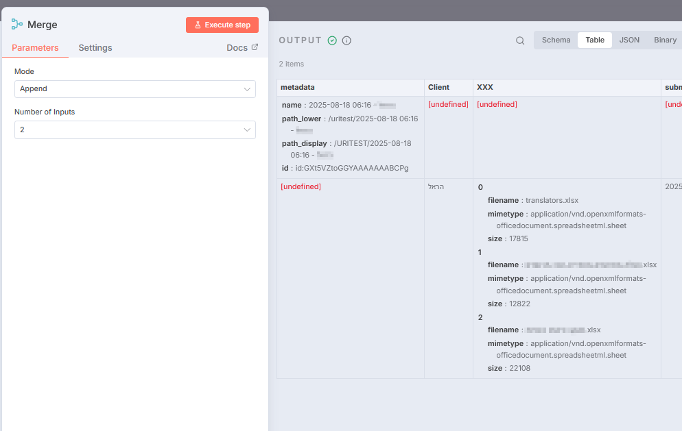

The key to a working solution is to get the folder path and the binary file data onto the same item before you split the files. The Merge node should be used to combine the two data streams before the Split Out node.
Here is our suggested order of operations:
  1. Trigger (On form submission): This is your starting point. It gives you an item that contains a list of all your uploaded files as binary data.
  2. Dropbox (Create a folder): This node successfully creates a folder and outputs a new item that contains information about that folder, including its unique path.
  3. Merge (Append): This is the most crucial step. You need to connect both the On form submission trigger and the Create a folder node to this Merge node.
    • Input 1: Connect the output of the Create a folder node.
    • Input 2: Connect the output of the On form submission node.
    • Mode: Set the mode to Append. This will take the single item from the “Create a folder” node and append the data from the “On form submission” node to it. The result is a single item that contains both the folder’s path and all the binary files.
  4. Split Out: Now you can use the Split Out node correctly. Connect the output of the Merge node to it. This node will take the single item from the Merge and create multiple new items, one for each binary file. Because of the previous Merge step, each of these new items will still have the folder’s path information attached to it.

The Merge node produces 2 items for some reason. Is this correct?

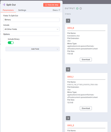

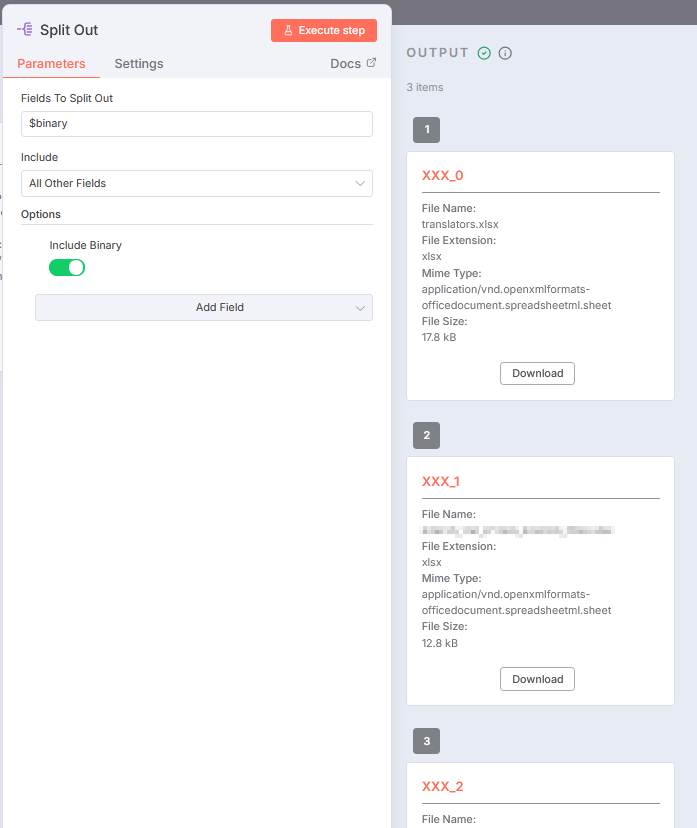

And then in the Split node I’m not sure what field I need to split on. If I do on the binary, I get 3 different items, each with its own binary name, is this correct?
Hi @HvrAdmin
Your screenshots confirm things are working with the Split Out node. Here’s what’s happening and what you should do next:
  • You now have 3 separate items, each with:
    • Its own binary data (.xlsx file)
    • Metadata like file name, size, mime type
  • The split worked as intended.
Each of these items can now be uploaded individually to Dropbox — you’re ready for the final steps.
