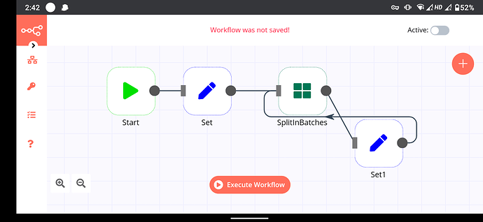

You need to loop it!
Set your Batch Size to 1 will help in your case.
Example:

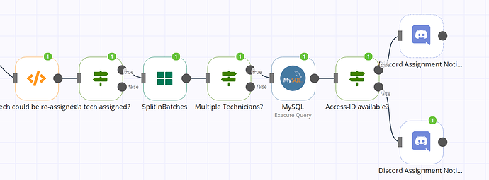

Hmm in my case it does the first one and then cuts off, Which node would i need to connect to make it loop correctly?
Try connecting/looping both discord to split in batch input again.
Make sure you’re setting batch size to 1
Okay, That redid the first one over and over so that didnt work + created a magnificent penis haha
It redid it 8 times while there are 90 inputs

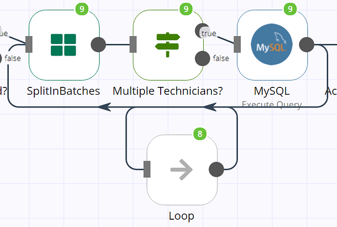

it does loop, But i get the wrong data output so, next thing for me to figure out

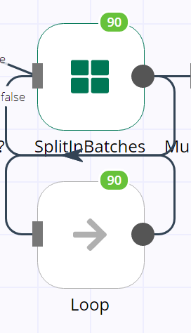

When i get the correct data it only executes 8 times
When i get it to execute the full 90 times i get incorrect data, Head Scratching stuff :face_with_symbols_over_mouth:
So like this i get correct data but as you see it only runs 8 times?
