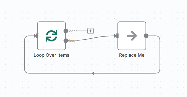

Please remove the “Replace Me” node. I hate it with a passion.
Having to delete 2 things every time you add a loop node is very annoying. (delete the node and the looping arrow/edge)

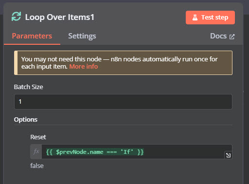

Yea, you need to use this $prevNode and if you change the $prevNode and forget to fix it you wonder why it’s not work :slight_smile: :laughing: Just make the reset easier!

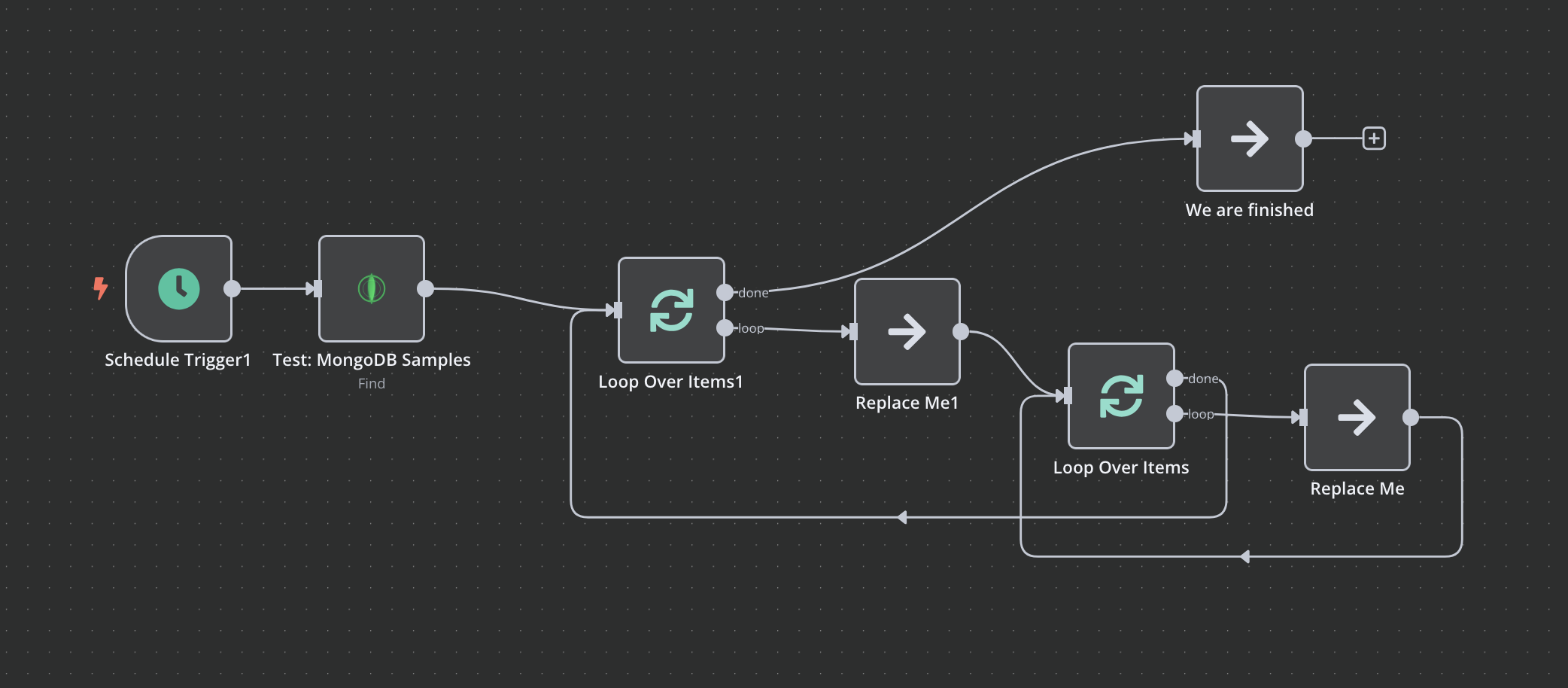

1. Nested Loops
Nested loops send data to the done branch instead of the loop branch. The following workflow illustrates this issue. Both Loop nodes have a batch of 1 in this minimalist example.
I have been using workarounds with sub-workflows and Code nodes.

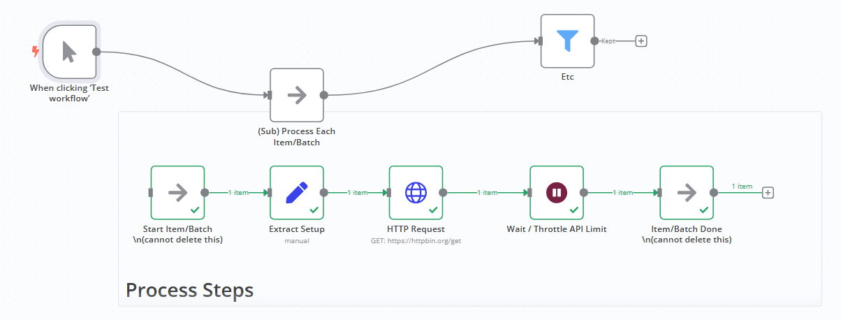

I have wished the UI would leave no option for failing to “close” the loop, and make it clearer that every item going into the loop should go through to the end somehow (since putting an If or a Filter in the middle of a loop seems to be just as troublesome as nesting another loop. Sometimes the solution to that is to pull the the steps in the loop entirely out into a callable sub-workflow, making it a single step, but then tracing through executions becomes more challenging.
From what I can tell, the main reason for using a loop-over-items is to avoid the “process everything right now, in one go” behavior you get from a node, with a list of items.
What if loop-over-items were changed to an in-workflow “batchable” sub-process.
