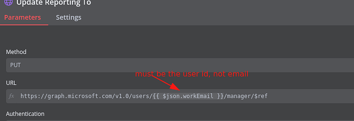

Well, gets a bit tricky. I kinda need help setting up HTTP request node for my problem with manager.
So, what URL do i add? Should I send Headers and Body?

Looking at your update request it looks correct, headers, tokens, endpoints and all, but seems like you don’t have the necessary user ID and manager, user id for the update:
From the microsoft graph api documentation on assigning a manager to the user
id’s look like this: 10f17b99-784c-4526-8747-aec8a3159d6a
PUT https://graph.microsoft.com/v1.0/users/10f17b99-784c-4526-8747-aec8a3159d6a/manager/$ref
Content-type: application/json
  "@odata.id": "https://graph.microsoft.com/v1.0/users/6ea91a8d-e32e-41a1-b7bd-d2d185eed0e0"
To retrieve the user and manager id you will probably need to add 2 Microsoft Entra ID - Get Many Users’ nodes before the update to query by the available emails
  • User ID:
    • Filter: mail eq '{{ $json.workEmail }}' (replace {{ $json.workEmail }} with your email variable).
  • Manager ID:
    • Filter: mail eq '{{ $json.managerEmailFromBambooHR }}' (replace {{ $json.managerEmailFromBambooHR }} with the manager’s email variable from BambooHR)."

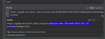

You can dynamically get the values from previous n8n nodes and build strings ‘the n8n way’ like this:
When the referenced node is executed the ids should be resolved and substituted.

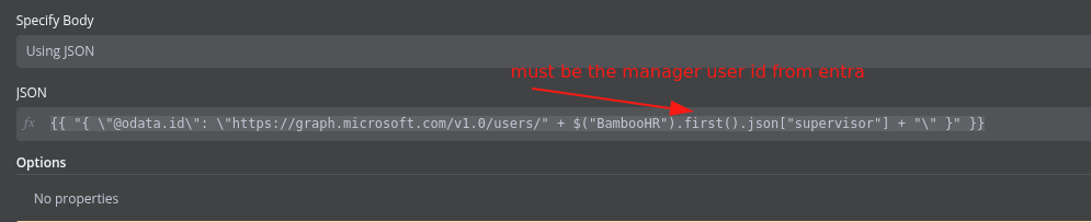

Same for the body JSON:
Here is the updated workflow how i think it should work, but sadly i don’t have bamboo or entra right now so you should double-check the references.

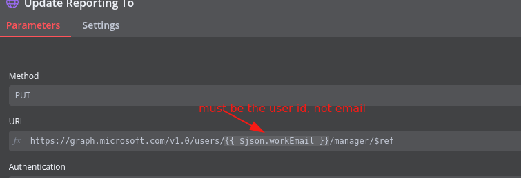

Also noticed that in the update node on the top you are still trying to update by the email of the user.
I moved it after the ‘get entra user’ node and updated the reference because you need an Entra user id to do an update, not an email.
Basically you use the emails to find the ids and then you work with the ids.

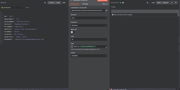

I did like you re-edit the workflow, but i get nothing when i execute node :confused:
Are you sure a user with this email exists in entra? from this screenshot it looks like it just doesn’t find it.
Yes yes, user exists :confused:

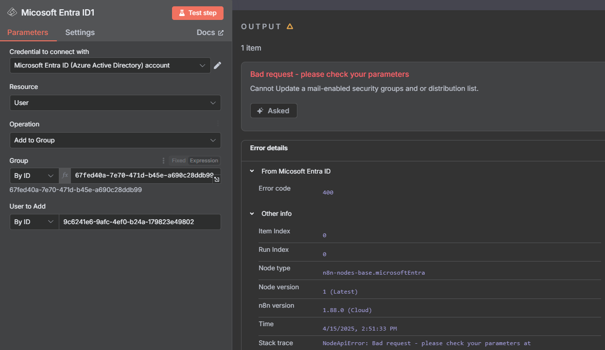

Also, i have another problem when i want to create a user and add them to specific group (I have created a loop for that and its working properly but when i want to add them to groups there is and error 400). Is there any way to add users to distribution or security groups?
Thanks in advance.
Hi. Yes. the user exists, every time i try to start the workflow here is where get weird. Dont go pass this.

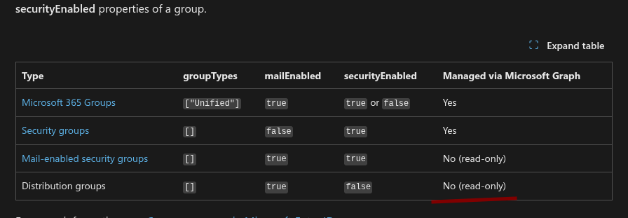

I’m not sure. In the official microsoft documentation on groups the Distribution lists are listed as Read only so probably not :frowning:
This screenshot is from this microsoft graph api documentation:
