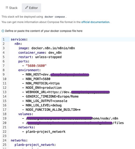

But I just installed the crypto-js module, as you can see here:
and I have the NODE_FUNCTION_ALLOW_BUILTIN set to *, as you can see here:
I am using N8N selfhosted and it’s all up to date.

I don’t think crypto-js is built in, so you would need to install it, I think if you made a Dockerfile
FROM docker.n8n.io/n8nio/n8n
RUN npm install crypto-js
and then changed your n8n to build
n8n:
build: .
#image: docker.n8n.io/n8nio/n8n
…rest of your compose
then to build run docker compose build
docker compose up -d --build
And then to update to newer versions run
docker pull docker.n8n.io/n8nio/n8n

The module crypto-js is not built-in n8n, only the crypto module, that is part of nodejs.
I would suggest you just use the crypto module, but if you really need to use the crypto-js, then you have to allow it as an external function:
NODE_FUNCTION_ALLOW_EXTERNAL=crypto-js

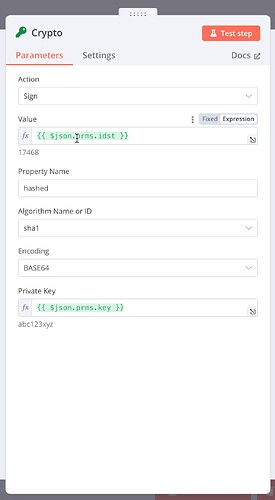

The crypto module, apparently, isn’t working.
Here’s the error I got trying to hashing a SHA1 string.
All of this is for generate a token for an API request, and the documentation is very bad made.
Error: error:1E08010C:DECODER routines::unsupported at Sign.sign (node:internal/crypto/sig:128:29) at ExecuteContext.execute (/usr/local/lib/node_modules/n8n/node_modules/n8n-nodes-base/dist/nodes/Crypto/Crypto.node.js:499:37) at WorkflowExecute.runNode (/usr/local/lib/node_modules/n8n/node_modules/n8n-core/dist/execution-engine/workflow-execute.js:627:42) at /usr/local/lib/node_modules/n8n/node_modules/n8n-core/dist/execution-engine/workflow-execute.js:878:62 at /usr/local/lib/node_modules/n8n/node_modules/n8n-core/dist/execution-engine/workflow-execute.js:1211:20

The crypto module is not working. Here’s the error:
"errorMessage": "error:1E08010C:DECODER routines::unsupported",
"errorDetails": {},

There is probably an error with the key.
Refer to this Question:
I’m looking to interact with the Bokun API .
To connect, I need to create a signature called X-Bokun-Signature in their documentation , which involves concatenating a number of parameters into a string, hashing it with SHA-1 and encoding it in BASE64. This is where I get stuck.
I’ve seen that a “Crypto” node lets me do this, but I’ve tried several times and I get an error message:
ERROR: error:1E08010C:DECODER routines::unsupported
What is the error messag…

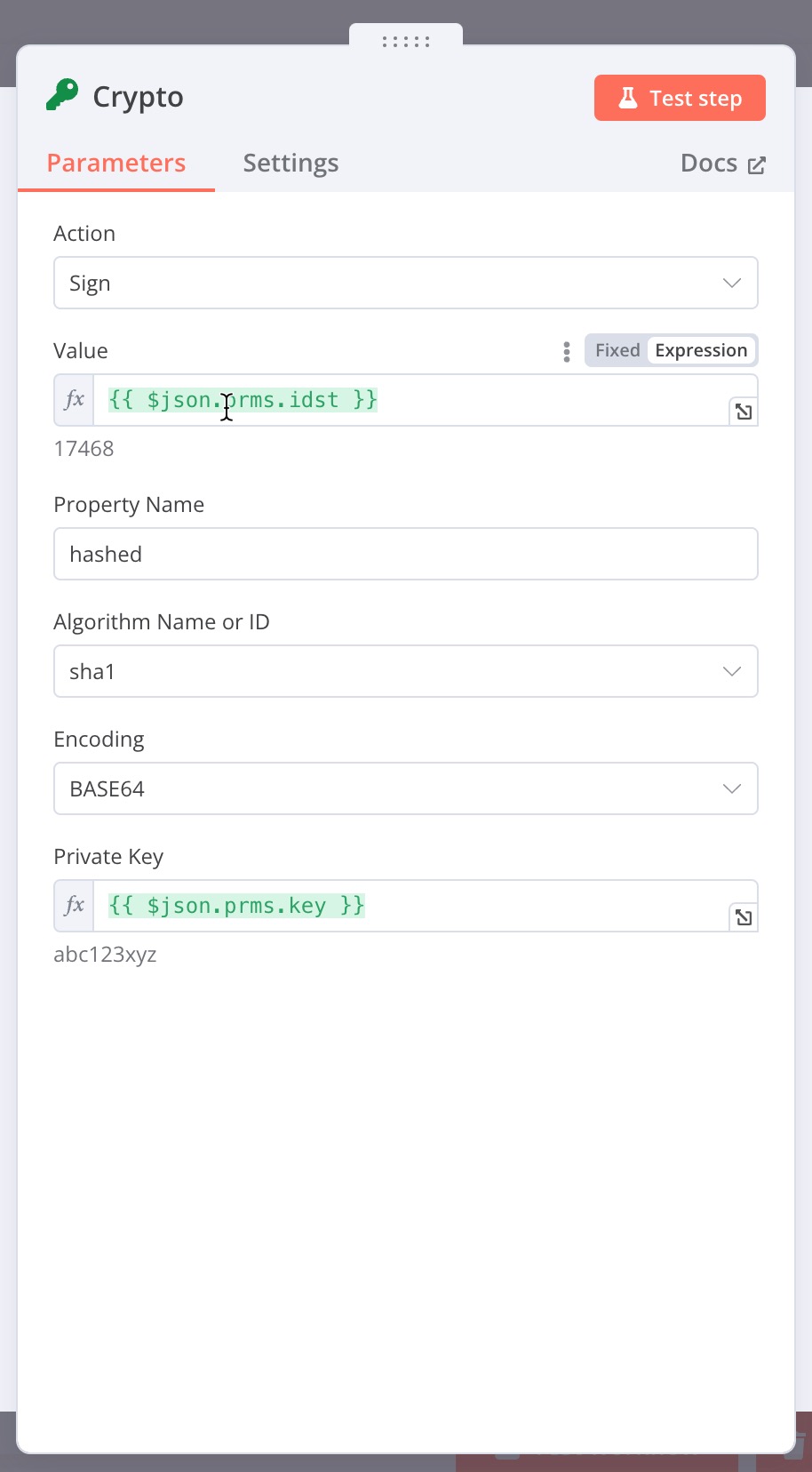

Using a command node is working, but, if you can catch what I did wrong using the crypto node, that would be helpful.
Here’s the setting I used and I think they should be right. The “input_string” in the script, is the “Value” in the setting.

You just need to use a valid private key so that the node can decode. That’s why you get the error.
As Jon put it in his answer (I'm having trouble signing a SHA1 string encoded in Base64 - #4 by Jon ), typically the Private Key would be something like:
-----BEGIN RSA PRIVATE KEY-----
MIICWwIBAAK…
abc…
-----END RSA PRIVATE KEY-----
The Private Key must be in the correct format so the Crypto node can use it.
That didn’t work either. I added a RSA private key, but throw an error and didn’t encrypt.
