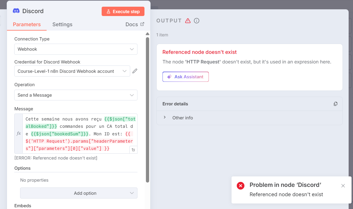

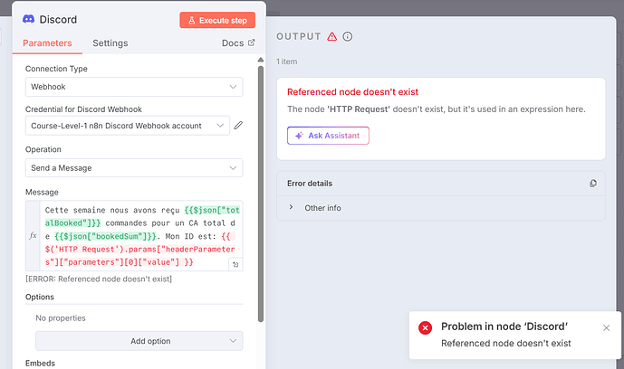

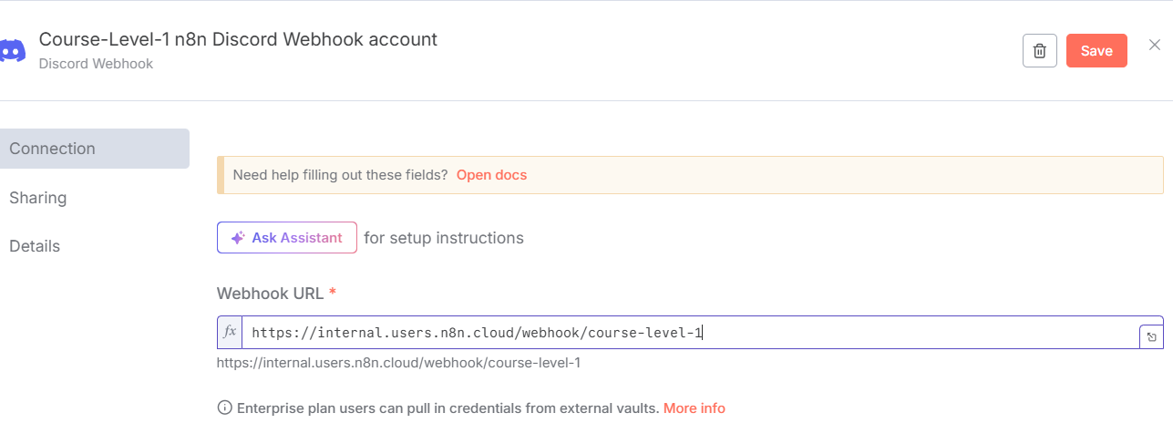

Hello,
I got the same kind of error following ‘the level 1 tutorial Getting data from the data warehouse | n8n Docs at the step that send the message to discord with the url https://internal.users.n8n.cloud/webhook/course-level-1
see screen copies hereafter.
Thank you for your help
Re,
I found out the error :
In the Discord message, i was calling:
{{ $('HTTP Request').params["headerParameters"]["parameters"][0]["value"] }}
However, my node was actually named “HTTP Request Get data from n8n Warehouse” (as I renamed it).
In n8n, the expression $('Node Name') must exactly match the node label.
That’s why I’am getting the “Referenced node doesn’t exist” error.
Solution 1 : modify the js code useing the exact name of the node
{{ $(‘HTTP Request Get data from n8n Warehouse’).parameter(‘headerParameters.parameters[0].value’) }}
Solution 2 : rename the node ‘HTTP Request’ .
