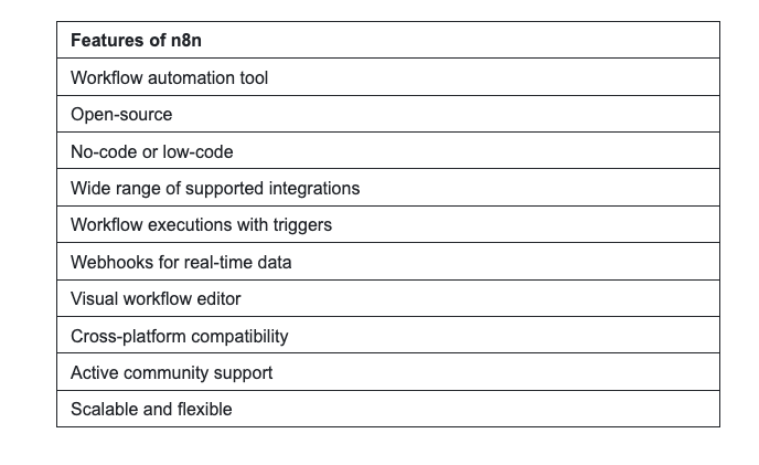

Here is what the output looks like when inserted into the doc.
This is the result I am looking for

Hi @Robm :wave: I had a deeper look into this because I was admittedly a bit mistaken - while Google Docs does support markdown, it only works if you are manually typing it in. It will not work if you paste in markdown.
While the Google Docs node doesn’t support tables, you may be able to get what you’re looking for via the HTTP Request node and manually sending over something that matches this data structure for their API: Working with tables  |  Google Docs  |  Google for Developers
However, if you aren’t tied to Google Docs specifically, it might be best to consider using Sheets instead for this, as the formatting you’re looking for might be much easier to achieve :see_no_evil:
