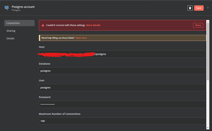

I’m having trouble connecting n8n to my Supabase PostgreSQL database. I’ve tried using the connection string and manual configuration with these details:
I’ve also tried different connection methods but nothing works. Has anyone successfully connected n8n to Supabase?

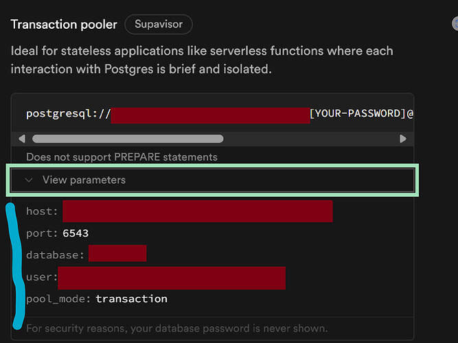

@Kiremit, you’re using the incorrect credentials. Supabase provides two sets of credentials: one for their API and another for PostgreSQL. The credentials you’re currently using are for their API, not PostgreSQL.
You can find the PostgreSQL credentials by clicking on Connect, then scrolling down to Transaction Pooler. These are the credentials for your PostgreSQL database, and the password is the same as the one from the previous set of credentials.

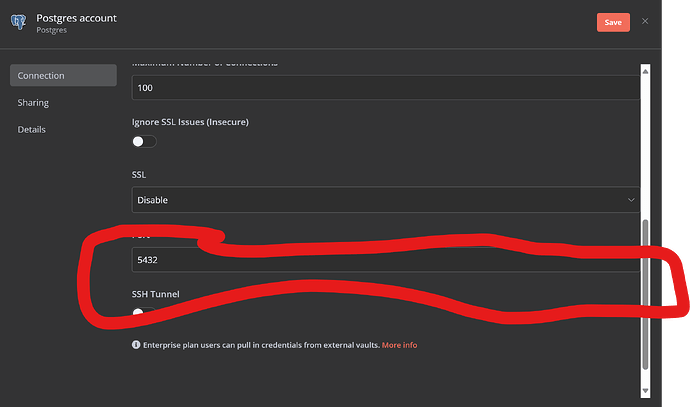

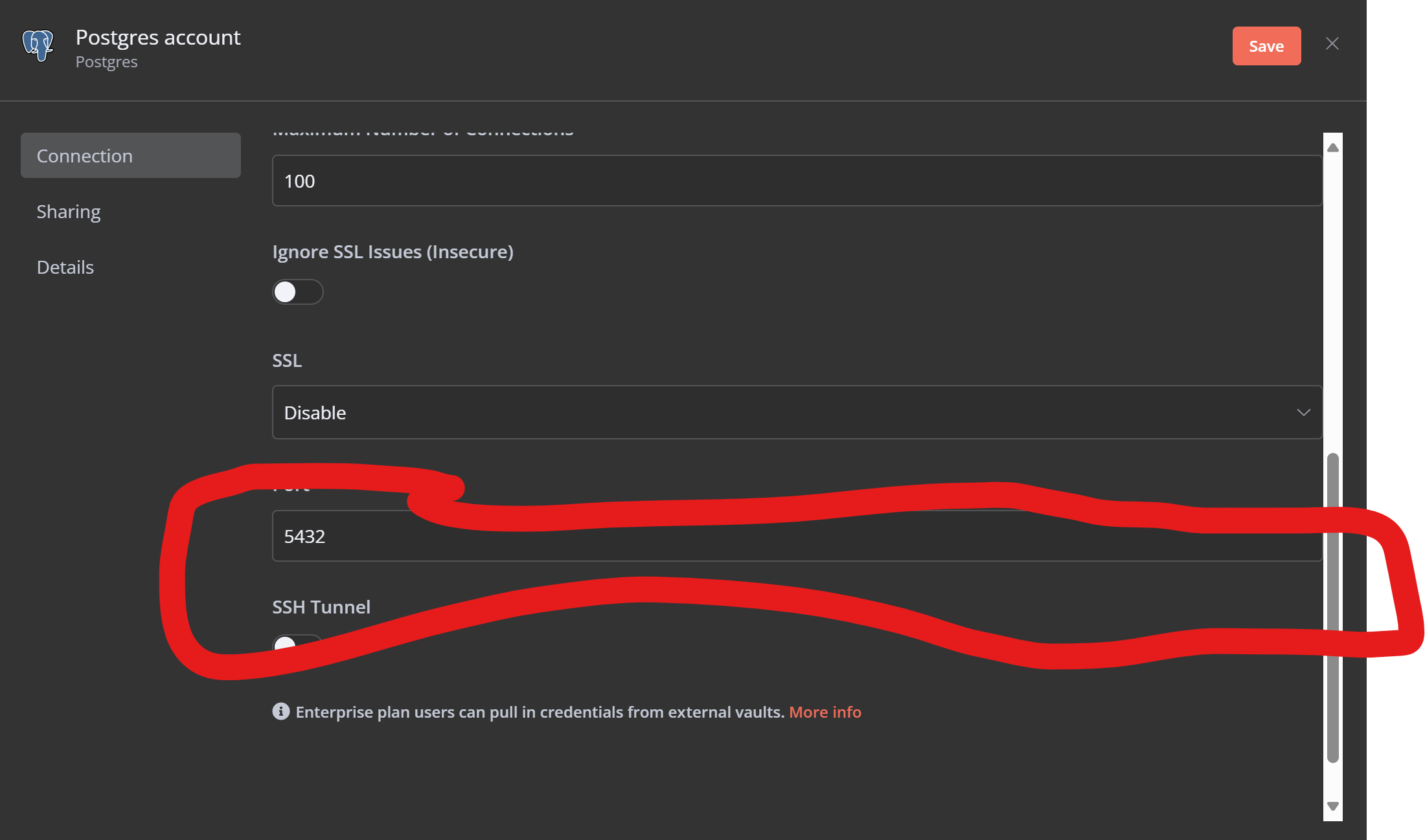

Supabase doesn’t make use of the default PostgressQL port, so make sure that one is changed to the one you were given.
I mean besides the password there is not really any credentials. The Project ID sure but thats part of the link. I only wonder why the password is part of the link ajnd then has to be entered seperately via N8N again
@Kiremit, the password is included in the link because of something called Connection URI’s. However, you’ll still need to enter each detail separately into n8n. The host goes in the host field, the database in the database field, the user in the user field, and the password remains the same. The port should go in the port field.

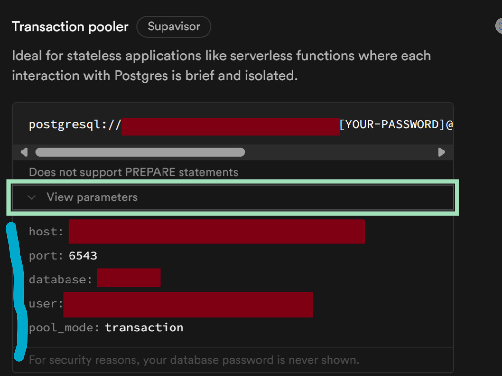

Please use the credentials I’ve highlighted in blue:
You’re my savior! Thank you so much!
Thanks a lot man! working fine!

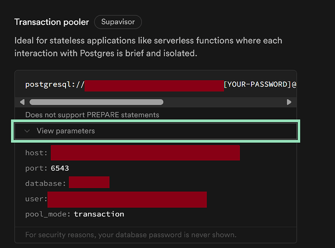

If anyone getting an error please use this connection.
" Transaction pooler
Shared Pooler
Ideal for stateless applications like serverless functions where each interaction with Postgres is brief and isolated."
