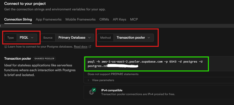

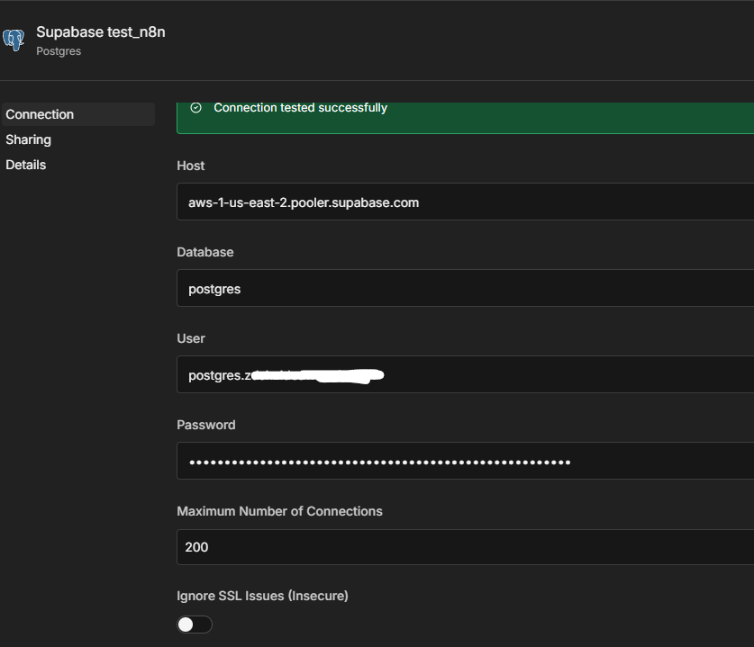

I think this should be straightforward,
Go to your Postgres instance and click Connect, then:
Next, go to n8n and copy-paste the values:

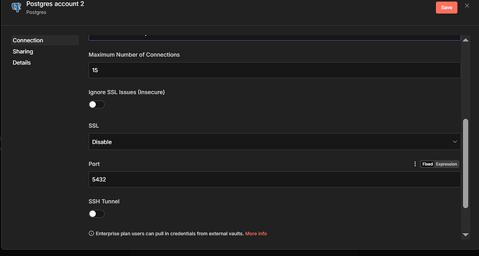

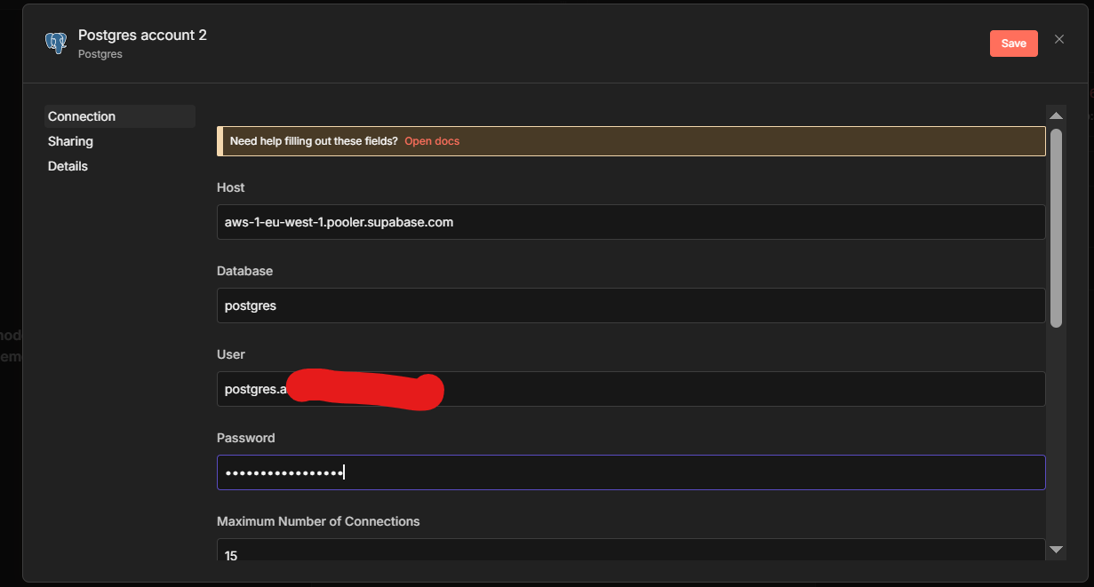

Should i screenshot further infromation?
No Just Hit connect into your postgres instance and add the credentials in the n8n postgres node and that would work
Thanks for this detailed reply. Step 2 was the solution:

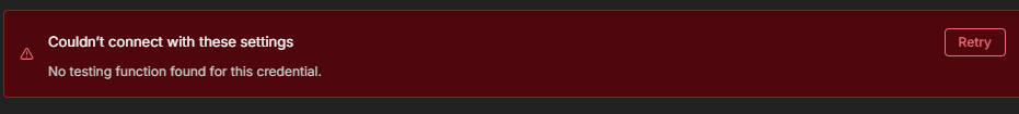

It gives me the same error:

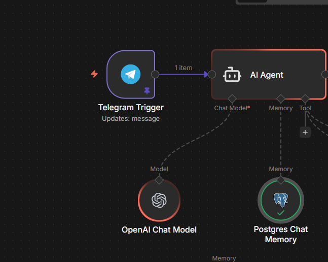

When I testrun it I receive this output.

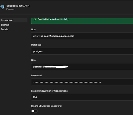

In Supabase the table is gathering new data.
Thanks a lot!
