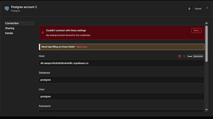

I’m currently trying to set up Postgres Chat Memory in n8n using a Supabase Postgres database, but I can’t get it to work and I’m stuck.
The screenshots show what I’ve done so far.
The credentials save, but I get an error notification.
Any help would be greatly appreciated. Thanks in advance!

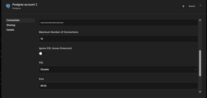

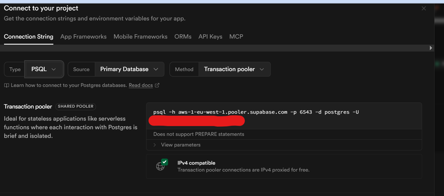

Are you using port 5432 or 6543?
Hi @tamy.santos , thanks for your fast reply :slight_smile: . I am using port 6543.

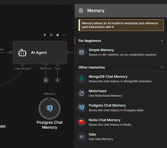

Hi @Anshul_Namdev thanks! I am trying to set up a chat memory. It seems that Supabase is not offering a special node that I can use in an AI agent.

Happy to help. Just to confirm, have you already checked if SSL is enabled in the Postgres credentials in n8n? You can find it under Postgres Credentials, then Additional Options, and SSL.
@Anshul_Namdev Got you. Unfortunately it did not work. Same error message as before.
@tamy.santos I have created new credentials trying to first set the SSL to allow and then to required. Unfortunately both did not work.

  1. Set SSL to Allow.
  2. (Recommended) Change Port to 5432 and update the Host to the direct connection string found in Supabase under “Session” mode.

Save and Test this Postgres credential, then select it in the Postgres Chat Memory node. If the test still fails, share the full error message and a screenshot of that Postgres credential (with password hidden). This will give us more context to see what exactly is the error

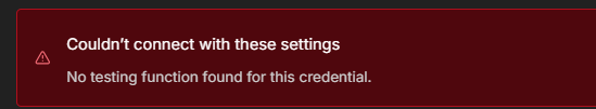

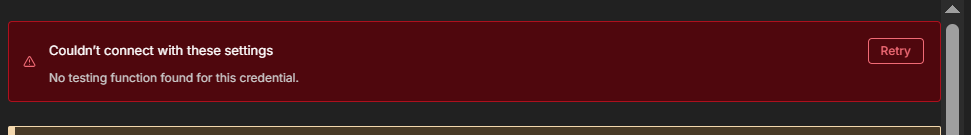

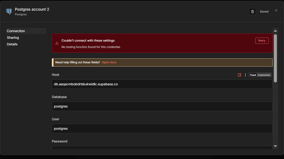

The Error: "No testing function found for this credential." is not a connection failure. It simply means that n8n’s “Test Connection” button logic does not exist for this specific type of Postgres setup. The button itself is failing, but your credentials might actually be correct
Step 1: Ignore the Test Button**
  1. Close the credential window (click “X” or “Save” if allowed).
  2. Execute the Node directly in your workflow (click “Execute Step”).
Step 2: The “IPv6” Trap (If execution fails)
If you try Step 1 and the node spins forever or errors out with “ETIMEDOUT”, you are hitting the Supabase IPv6 issue.
  • The Problem: You are using the Direct URL (db.aaqac...). This URL is IPv6 only. Most Docker containers (self-hosted n8n) do not have IPv6 enabled by default, so they cannot reach this address.
  • The Fix: You must use the Supavisor (Pooler) URL, but in Session Mode.
How to get the correct IPv4-compatible settings:

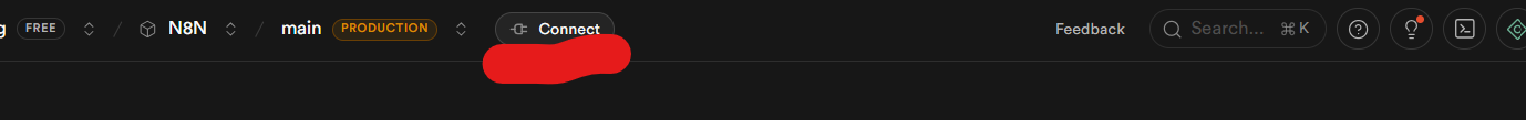

  1. Go to Supabase → Connect.
  2. Change Mode to Session (this is critical).
  3. Copy the Host: It should look like aws-0-[region].pooler.supabase.com (NOT db.aaqac...).
  4. Copy the Port: It should be 5432 (NOT 6543).
    Try Step 1 first. If that fails, apply Step 2.

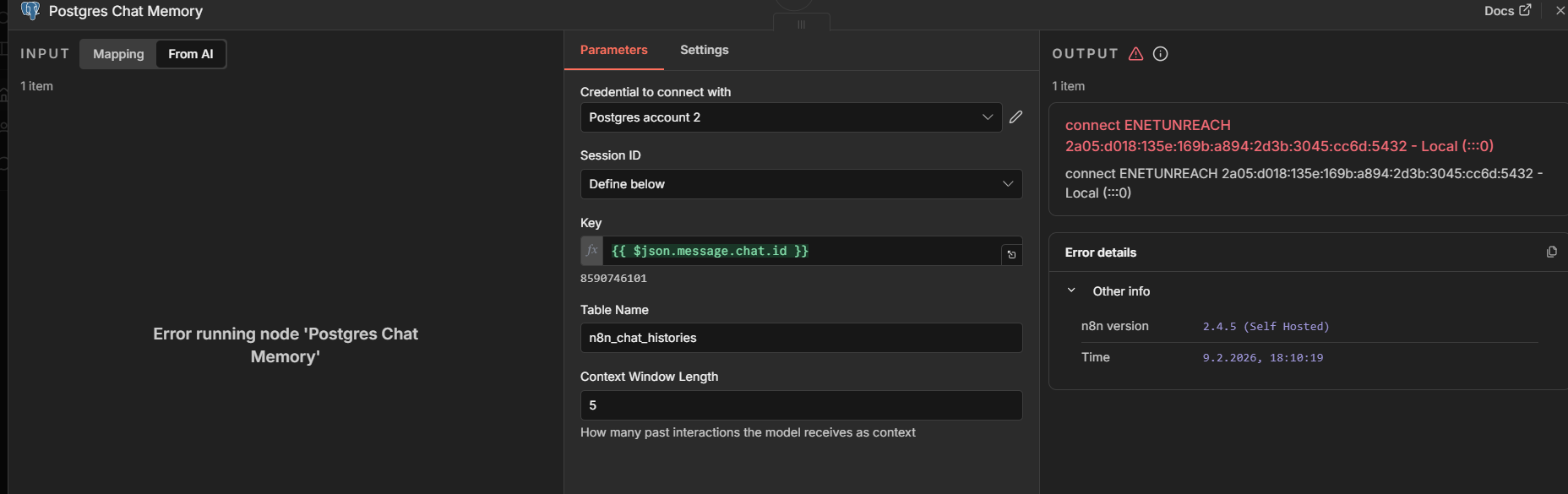

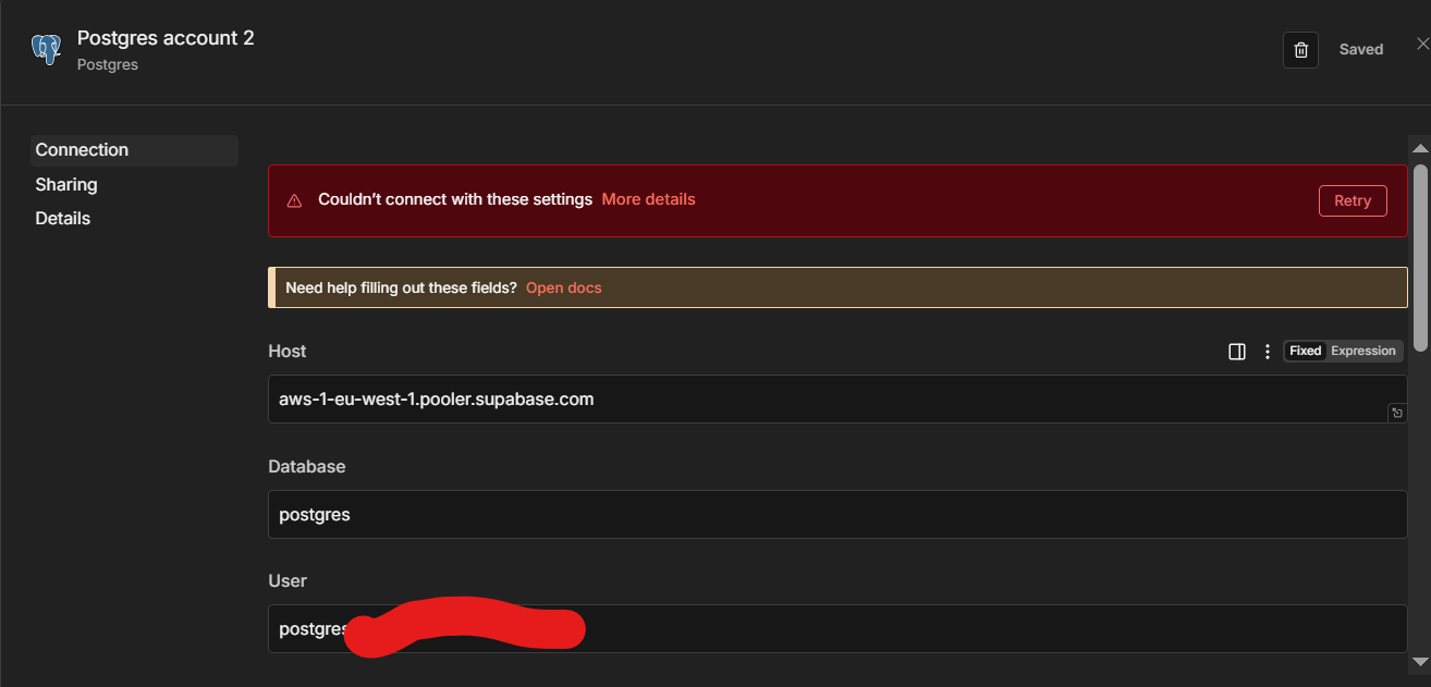

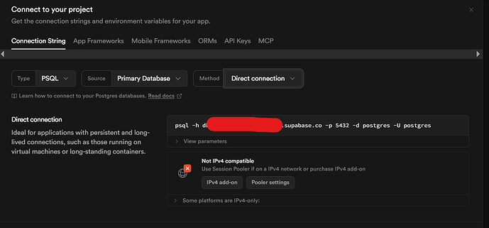

I
It is correct that I have to choose connect at the top?
After it I use the direct connection? Its the only option that gives me “postgres” as the user.
If i do it like that I receive this error. If i run the workflow the node outputs this error:
