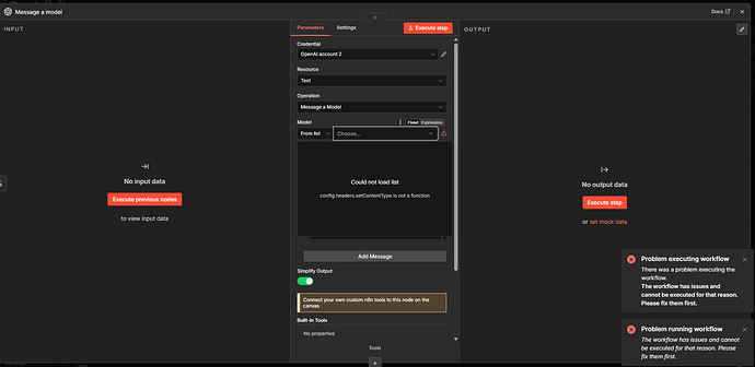

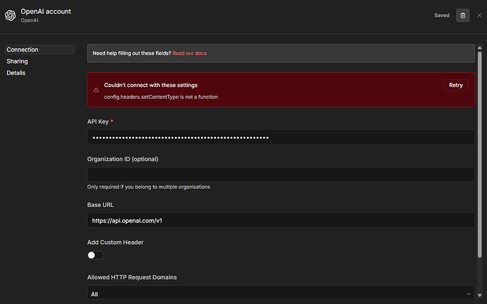

Hey guys, I can’t connect my OpenAI credential on my n8n platform, but before it was working well. Why ? I created a new account yesterday and the problem happened like this.
I already made those 3 solutions :
  • Create a new secret key
  • Add more $ on my OpenAI wallet
  • Turn on all permissions on OpenAI Platform
Here is the problem
  • n8n version: 2.19.2
  • Running n8n via (Docker, npm, n8n cloud, desktop app): VPS Hostinger
  • Operating system: Ubuntu 24.04
The error config.headers.setContentType is not a function is a known bug that appeared in some n8n versions around 2.18-2.19. It’s not related to your API key or OpenAI account - it’s a compatibility issue with how the credential test request is built internally.
A few things you can try:
  1. Update to the latest n8n version (this was patched in a later release)
  2. If you’re self-hosting, try running npm update n8n or pull the latest Docker image
  3. As a temporary workaround, skip the credential test and just use the credential directly in an OpenAI node with a test run - if the API key is valid, the node itself will work even if the credential tester throws this error
Could you share which n8n version you’re running? That would help narrow it down.

As suggested by Nguyen, I triggered my workflow despite the credential test error and it works fine (with a valid API key). Most likely a bug where the error gives false alarm.
Unfortunately, doesn’t work for me…
same problem same scenario,just got to hostinger then making some credentials then im stock with
this
The same issue and error with n8n 2.19.4 run via docker

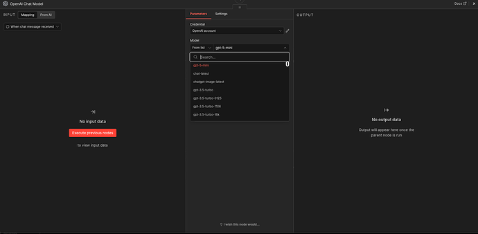

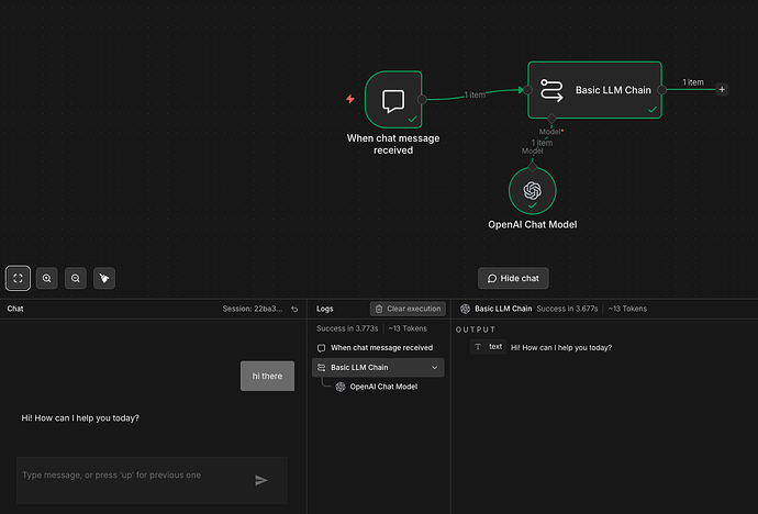

Meanwhile, may I know what’re you trying to achieve? Perhaps there are some alternatives to temporarily work around the issue while waiting for n8n R&D team to fix the issue. If it’s an AI chatbot (with OpenAI LLM model), then you may try using OpenAI Chat Model node instead (as below).
The OpenAI Chat Model node is able to return the list of available model despite the connection error.
Hope this helps.
THX, it works with AI Agent despite returning the error.
yeah it works,i didnt expect this to go on thats why i didnt try but it actually works,tnx my brother
thx it’s working also for me ! I have to create my entire workflow again and modify everything XD
