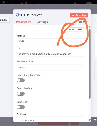

Hi,you mentioned that with curl it worked. Cant you just import the curl, so you are sure about the request format?
Reg
Jiri.
i didnt understand. i i have the “file0” pdf ready to be sent via api, but in the “http” node its just not working.
Hi, you said you have successfully tried with curl. So you could import your curl command and it hopefully it will configure your http request as it should be.
The data part is another question.
Can you share your workflow?
Reg
J

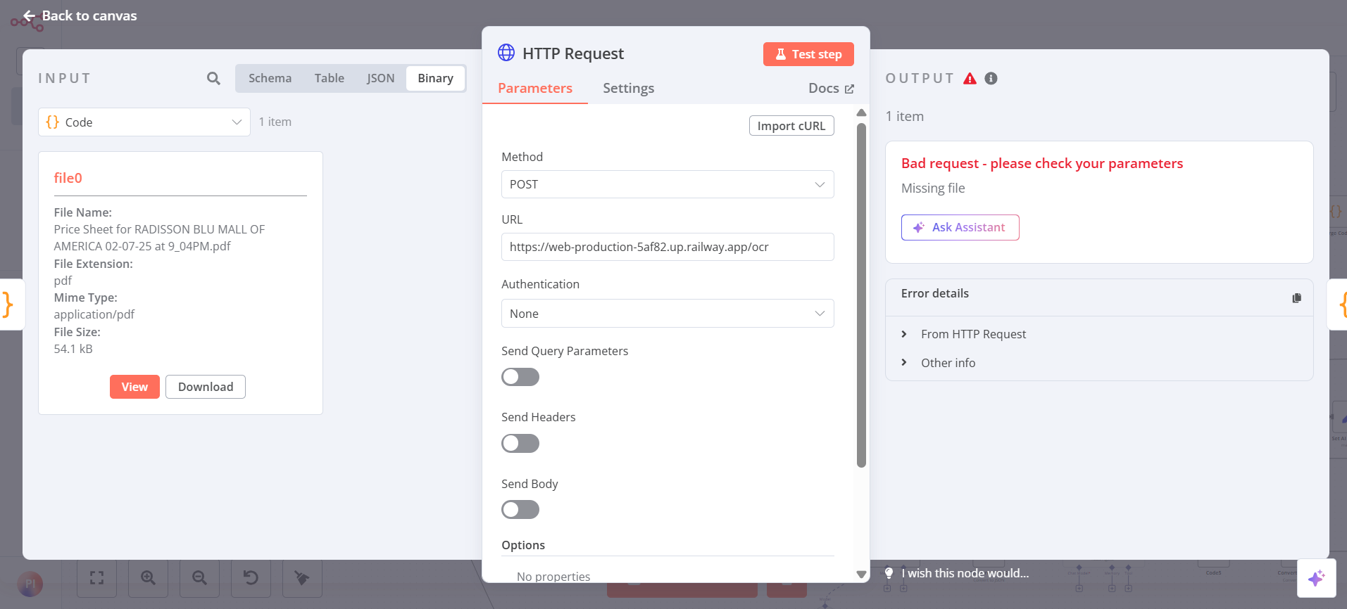

hii’ i tried and i get this -
“Cannot read properties of undefined (reading ‘value’)”
this is my workflow -

In the HTTP Request node, I’ve set:
  • Method: POST
  • URL: https://web-production-5af82.up.railway.app/ocr
  • Body Content Type: multipart/form-data
  • Binary Property Name: file0
Still, nothing works. :weary:
For example, here’s the error I get from n8n:
sql
CopyEdit
Missing file
When testing with Postman (same URL, same file, same form-data with key file0), it works perfectly.
It seems like n8n isn’t sending the binary properly – or my server doesn’t recognize it as expected.
If there’s any example of a working config that sends a file as file0 using the HTTP Request node, I’d love to see it :pray:
