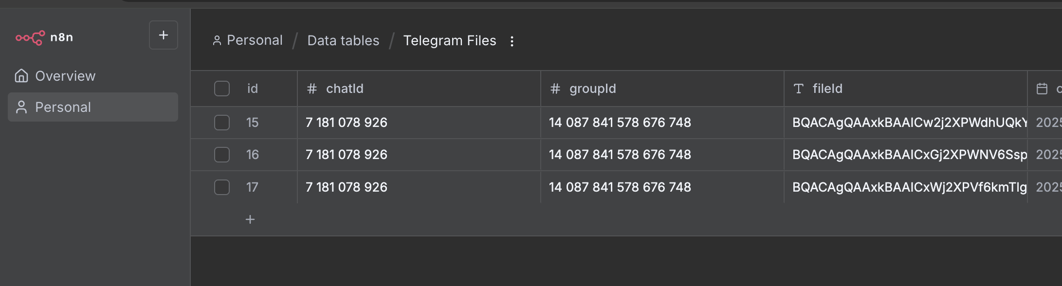

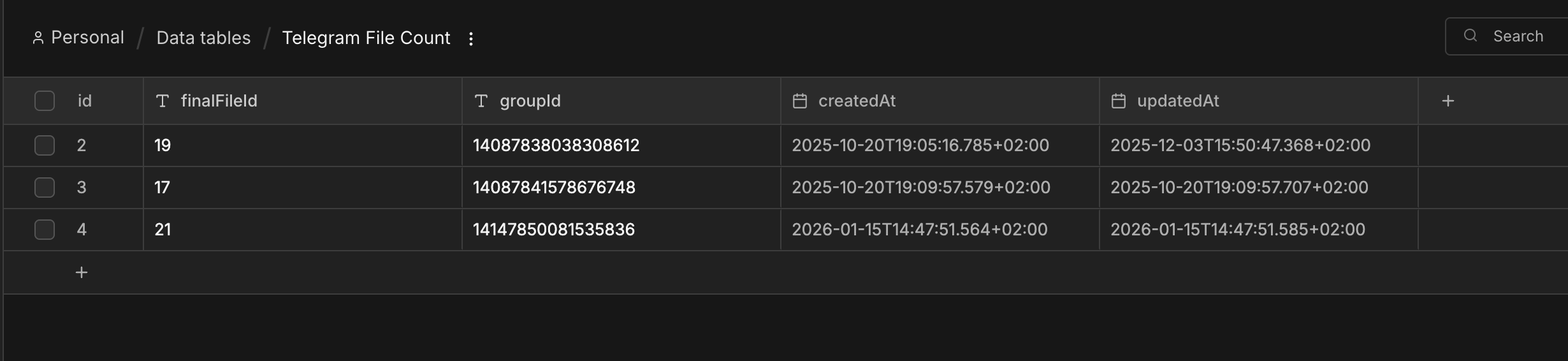

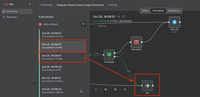

If multiple files are uploaded, we store them all in a data table (or normal db if you want) for later processing. We then wait 5 seconds for all workflows (remember one execution per image) to be stored. After 5 seconds we then retrieve all records for each file in the media group and compare the last id we received. For the workflows which is not the last one we simply ignore. When we find the last workflow which was executed, we proceed to download all files. This is the execution you want to not carry forward into uploading your files to gemini and doing what you need

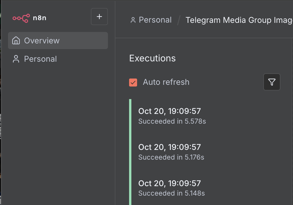

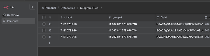

So I sent a message with 3 photos attached. As you can see there were 3 workflow executions, each writing a record to a data table for the chat, media_group_id and file_id. Only the last execution will actually go on to download all files and process them

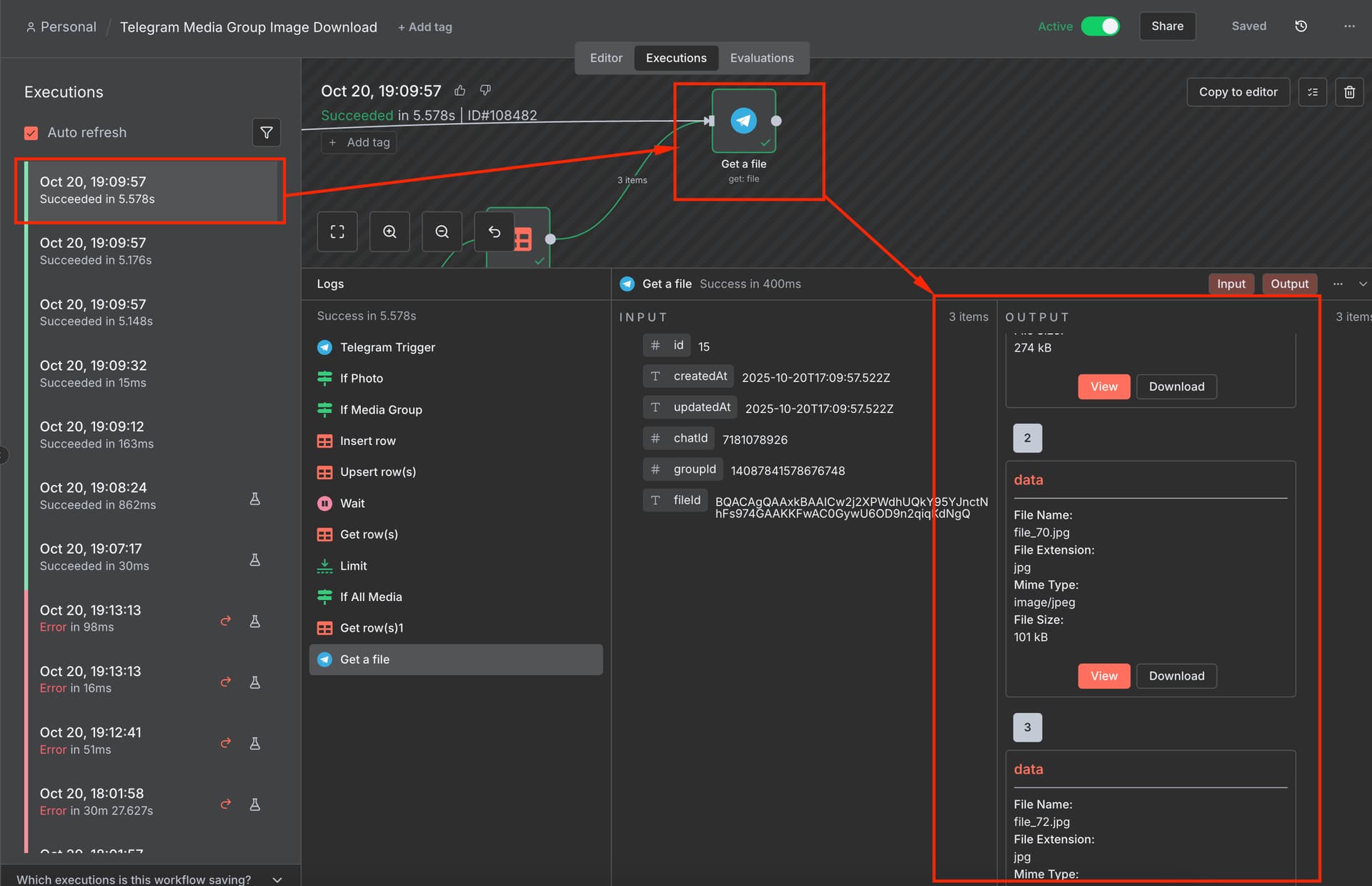

ONLY the final execution went on to download all files based on the media group id

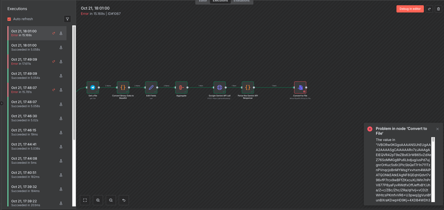

Wouter, you cannot image how much you have helped me. Thats the solution I needed!! I have impleted it into my workflow. But now I am getting stuck on the very last step. I managed to get all photos into n8n, recover their binary (as you showed me above) and even feed them into Google Gemini Flash 2.5 image preview (nanobanana) API endpoint through HTTP request. However, I am really struggling to convert the output (base64) back to binary (through Convert to file node). I am not sure what is the error and how to fix it. I have been sending only 2 images into this n8n workflow through Telegram with a simple prompt (in the caption) as “Combine these two images (as example). Could you help me from here so I can Convert the Base64 data from the Nanobanana API call into binary to send back to Telegram?
The specific error is: “The value in {{base64data}} is not set”
Here is the workflow:
Just to close this off, based on our call now, you just had to map out the data from the Gemini response so the base64 to file node could look at the correct data.
Thank you so much for your help @Wouter_Nigrini !

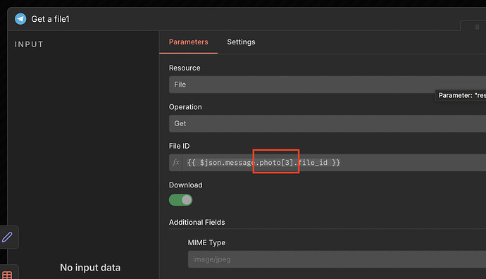

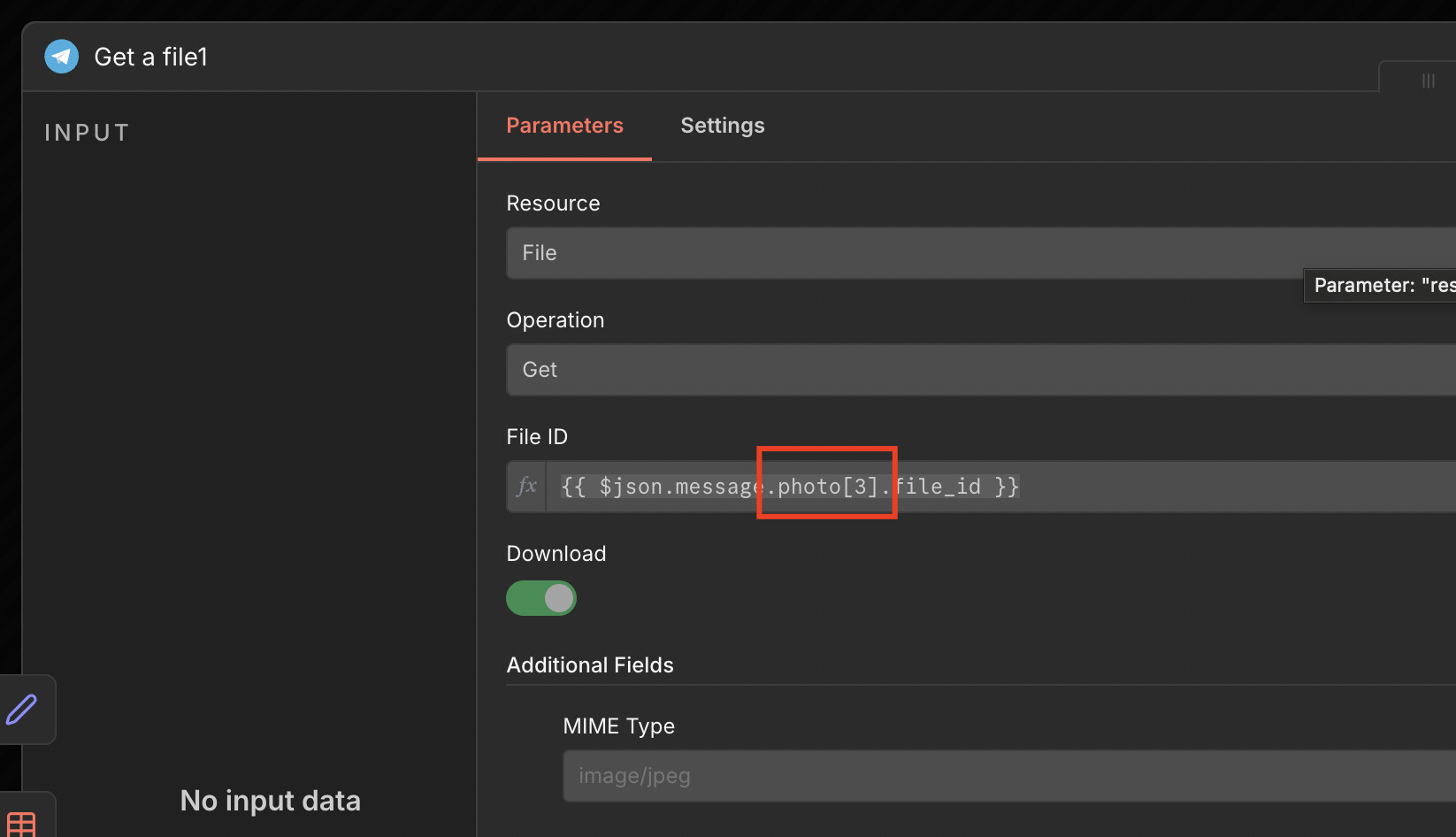

i am havin an issue with the workflow i dont understan why i am getting a diffrent result compared to the one above plese help
@Nehemiah_Workflows in the last node “Get a file1” you’re mapping the data to photo[3] which is not the same as to my original example. This will cause you to only get one file

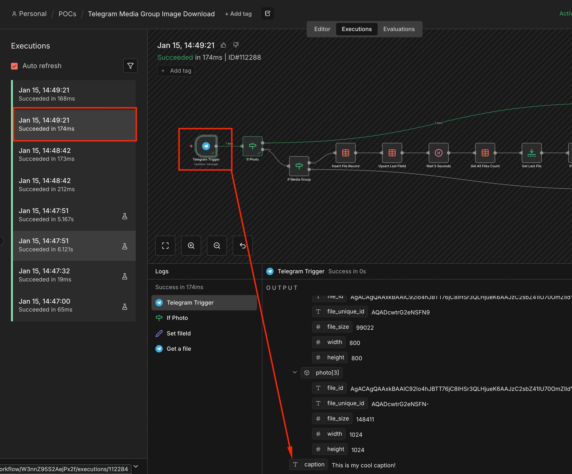

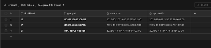

Hi Wouter, I’m having a similar issue with sending multiple images. In my case, I need to use the caption as the name for a new Google Drive folder. However, every time I send multiple images at once, the caption doesn’t seem to come through. Do you have any advice on how to fix this? @Wouter_Nigrini
Hi @frendy_nicodemus,
The workflow is exactly the same. You’ll just need to capture the caption from the first call which came through and then store it in the data table, the same way you store the image ids. Then use it on the last call when all images got triggered.
I would add the additional column to the Data Table “Telegram File Count“ as this caption is then stored once for the media group. I would probably now rename this table to something like “Telegram File Metadata”
You’ll just need to do another lookup from this “metadata” data table to get the caption. I could also at this point just store a json stringified object of any important data I want to store for the group
