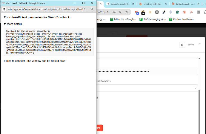

When trying to connect LinkedIn to n8n using the LinkedIn OAuth2 API credential, I get this error after clicking “Connect my account”:
Error message:
Error: Insufficient parameters for OAuth2 callback.
Received following query parameters: {
  "error":"unauthorized_scope_error",
  "error_description":"Scope \"w_organization_social\" is not authorized for your application"
Failed to connect. The window can be closed now.
What’s happening:
  1. I click “Connect my account” in n8n
  2. LinkedIn’s login page loads (I can see it)
  3. I authenticate with my LinkedIn credentials
  4. LinkedIn asks for permission to access my account
  5. Instead of completing the connection, I get the error above
  6. The page says “In five seconds, you will be redirected to: asim.sg-node8n.serverdoor.com
The key issue: LinkedIn is rejecting the OAuth callback because my app is requesting a scope (w_organization_social) that it’s not authorized to use.

yeah that w_organization_social scope error is a linkedin app permissions issue, not your redirect uri. in the app settings on the linkedin developer portal, you need to explicitly request that scope — just having it in your oauth config doesn’t give you the permission to use it. check if your app has it listed under “products requested” or “sign in permissions”. if its grayed out, your app might not be approved for that scope yet (linkedin takes a while to approve some of them). if thats not it, sometimes switching to the basic openid scope first and testing that works helps isolate whether its a credential config issue or a permissions one

One thing that hasn’t really been called out yet is that this does not look like a redirect URI problem. The callback is reaching n8n, but LinkedIn is rejecting the authorization because w_organization_social is being requested and your app is not allowed to use it. So if your goal is to post to your personal profile, I’d check whether the credential is still requesting organization access at all. In n8n, the Organization Support option is what adds w_organization_social , so I’d make sure that is off and then recreate the credential from scratch before reconnecting.
I’d also verify that your LinkedIn app has the Share on LinkedIn product enabled, since that is what grants w_member_social for personal posting. Once the credential connects cleanly with only the member scope, then the LinkedIn node or HTTP Request path should both be viable.

Thanks for breaking that down! I’ve been testing exactly what you suggested - toggling Organization Support and recreating the credential fresh. But I’m hitting a catch-22:
With Organization Support ON: w_organization_social is rejected (not approved for my app) With Organization Support OFF: r_emailaddress is rejected (legacy scope, not in my app)
So it seems n8n’s LinkedIn credential is requesting scopes beyond what I can control with the UI toggles.
Since my goal is just personal profile posting, I’m going to build the OAuth flow manually using HTTP Request nodes - that way I can request only w_member_social and avoid both of these scope conflicts entirely.
I’ll report back once I have it working. Thanks for the guidance!
Good move! The manual OAuth flow approach is solid — it gives you complete control over exactly which scopes to request, no unnecessary scope creep. That’s the right strategy for this use case. Let me know how the testing goes! :+1:
Ok so it worked! Thanks for helping so much. I basically had to turn off the Organization Support and than the legacy scope aswell, and bascially create another new client secret and it has worked!
