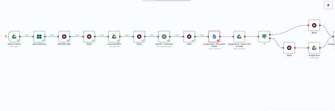

Hi all - I am seeking some support from the experts here at n8n. I keep getting a user rate limit exceeded error.

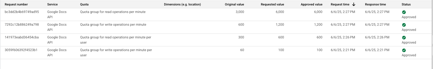

Also quote has been increased from the defaults.
and
See my workflow - My_workflow.json

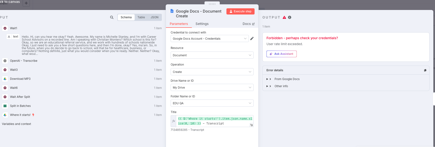

Forbidden - perhaps check your credentials?
User rate limit exceeded.

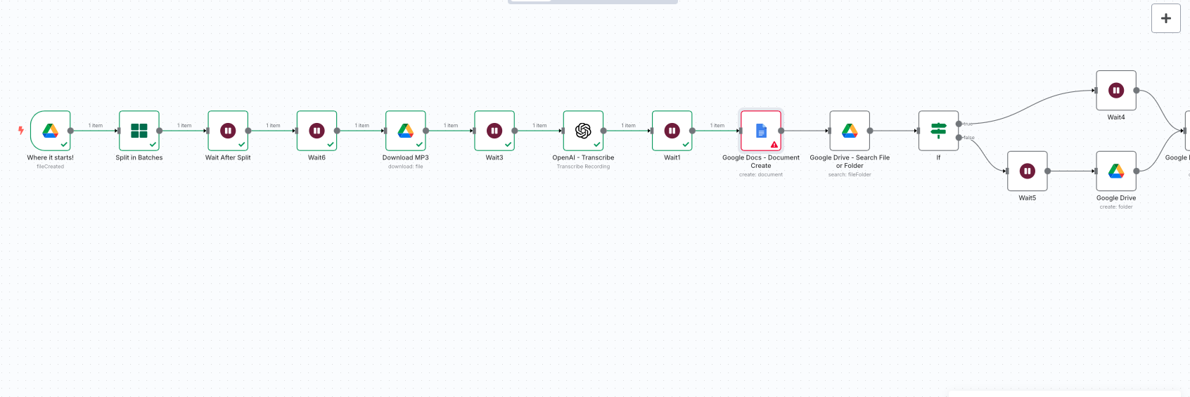

Thank you for replying. Please see the below workflow, and I don’t think I have more than 26 workflows per hour.
That workflow is suppose to feed into the AI Agent.

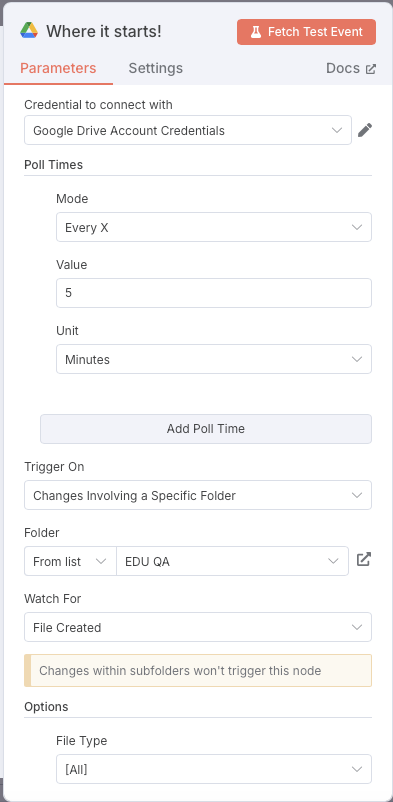

is your worklfow triggers also on the files which it creates during the execution?
As I see that it watches for files in the folder EDU QA and later during the execution it will create some files and folders within that folder. So produced files also may be grabbed by the trigger.
I think so even though I only need it to handle .mp3 or audio files.
