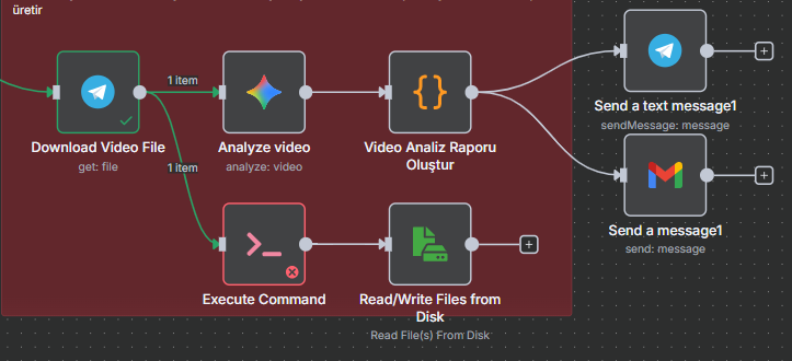

I want to extract an audio file from a video received via Telegram or Webhook.
I installed FFmpeg locally. Installation directory: C:\ProgramData\chocolatey\bin
This is the Execute command I use to extract audio from a video:
ffmpeg -y -i “{{ $json.result.file_path }}” -vn -acodec pcm_s16le -ar 44100 -ac 2 “{{ $json.result.file_path.replace(/.[^.]+$/, ‘’) }}.wav”

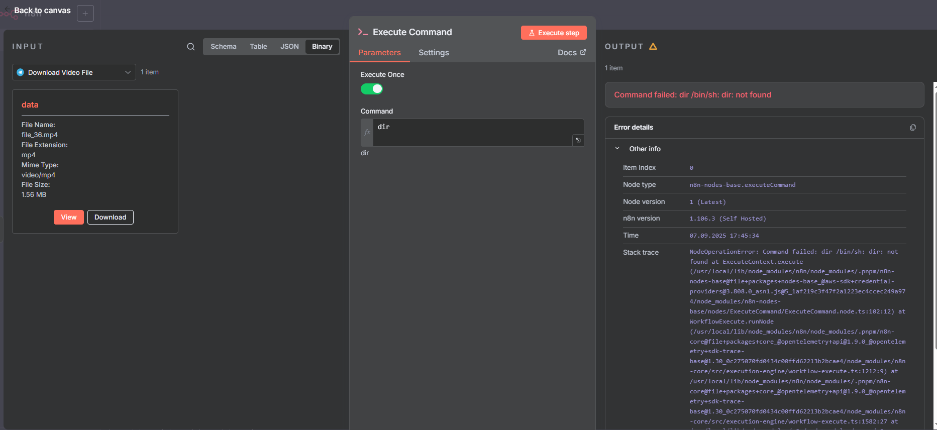

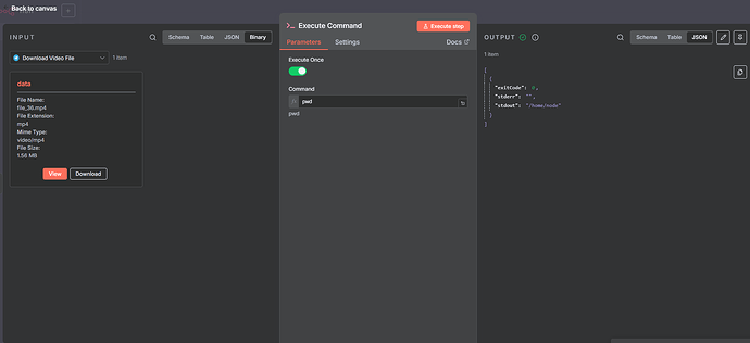

Did you try to run either dir or pwd to learn the current working directory?
It gives the following error for dir:

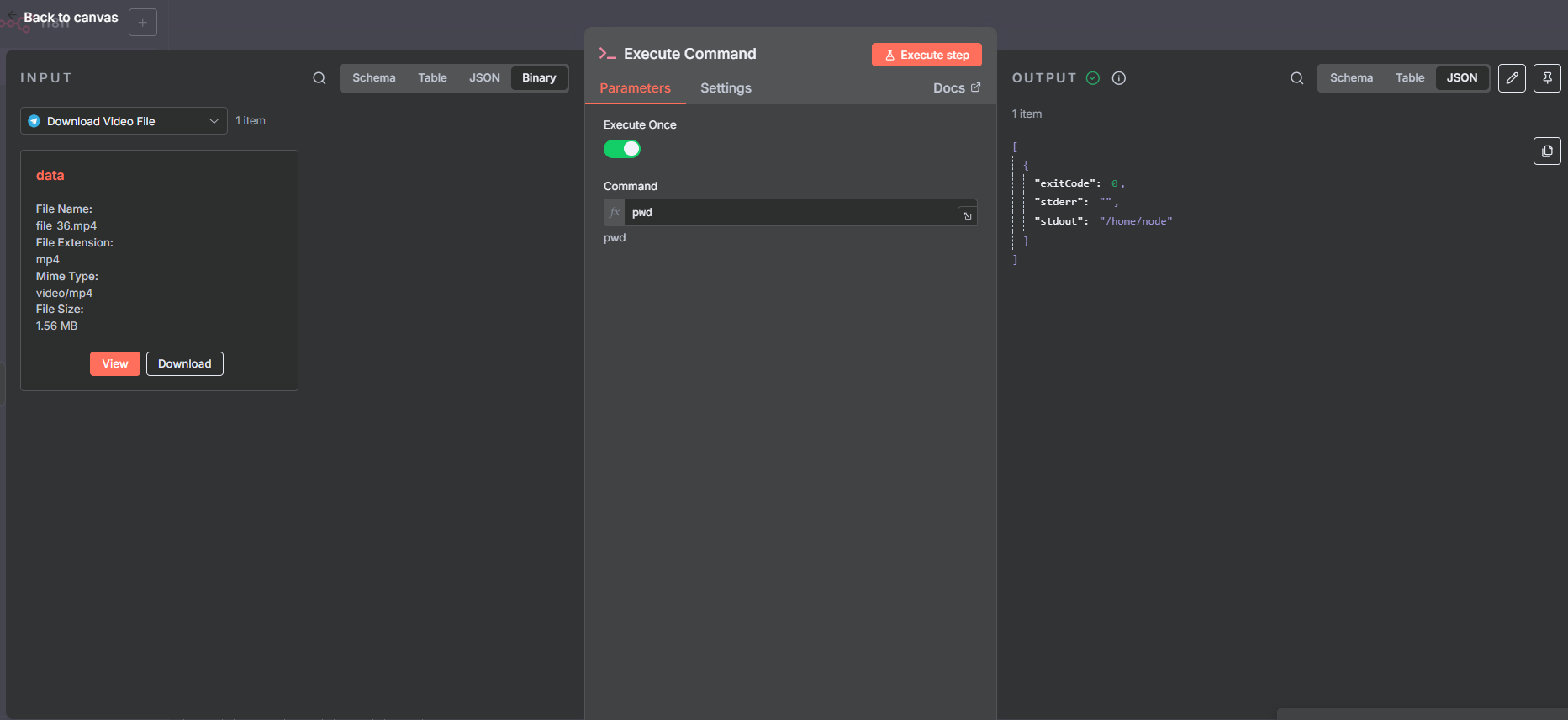

And gives this return for pwd:
OK I found out that I’m using a nother version which is not my local version bcause the n8n browser path is: https://jtlnyrul.rsrv.host/
