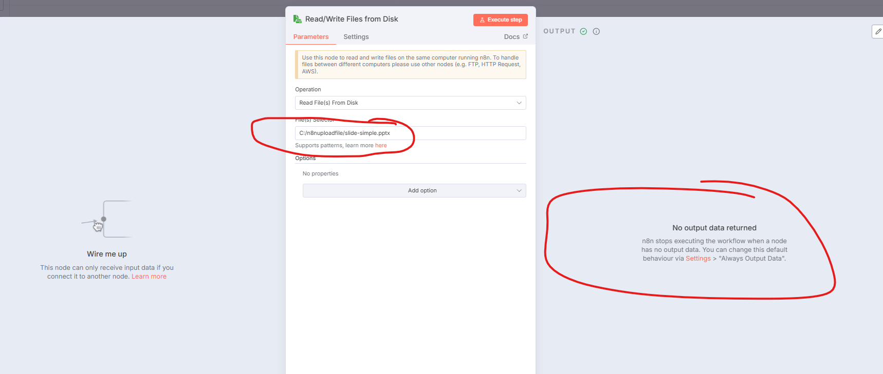

Hi, I’m new to n8n and currently running a self-hosted instance on my notebook. I’m trying to create a simple workflow that reads a file from my local drive, but I’m not getting any output.
I’ve confirmed that the file exists and is accessible on my machine. However, the workflow doesn’t seem to return any data.
Does anyone have any idea what might be going wrong? I’d really appreciate any guidance. Thanks!
No output data returnedn8n stops executing the workflow when a node has no output data. You can change this default behaviour via Settings > “Always Output Data”.

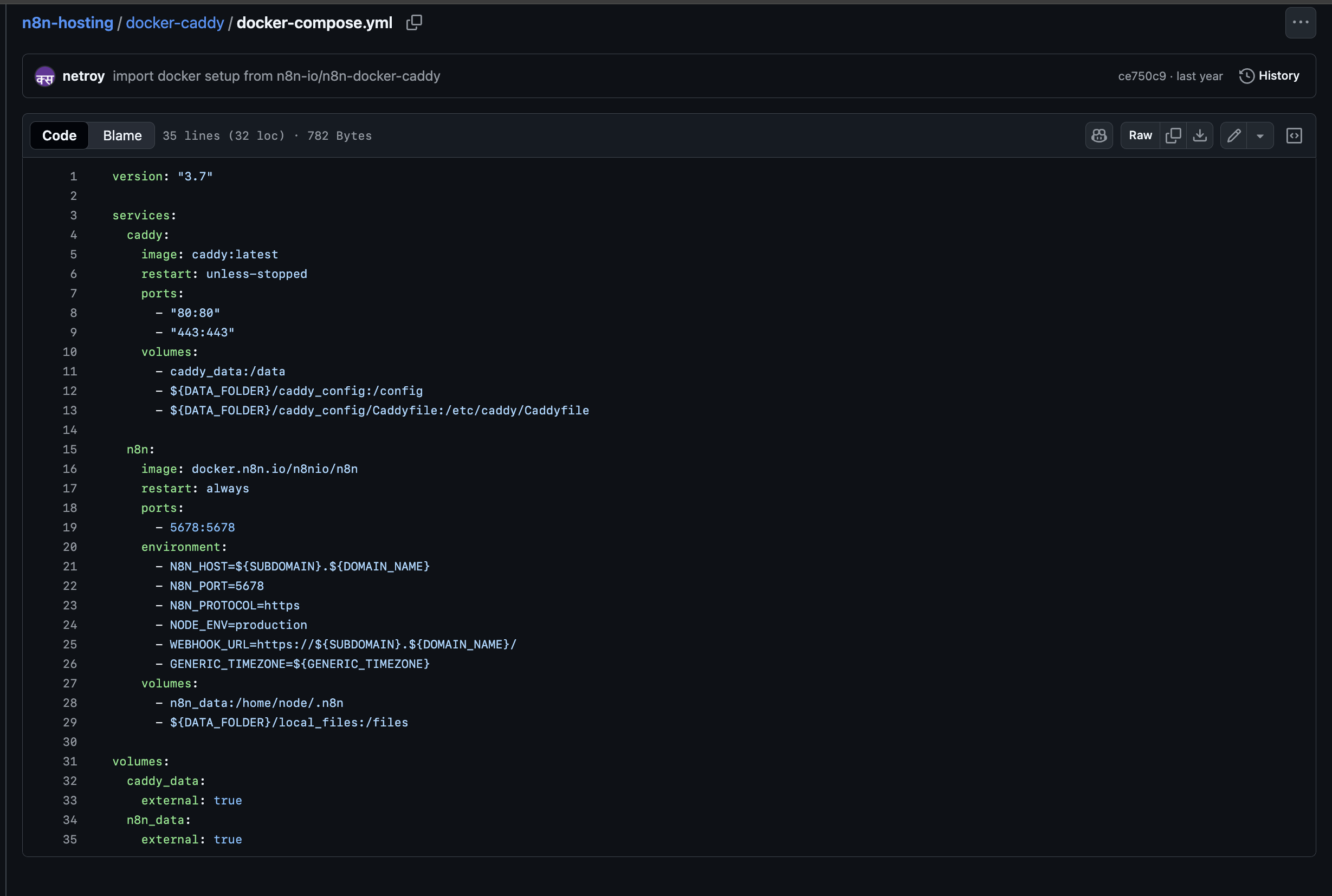

hi there @andyw , the docker compose should look something similar like this
and yes, you should add that line below the volumes, so below line 31, and it’s in the same hierarchy as the caddy_data and n8n_data

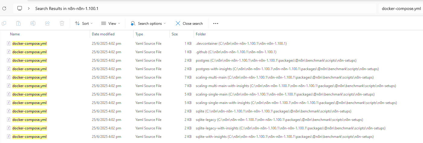

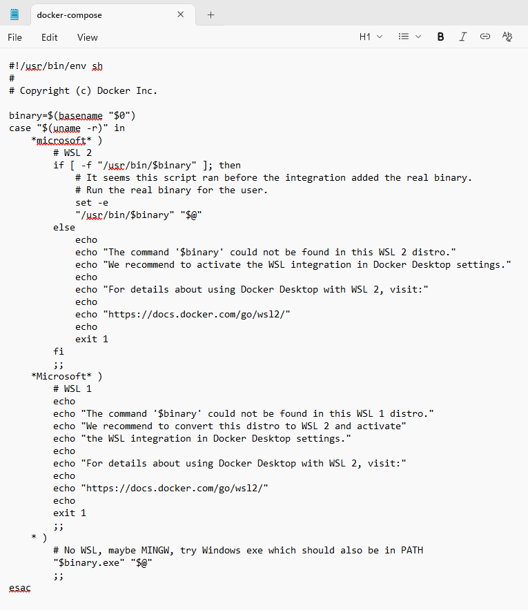

Sorry I am no knowledge for IT and docker. I search from my local drive and found alot files
docker-compose.yml
May I know which one is correct?
Sorry, I don’t have any knowledge about IT or Docker. I searched my local drive and found many files named
docker-compose.yml.
Could you please help me identify which one is the correct one?
thanks
Probably so unrelated to the topic right now but I suggest you use an application of which you can control your server in a web-interface. Basically Easypanel (or any other alternative service out there) offers a very user-friendly interface that makes deploying Docker apps a piece of cake.
I am very unfamiliar with Docker too but having an interface like the one I mentioned made my life easier.
hi there, it should be in a folder where you install the n8n, and i am not sure where you keep that since it’s in your local
but you can try to search for the n8n folder first, and then inside there should be docker compose
