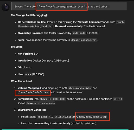

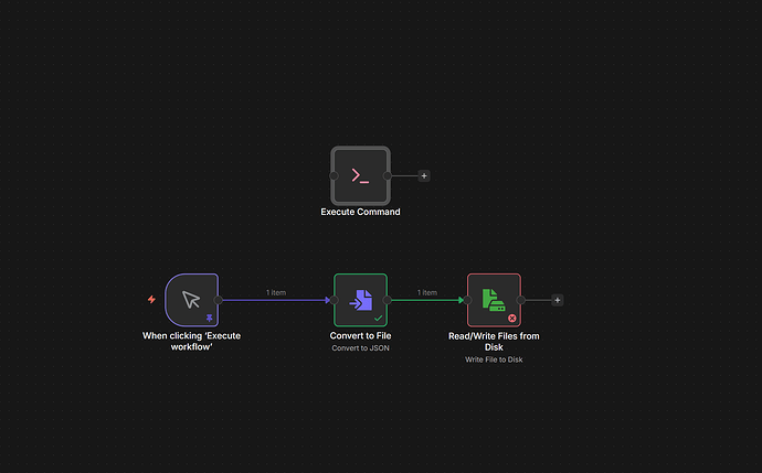

The Problem: I cannot use the “Read/Write Files from Disk” node to save a binary file. It always returns:
Error: The file "/home/node/video/myjsonfile.json" is not writable.
The Strange Part (Debugging):
  • OS Permissions are fine: I verified this by using the “Execute Command” node with touch /home/node/video/test.txt. This works successfully! The file is created.
  • Ownership is correct: The folder is owned by node:node (UID 1000).
  • Path: I have mapped the volume correctly in docker-compose.yml.

What I have tried:
  1. Volume Mapping: I tried mapping to both /home/node/video and /home/node/.n8n/video. Both result in the same error.
  2. Permissions: I ran chown -R 1000:1000 on the host folder. Inside the container, ls -ld shows drwxr-xr-x node node.
  3. Environment Variables:
    • I tried setting N8N_RESTRICT_FILE_ACCESS_TO=/home/node/video,/tmp
    • I also tried commenting it out completely (to disable restriction).
    • I ran docker compose down and up -d after every change.
Question: If the OS permission allows the n8n user to touch a file via the “Execute Command” node, why does the “Write to Disk” node block the operation? Is there a hidden security restriction in v2.1.4 preventing writes to specific mapped volumes?

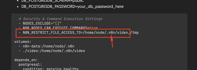

  # Security & Command Execution Settings
  - NODES_EXCLUDE="[]"
  - N8N_NODES_CAN_EXECUTE_COMMANDS=true
  - N8N_RESTRICT_FILE_ACCESS_TO=/home/node/.n8n/video,/tmp
volumes:
  - n8n-data:/home/node/.n8n
  - ./video:/home/node/.n8n/video

Hi @peraphat.boonndet ,
It looks like you set the wrong path. In your config you have the dir which includes a .n8n sub dir
However in your node, you’re using a different path. Remove the “/.n8n” from the env var and try again
Make sure you are using the exact same paths as configured
