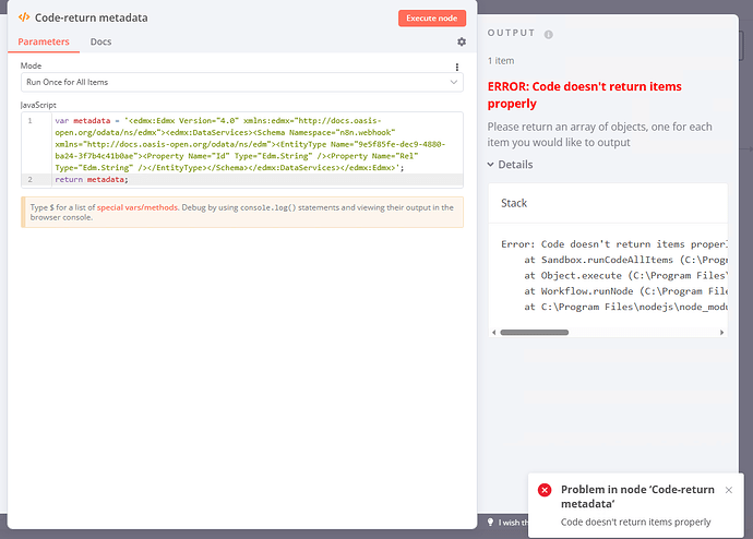

I tried to play with the code node responding xml but I’m not sure how to make it work.
Using XML To JSON Converter I’d tried converting the xml to json then using the XML node to convert it back but it introduced \n and return with “data” property eventhough I left the property name as blank.
I tried to use Set to return the XML but the property name always returned and doesn’t make it XML.
I tried to includes Accept header but no improvement. Also removed the carriage return so \n is removed, however still couldn’t force a XML response.
Hi @Jon I don’t think n8n support xml response natively. This isn’t a bug but rather WAD as of today? Hence I raised a feature request for this case.
I tried calling jsdom to parse the XML and it showed correctly in the console but code is expecting an array each time.
