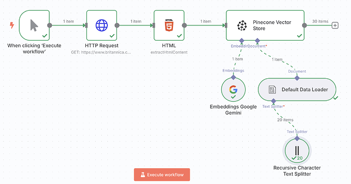

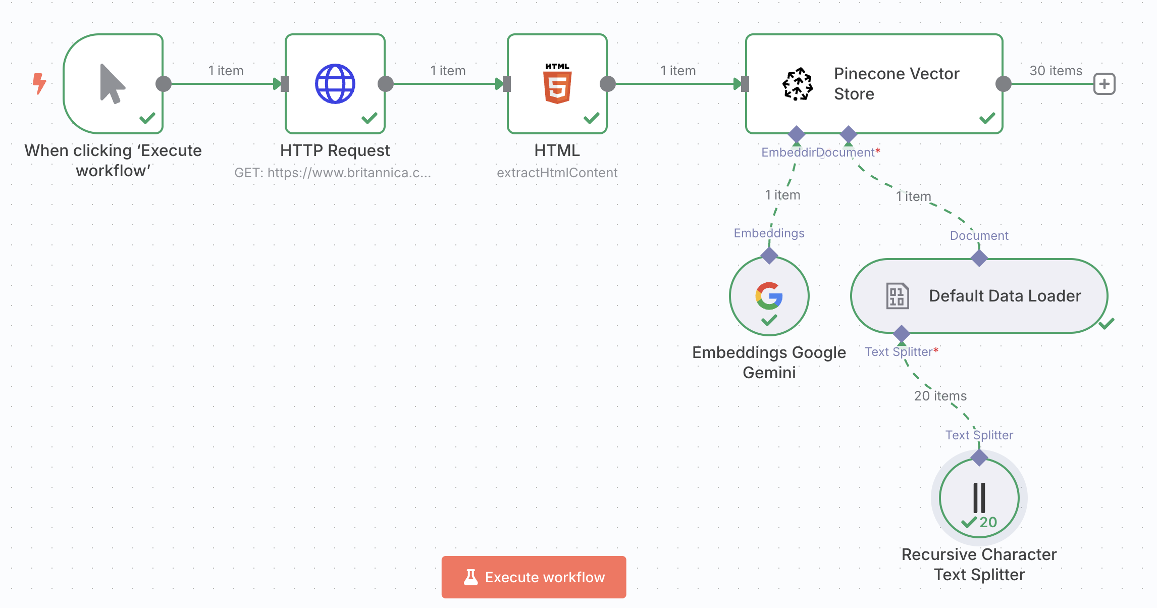

pasteworkflow
first workflow:
second workflow:
