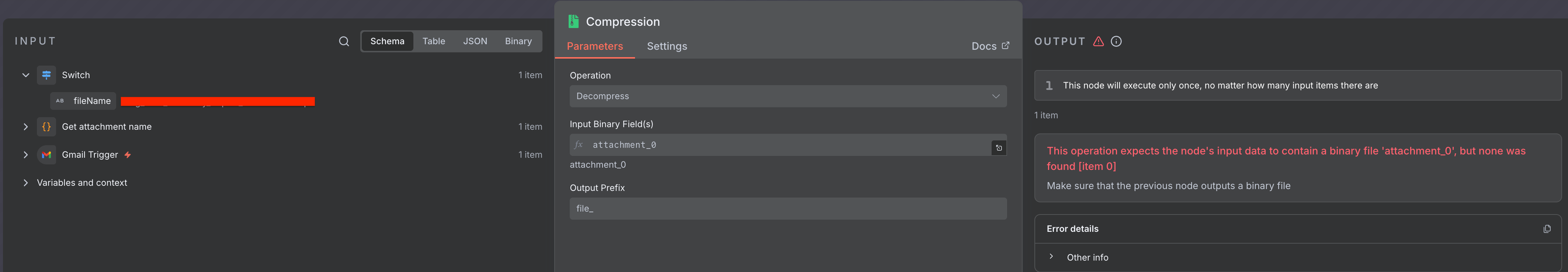

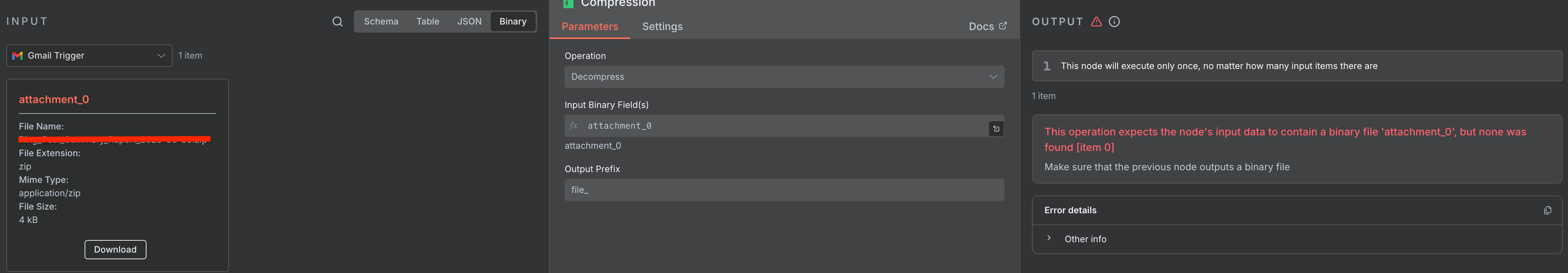

I have ingested an email with an attachment, and after validating it’s the one I need, I want to decompress it. I read some posts and it should be farely easy, but I’m not sure what am I missing.

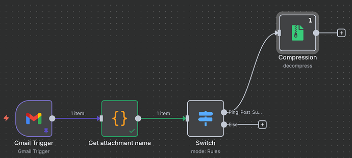

That’s my flow, and the error is:
The only thing to mention is that I have 3 inputs, as per the flow

Hey @diegocatlad hope all is good. Welcome to the community.
The node that attempts to decompress the archive is not directly connected to the source of the binary (the trigger).
You can (choose one):
pass the binary through the code node
merge the switch with the trigger
write and then read the file back if using self-hosted setup
Depending on what the Code node is doing you may not need it, which could simplify things a lot for your case
Thank you, the first one did the trick. Unluckly, these are password-protected files, so it won’t be that easy.
