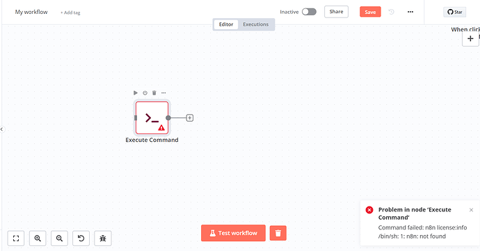

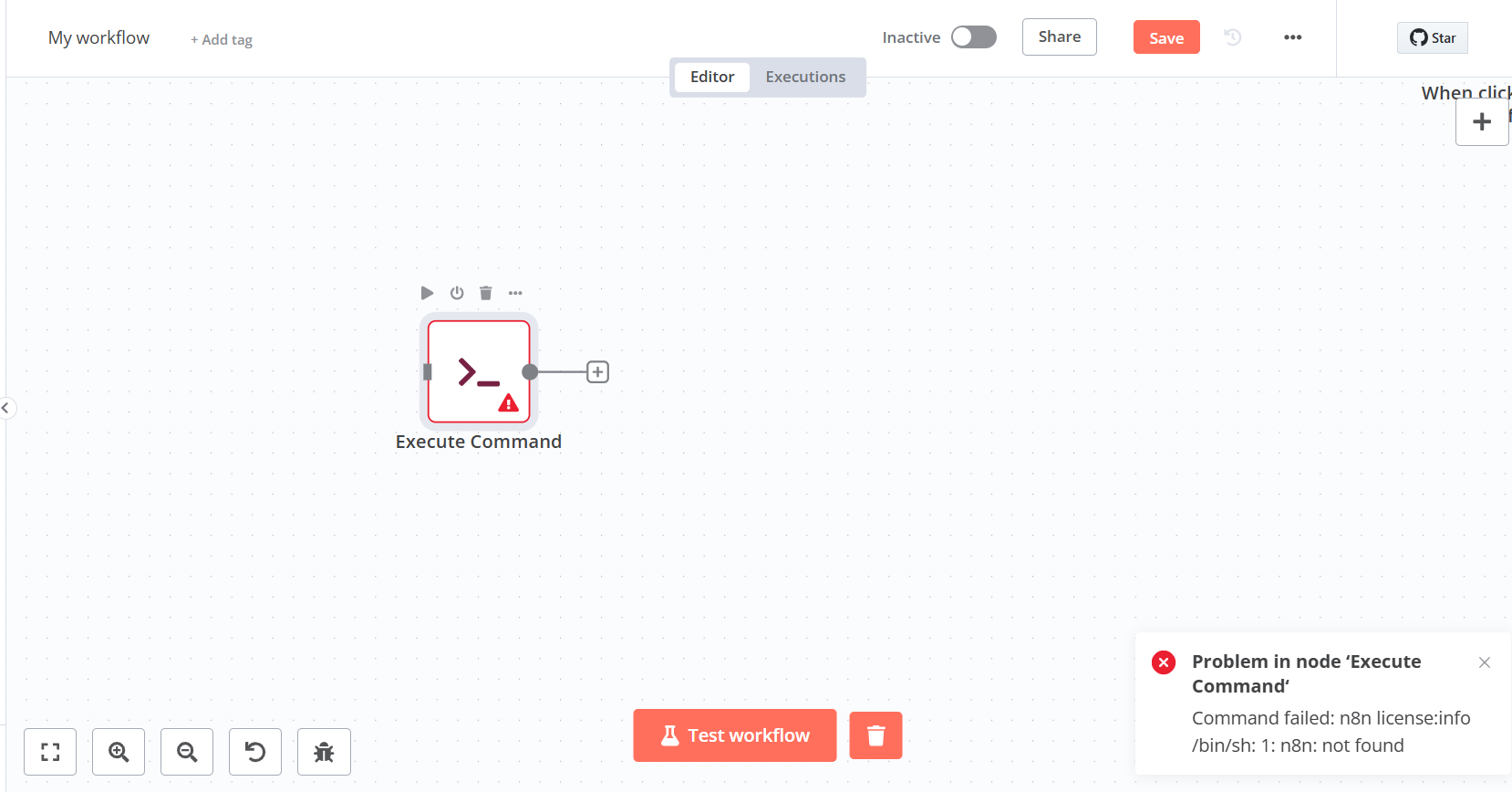

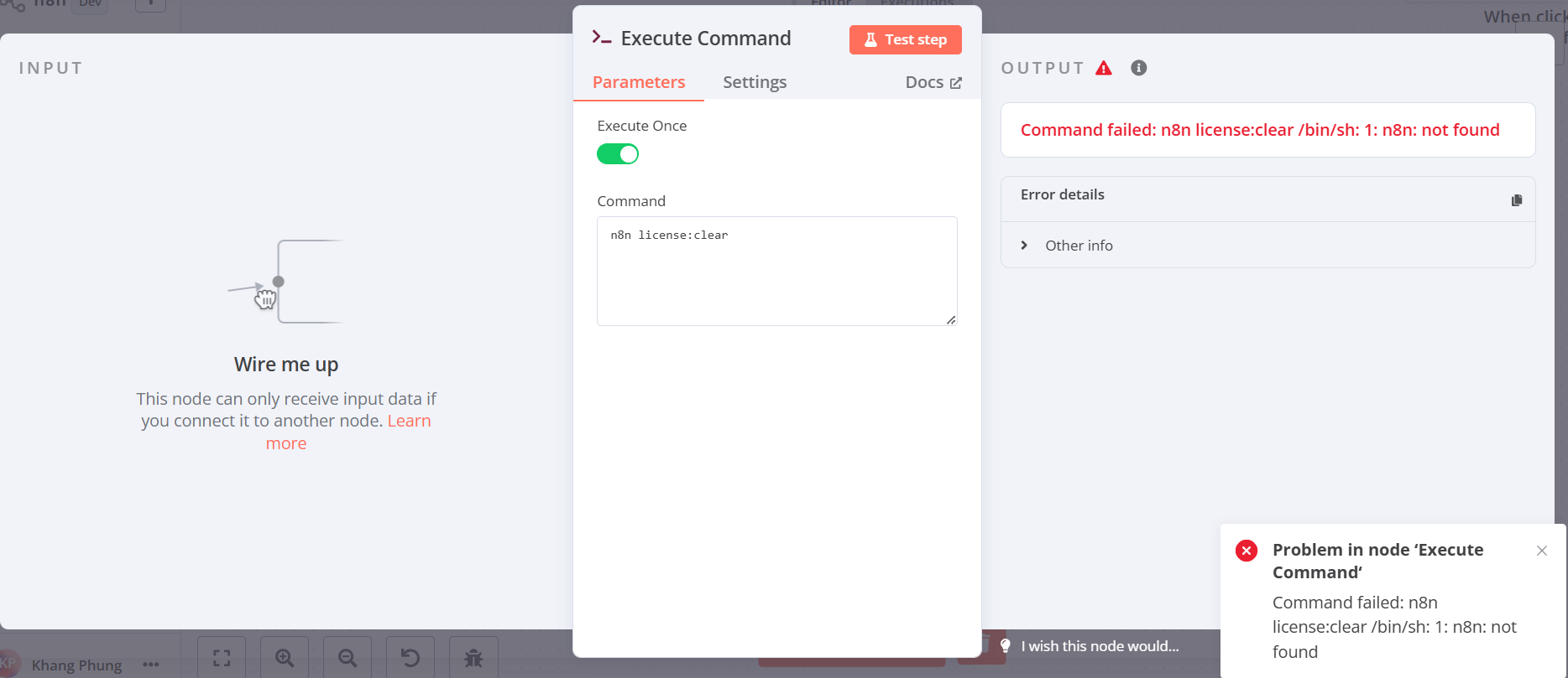

First, I used an Execute node to run n8n license:info. Which failed and lead to error per the image.

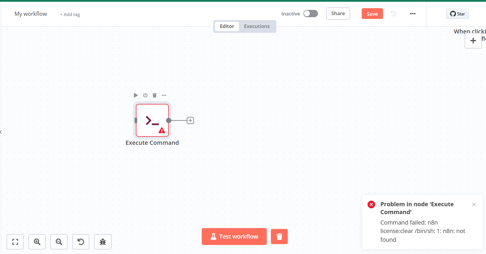

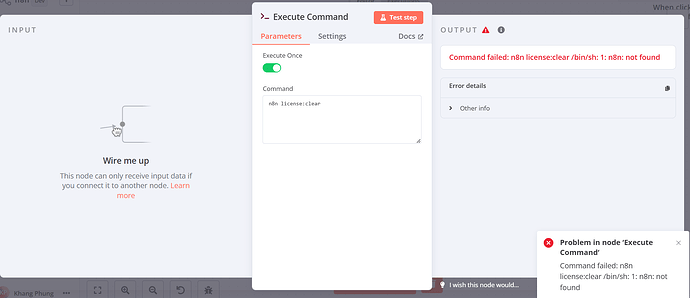

Then, I also tried to run n8n license:clear. Which also failed.

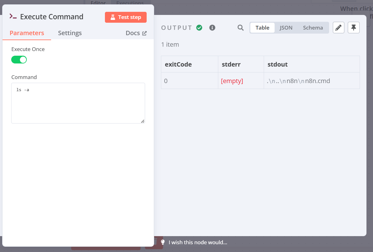

I tried use ls -a command to check the current directory, here is the output. I think there are 2 files: n8n and n8n.cmd

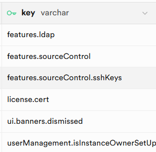

I did mentioned that I used a persistent DB on Supabase for n8n. Does this affect anything? I found out that in the settings table, there is a row named license.cert. Does this related to any of these problem? (I do not think so, the value of this field is ~5000 characters, there are just no way)
