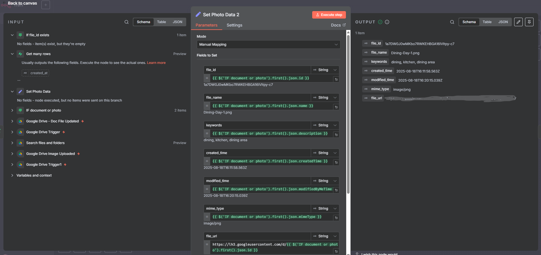

Could you show a screenshot of the execution window for the last execution where you had uploaded multiple items and only see 1 processed?
Do you mean this window?

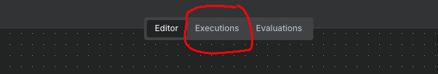

Not exactly.
Show us the execution from this tab:

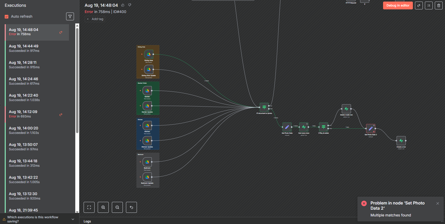

I only see 1 file being caught by the trigger, which is inconsistent with the issue you are describing.
Sorry, I was all over the place with this workflow.
I also had to change the nodes as I can’t figure out on how to trigger a google drive on file update and file create that is inside a sub-folder, I guess my only option was to create a trigger for each sub-node.

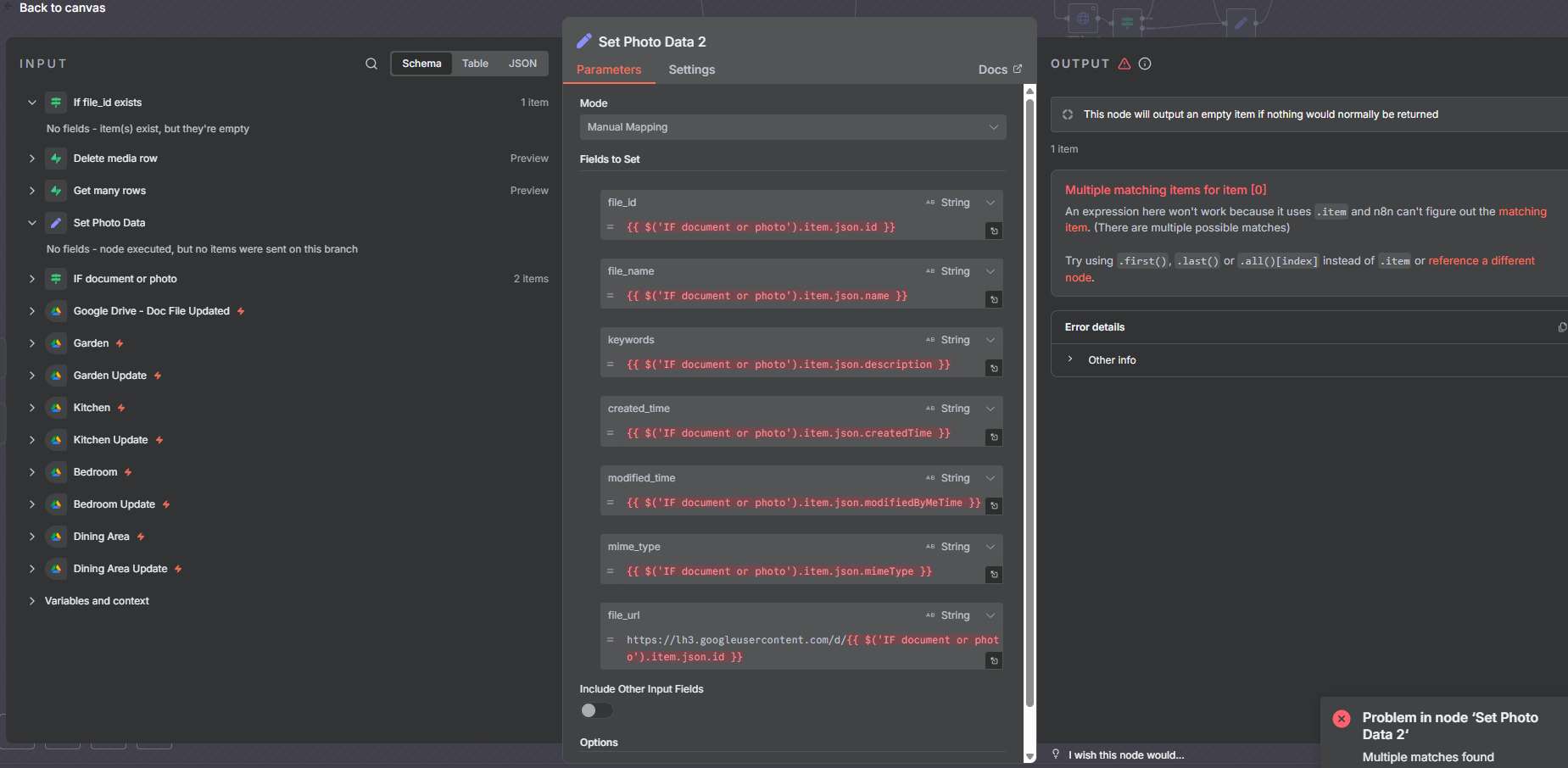

This error happens because you are referencing the output of a node, which contained multiple items. The IF node output 2 items, and in the Set Photo Data you say - grab this value from the output item of the IF node. The error explains that you can choose first or last or one with a specific numerical index, but you cannot reference just some item.
I kind of have an idea about the error, my problem now is whatever I use (.item, .first(), all()[0]), it always only process one item, I’m just guessing that there’s really no way to process all items that was fetched by the trigger node? It just might be how google API is.
