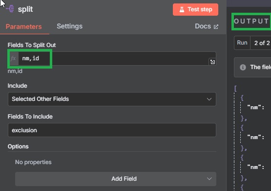

The issue is with the Split Out node, specifically the “Fields to Split Out” setting.
Scenario A below :
When I manually entered id,nm (without quotation marks), it worked.
Scenario B below :
I also had the same string stored as input, containing id,nm (without quotation marks). I then dragged and dropped it into the “Fields To Split Out” field, but the result was:

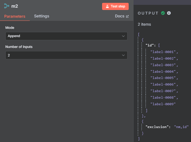

  • m1 ---------> append of arrays of var & exc
  • m2---------->append of arrays from Code & exc
  • splitter------> splitting arrays from m1 and m2.
Output from the last-node:
Output from m2:
Problem in node ‘split‘
Cannot read properties of undefined (reading ‘split’)
TypeError: Cannot read properties of undefined (reading 'split') at ExecuteContext.execute (/usr/local/lib/node_modules/n8n/node_modules/n8n-nodes-base/dist/nodes/Transform/SplitOut/SplitOut.node.js:138:75) at WorkflowExecute.runNode (/usr/local/lib/node_modules/n8n/node_modules/n8n-core/dist/execution-engine/workflow-execute.js:681:50) at /usr/local/lib/node_modules/n8n/node_modules/n8n-core/dist/execution-engine/workflow-execute.js:915:62 at processTicksAndRejections (node:internal/process/task_queues:95:5) at /usr/local/lib/node_modules/n8n/node_modules/n8n-core/dist/execution-engine/workflow-execute.js:1246:20

when you are appending the tables together, one of the tables does not have the field exclusion, and comes up as undefined. Try merging the table outputs instead of appending. Here’s a workflow.
