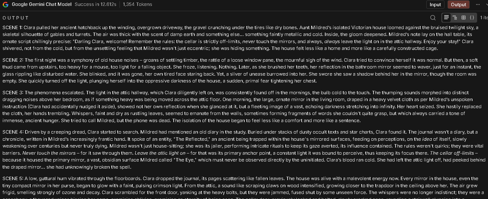

I want to be able to separate each ‘scene’ from my story as a separate item output in n8n. The reason I want to do this is so that I can have each scene act as a prompt to generate AI images.
I have tried some stuff, but I’m new so I don’t understand how to do it properly.
This is the output from Google Gemini. As you can see, I want each scene to be outputed as a separate item.

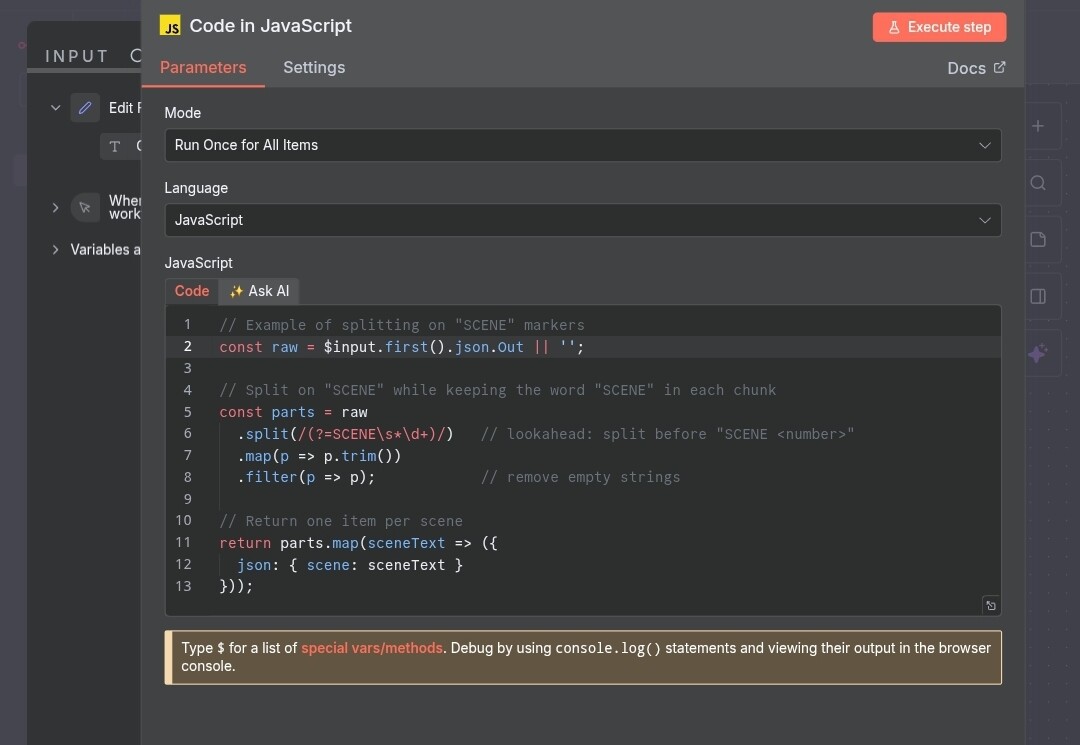

Ok, so your “output” from ai agent node (in my case I set “Out” instead output).
I would use a Code node in order to “break up” the text you get as response:

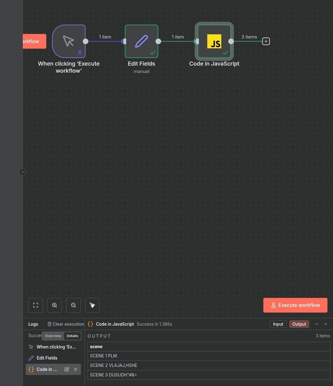

An as you can see in logs :
I had a text with multiple “SCENE” words in that output, and at the end I see 3 items.
Or as @fahmiiireza suggested as well!
Cheers!
