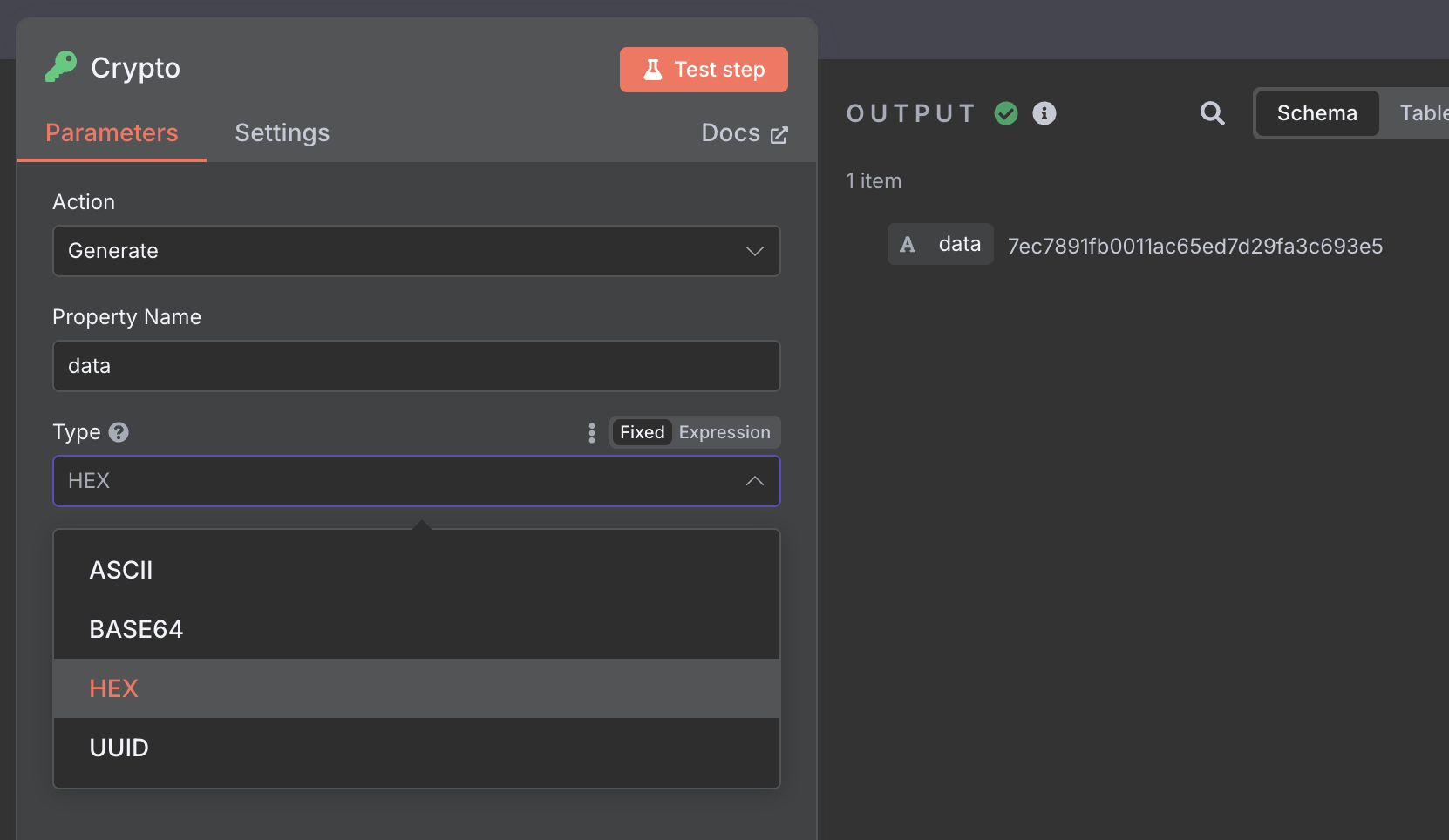

It looks like you’re trying to generate a new UUID and I dont believe $uuid() is a valid built-in function, so it’s best to use the crypto node like this:

It’s a node for basic cryptography. You can use it to generate random string using one of the options. You can click the “Docs” button at the top right to get to the documentation, but best is to just play around with it. For example you could also just generate a fixed length random alpha numeric string using the Hex type:
