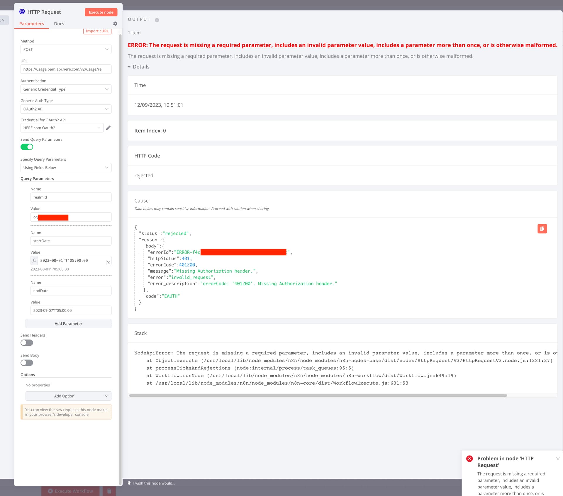

Assuming I use the HTTP Request node, could anyone advise how I could determine my usage ‘by my organization’ through the HERE.com Usage API. The documents are at here but for the life of me I cant seem to get it to work.
You are filling in a query parameter, this isn’t the same as the URL you are sending.
what you get with this what you have now is this: /usage?realms:orgXXXX
In respect of Oauth2 n8n requires both a ‘Authorization URL’ and a ‘Access Token URL’. Which of these would be ‘https://account.api.here.com/oauth2/token’ provided by HERE.com? And then, what is the other URL they are requesting? The only details HERE.com provide for Oauth2 are User ID, Client ID, Access Key ID, Access Key Secret, and Token Endpoint URL.
I’m losing the will to live on this one @MutedJam can your genius provide any insight on this?
The main thing I cant understand now is why the HERE.com service is stating the ‘client id’ and ‘client secret’ fields are missing even though they are specified in the OAuth2 API.
See all relevant screenshots.
Any help would be greatly appreciated.
PS I’ve tried both GET and POST but I doubt this is the issue as it returns the same response code.
Your authentication steps arent completed I guess.
Had a quick look at their docs, it doesn’t look like “normal” Oauth2. So it would need some messing arround to get it to work, might not be as easy as adding the credentials as Oauth2 in n8n. You might need to do it manually. Not sure though.
Thanks @BramKn. So when you say ‘manually’ do you mean outside of n8n or is there some kind of manual node available in n8n to do more complicated workarounds?
