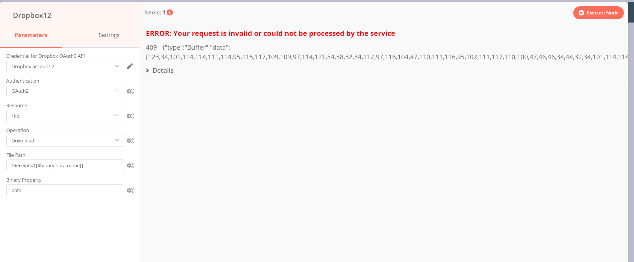

Hi,it almost works but now i get a buffer error.I tried reducing the number of receipts to three but that doesn’t seem to help to.
Did you check out the link I did share above? Because the parameter is still not an expression. It can be set to an expression by clicking on the cog icon on the right side of the parameter and then selecting the appropriate option.
Thank You.It finally works.
