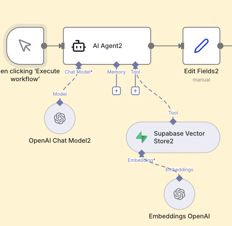

I want to know what data the Supabase Vector Store (used in the AI Agent’s sub-node) is referencing.
How can I access the output from the Supabase Vector Store?

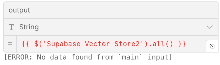

[ ERROR ]

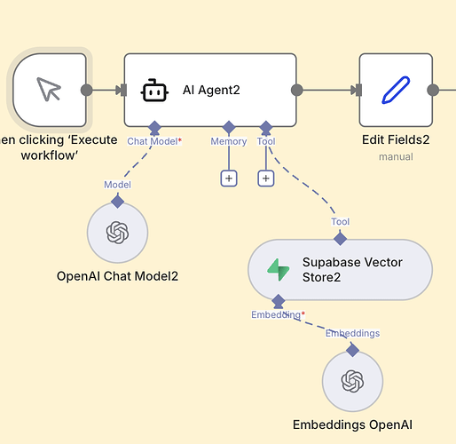

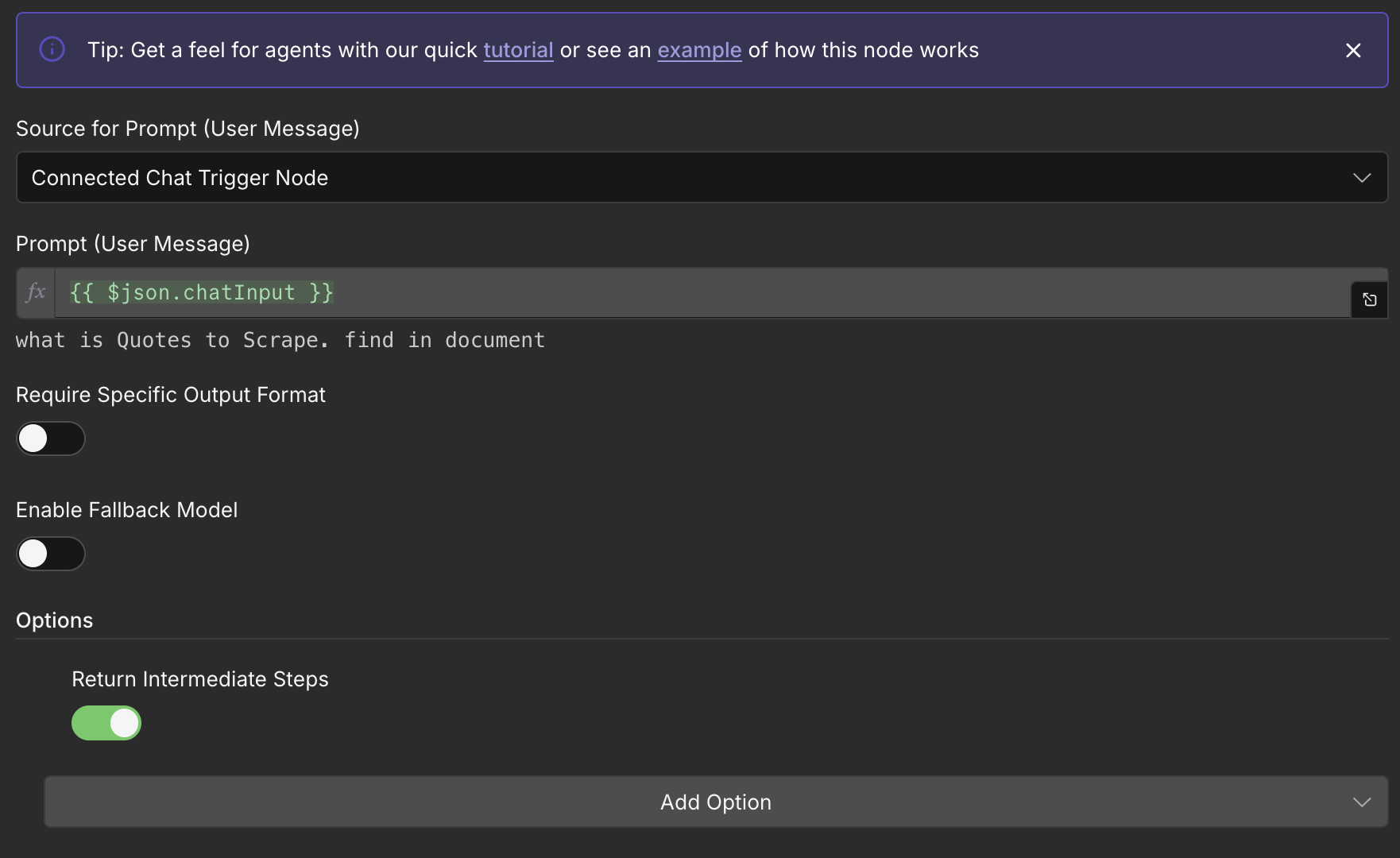

You can toggle on the Return Intermediate Steps in the AI Agent Node.
Then in the output

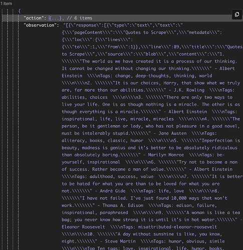

There is a field call intermediateSteps > observation
Should be the information you are looking for.
