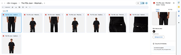

Thankyou for the welcome! excited to learn about the space. Ill attach a picture of the structure, the current names of the images are all unrelated to the images themselves however they are generally in the correct order to be renamed, so picture 1 will need _front added, picture 2 needs _front2 added, Picture 3 needs _side added etc, Picture 4 needs _back added, picture 5 needs _detail added, Picture 6 needs _full added. Added meaning “_full” being added to the name pulled from the folder name if that makes sense.

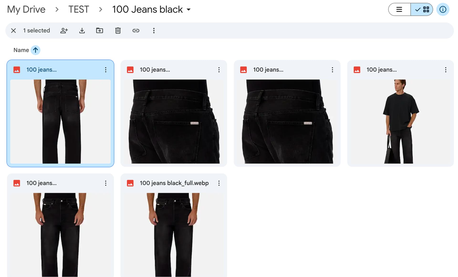

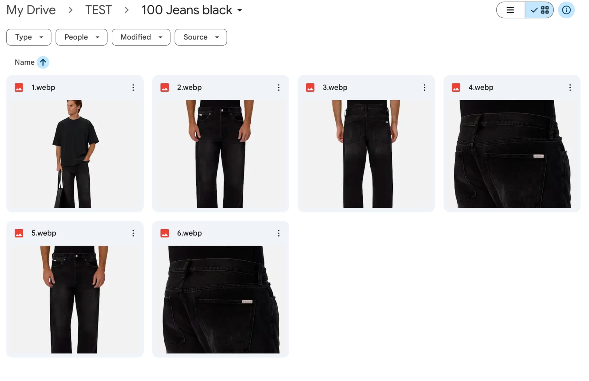

ive added what before naming looks like and after ive manually renamed them

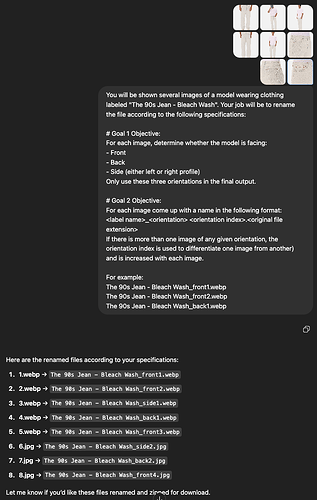

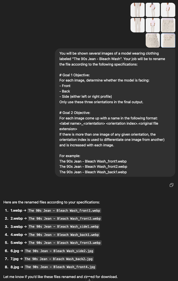

To add to the previous message, using openai should do a decent job with identifying the orientation:
