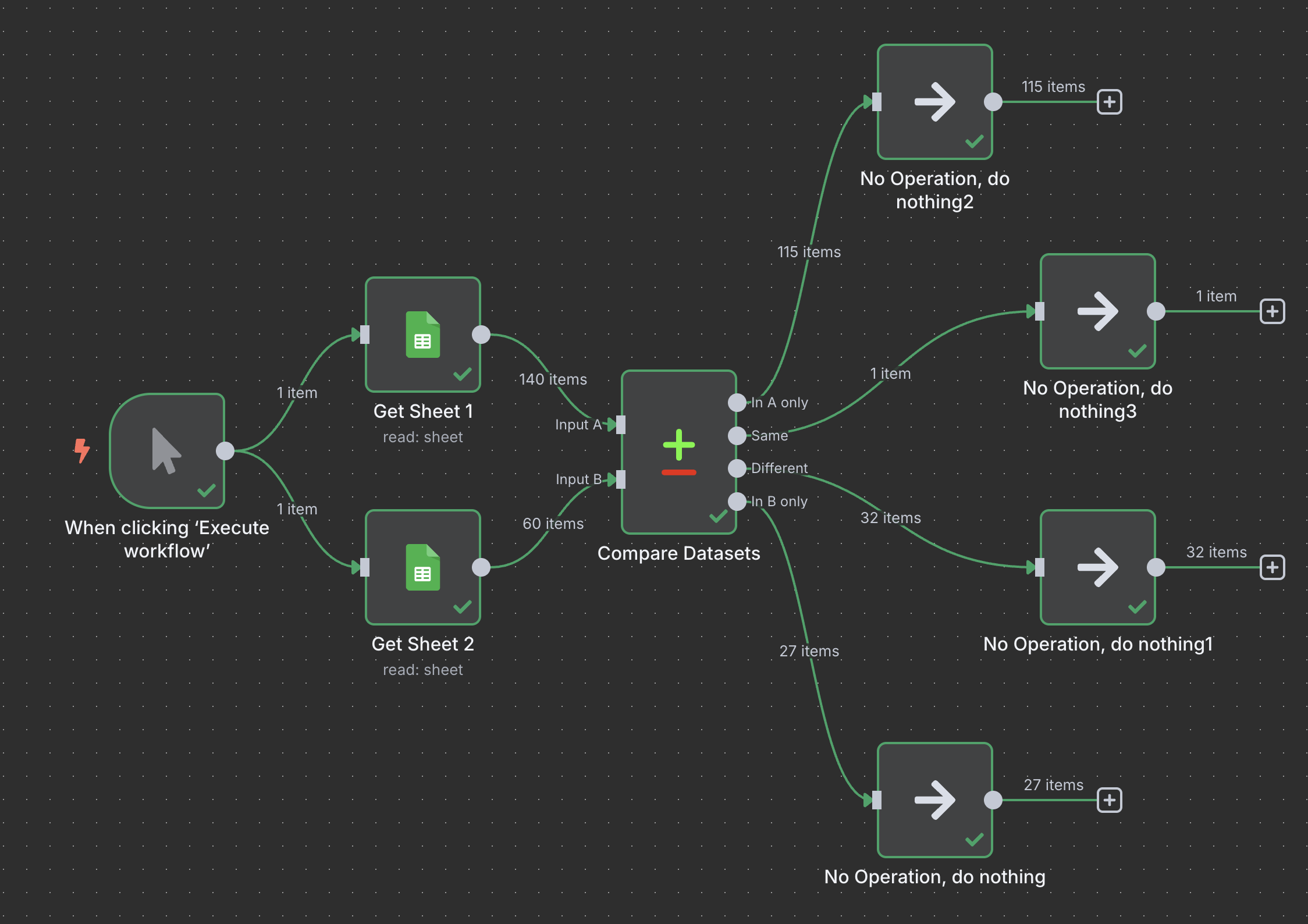

How can I compare two Excel sheets, each with around 200 rows, to identify discrepancies?
In my use case, the AI agent is not parsing all the data correctly and is returning either incomplete or incorrect output. How can I resolve this issue?"

Would you like to expand on your question, and provide any details? Like an example of two documents to compare, what is incorrect output, how you are using the AI Agent?..
Try to embed your workflow for us to take a look at.
the balances are not accurate and some vendors do not show in the list.

This is the workflow I used:
Here is the output html I got:
How close is this to what you were looking for?

Thank you for your reply. This node seems to retrieve all the data; however, I want to generate a unified report that highlights all the discrepancies using the AI agent.
Can you explain the logic for finding discrepancies? Show one example of each of
in the data you shared for transaction and balance sheets above.
