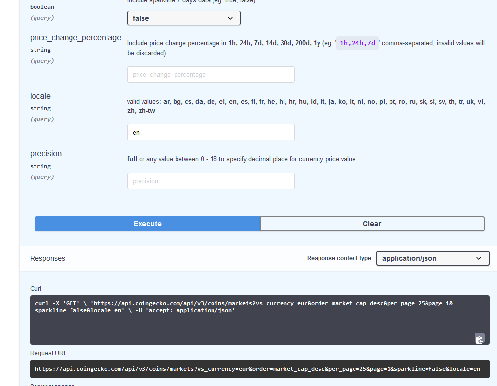

I mean this part:

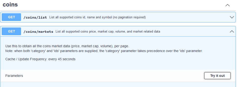

If you’re not very familiar with APIs, you can simply visit the link above to the Api documentation.
Select the Query you’re interested in
Click on “try it out”
Edit the query fields as documented
“Execute”
Copy the “Request URL” to your HTTP Request node.

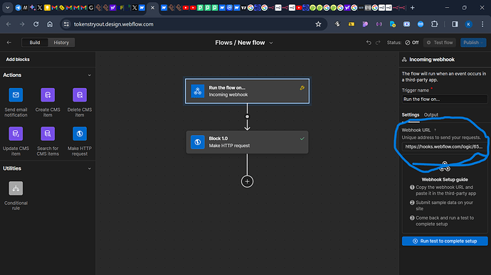

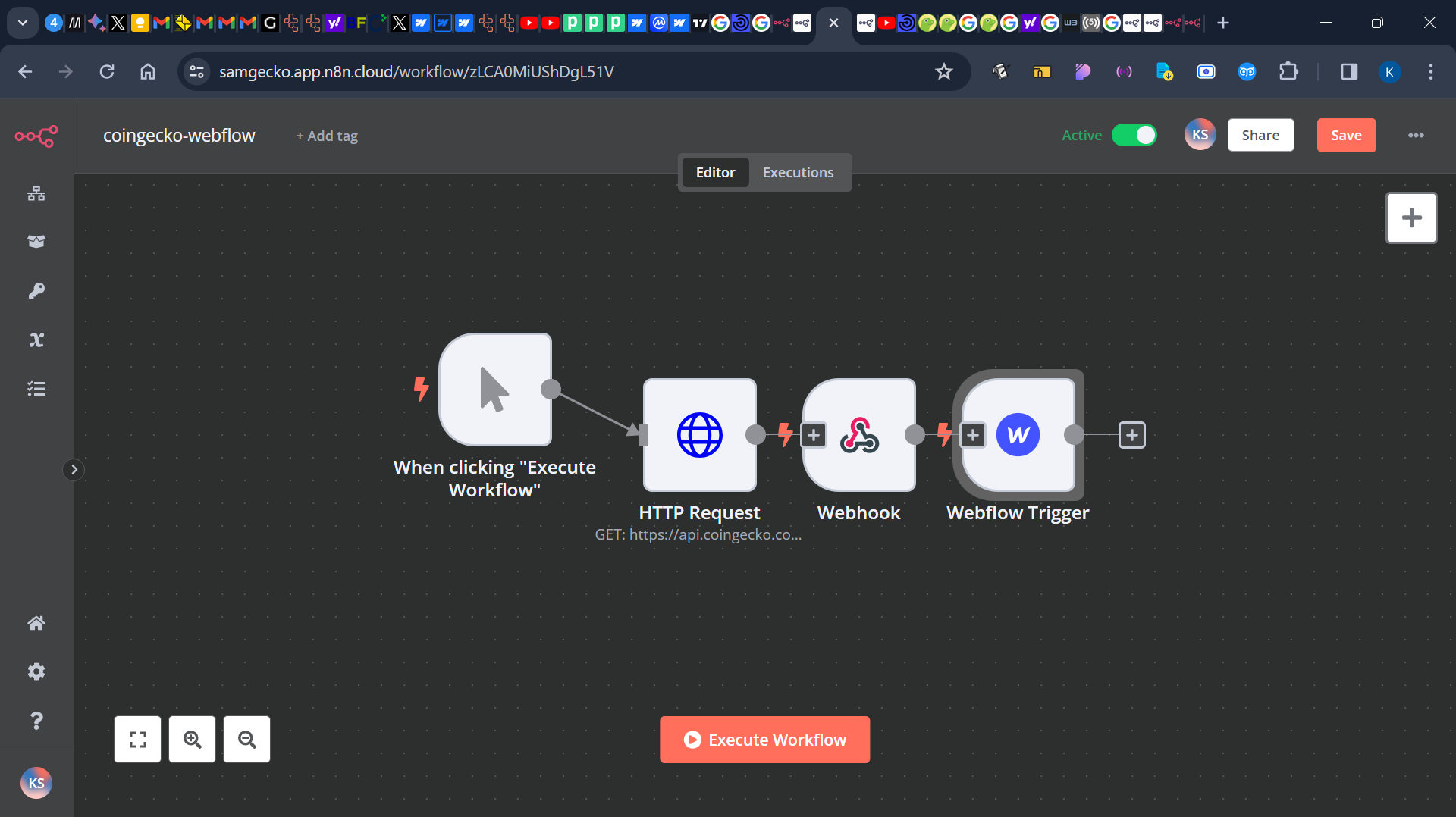

I now understand how to make http request but I still don’t understand how I can connect the workflow in n8n to the workflow in webflow that will update a cms item.
That’s the part I don’t understand now
