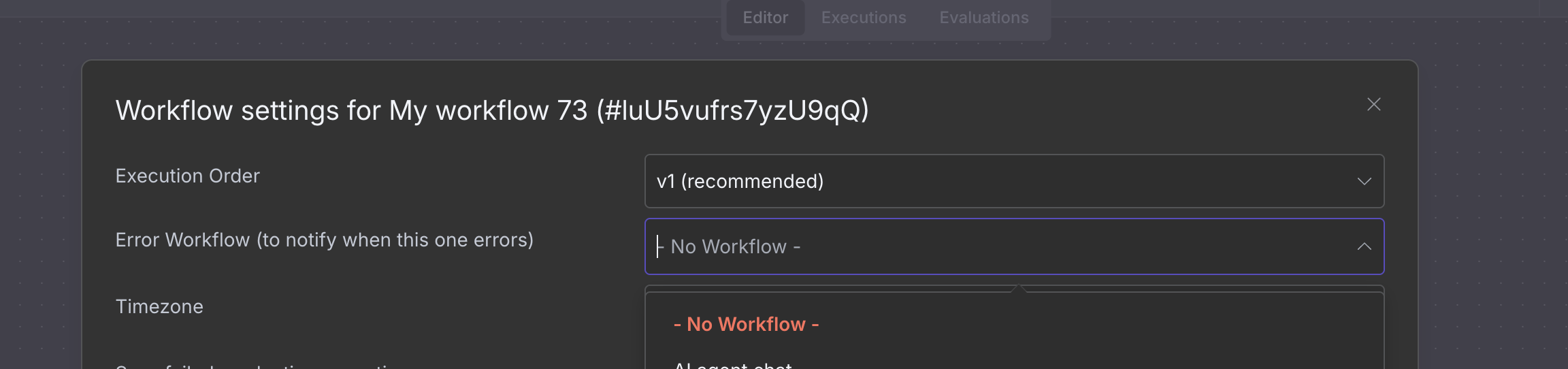

and for every workflow that you want to track if theres any error, you need to go to the setting of the workflow and then on the on Error Workflow, choose the workflow that you just made, like the one above
